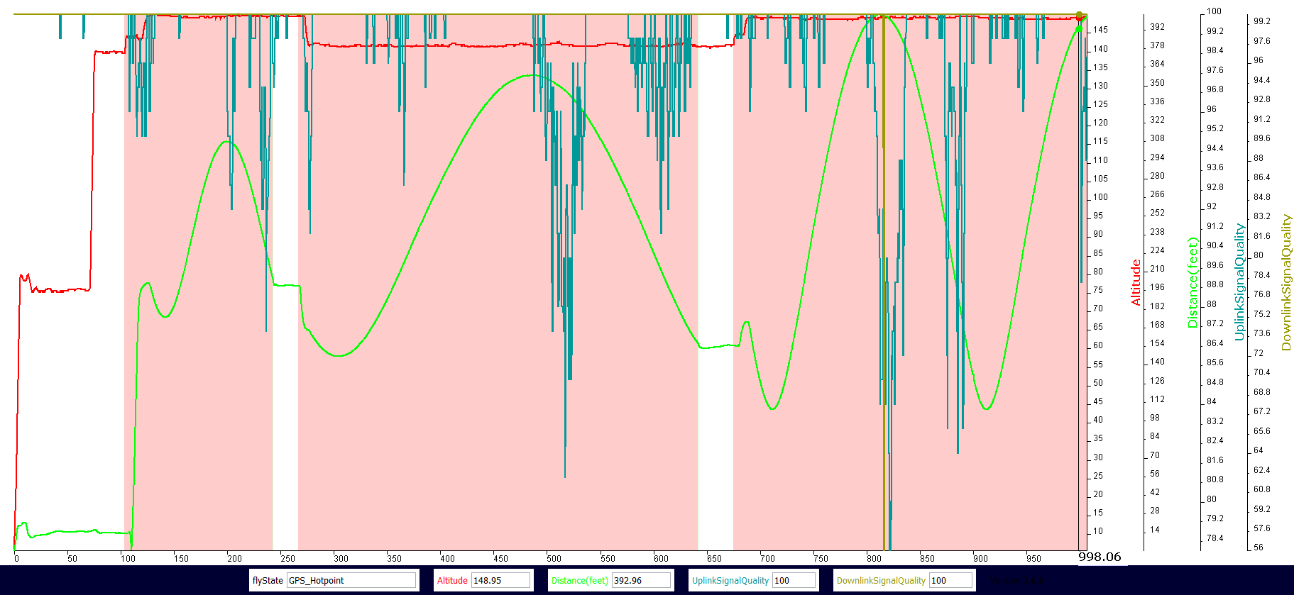

Not having any luck with DJI Assistant...it connects to my p4p but after 5 mins or so it says "Failed to get log list"! I've tried 3 different cables and reinstalled dji assistant with no luck. Will try on a PC Thursday.
In the meantime here is a link to the Litchi flight on Airdata...I can't see anything obvious??

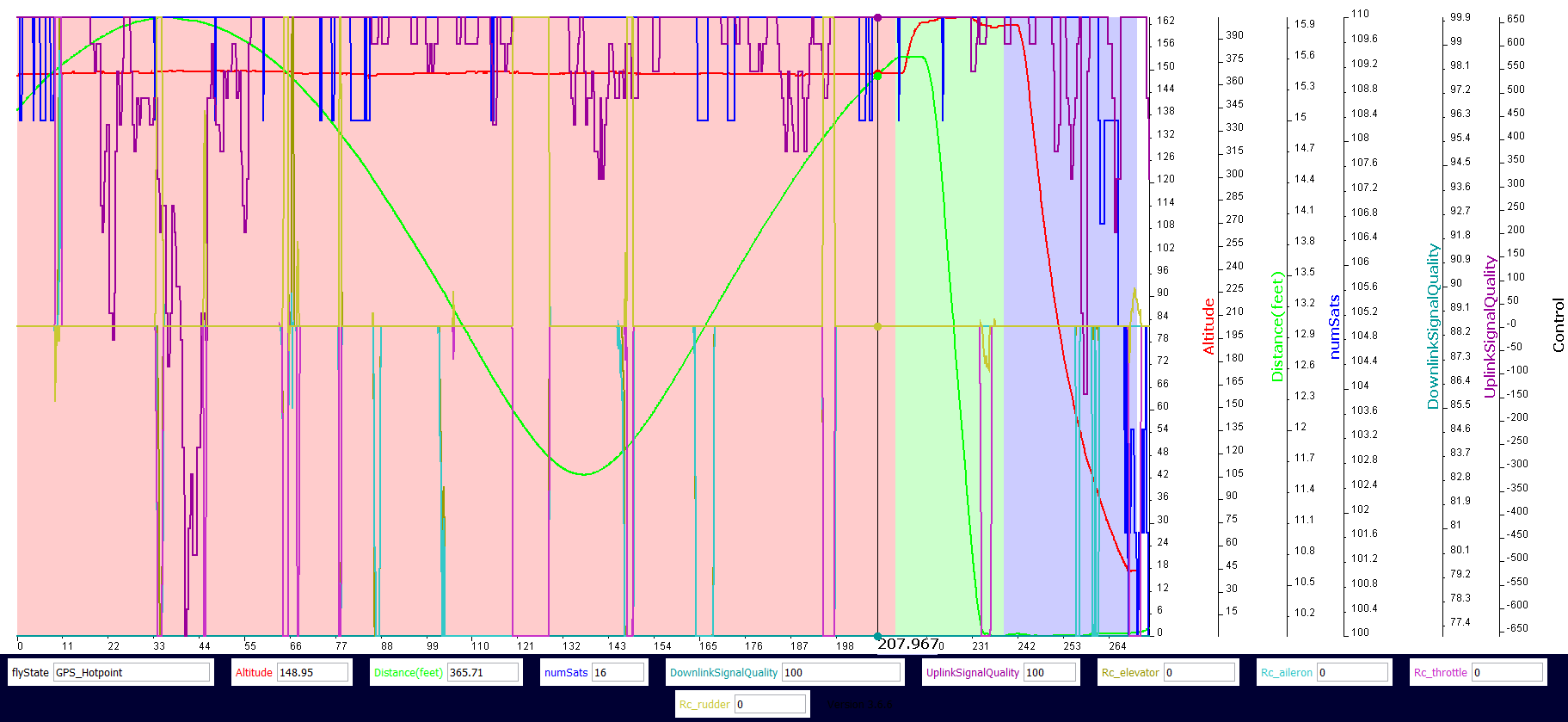

Ahh, the other flight is showing errors but on the log is says 2:45pm about the time I completed the 1st two video flights, the log I sent before says 3:04pm around the time I was having no control...Heres the link, thanks again
@T Dogg ....Same story with this flight, until signal loss. The only way to know what happened after that is to view the .dat. Everything looks fine here, best I can see.

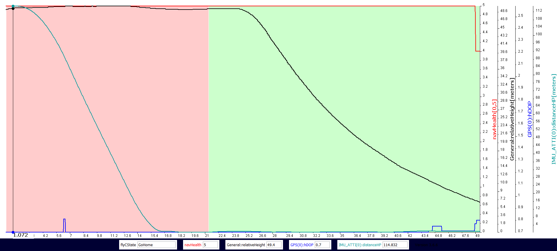

Heres the link with the latest DAT files...
Will get to them when I can. It takes longer to download than to analyze at times.
Reactions: T Dogg

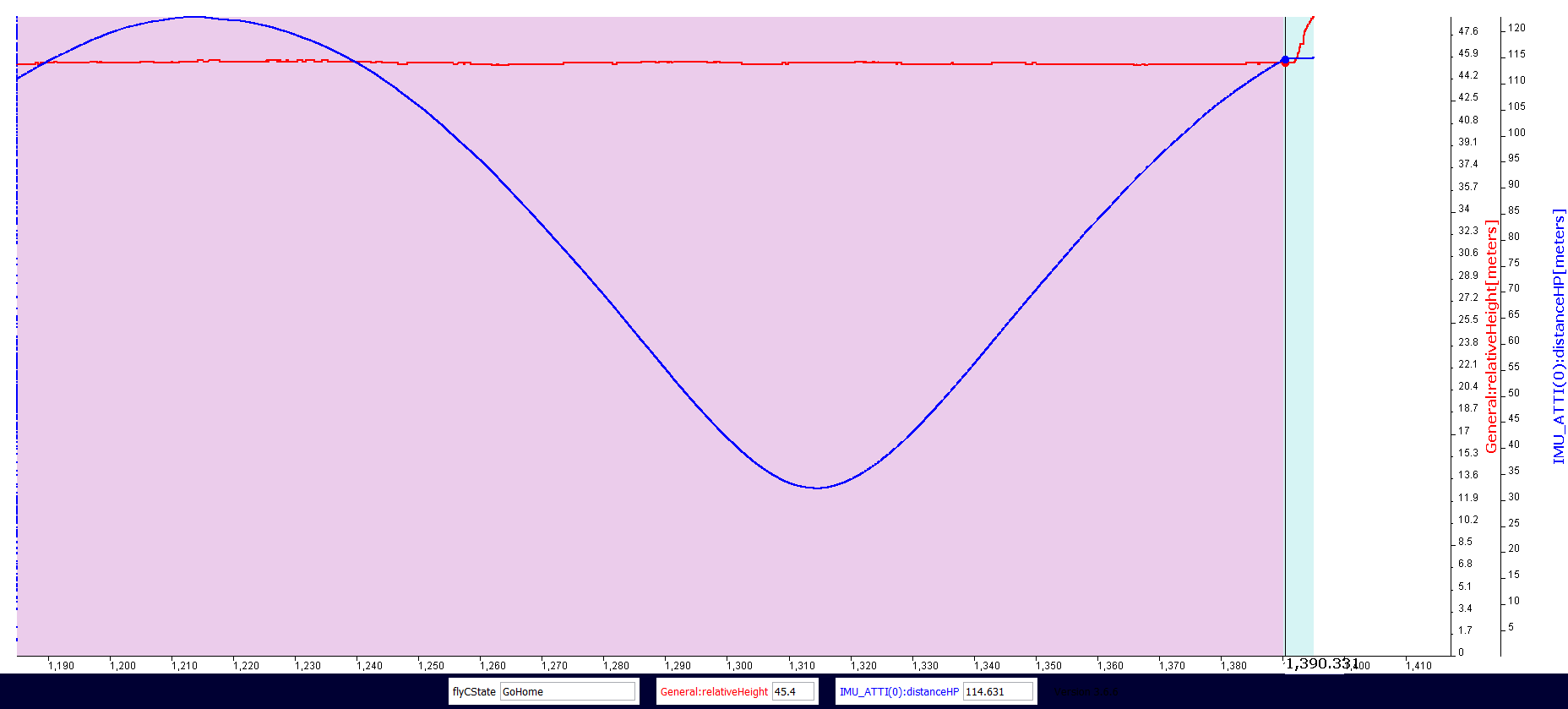

@T Dogg This flight from FLY292 is the same from your Airdata in Post#26. The flight looks perfectly normal, until you initiated RTH @~1390 Seconds. 4 seconds later the data stops. It is possible that the on board memory became full and another DAT was started. Unless there was another issue that is not apparent here, unfortunately. See if you have a FLY293 DAT. If not, or if that one is not relavent to this flight. Then there was some sort of anomoly after you initiated RTH. There are no errors at all.
Reactions: T Dogg
Thanks again @Fly Dawg, well good to here there are no errors or maybe better if it showed the reason for the anomaly after I initiated the RTH. So I'm guessing Litchi may have had a glitch that stopped the drone returning if there are no errors on the drone?
I will check for FLY293 file when I get home but I'm fairly sure the files I uploaded to Google Drive were all that I had from that day, November the 3rd. I will get back to you later on...
I neglected to go back and check your uploads. FLY293 is there and indeed it appears that it is a continuation of the flight. Again here there are absolutely no signs of any issue's. The aircraft returned to home normally as it should have. The flight you are attempting to describe must be another file. It is not one of these.
