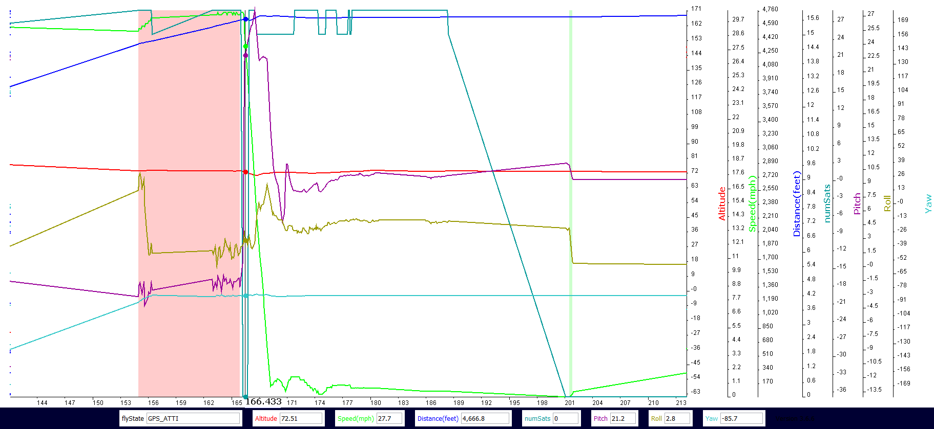

I begin trying up stick, RTH. Connection comes in and out. Viewing the data I see the aircraft went crazy and left the flight plan veering 100 ft toward an electric utility transfer facility, At the 4:00 mark it goes into Auto Landing.
You had many issues far before that. I can tell you why the mission ended. At ~166 seconds your sat count went to zero. The mission will end there. You had in and out control for most of the remaining time, although the sat counts never returned after ~190 seconds, thusly putting the aircraft in ATTI mode.

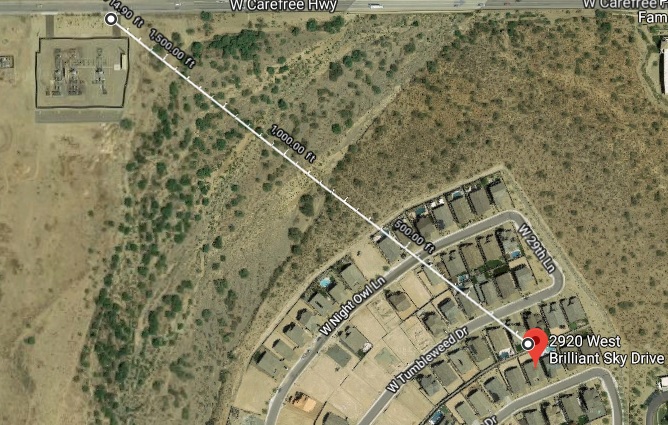

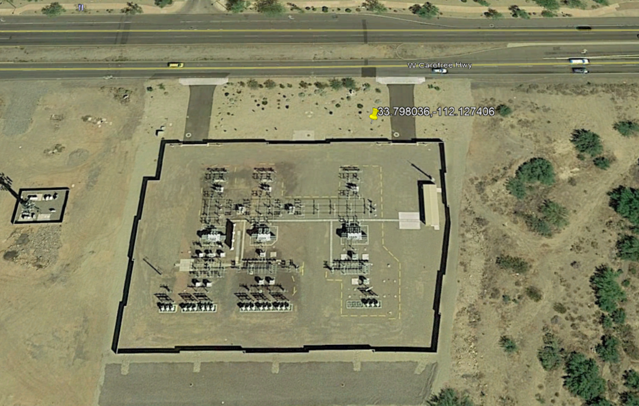

Your last position was here and probably already on the ground. Awfully close to that power sub-station.
Using Street view, looks like you would need a ladder or another bird to see if it is behind the wall, if it is you already got your personal information on it. :oops:

Did not use screen recorder. Searched area and over wall with P4 at sub-station. Nada.

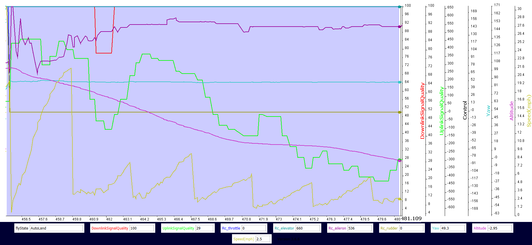

Looking at the last 30 seconds or so of data, you were issuing elevator and aileron, and traveling ( apparently ) in a northeasterly direction before the data ends. It is possible that the altitude was off and you continued in to the road. You probably didn't get much farther than that.
Any idea why satellite count would suddenly go from 16 to zero? Do you think I might have saved it if I went to sport mode?
No. Loss of GPS results in ATTI automatically. There is no positioning in ATTI Mode. Only the barometer for altitude hold and VPS. That's it. Everything else is manual.

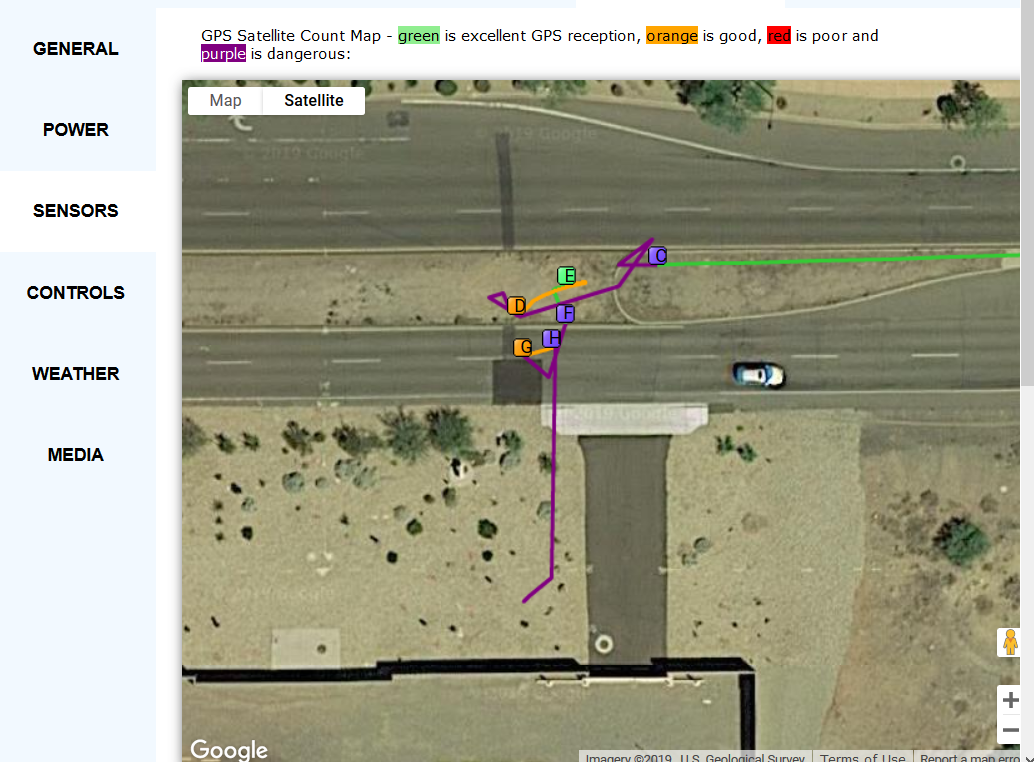

How could be the path plotted on the map if all satellites had gone?
You need to look a bit closer. They dropped out near the end of the flight path. It is possible that the FC was recieving the positioning data but very erratically. Unfortunately, Litchi's data files are very limited in comparison.
