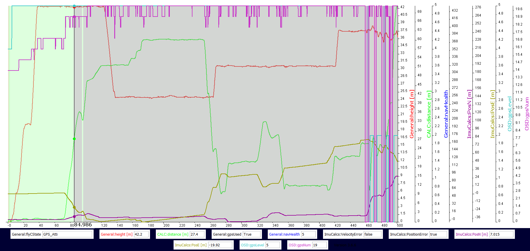

After reviewing my flight records. My error in judgment came from not checking the change in wind speed.
Here is Phanton help flight URL from uploaded flight data.

Looking at your data, at 3:57, the drone is hovering at 80 feet without any joystick input but it's having to actively fly at 0-0.7 mph to maintain its position, which indicates a significant wind at that height.
The roll data also shows the drone leaning into the wind to fight against it.
At 7:38.9 there is an unexplained drop in GPS satellites from 20-zero, which leaves the drone in atti mode without horizontal position holding for 5 seconds.
When GPS sats appear to come back to normal, the GPS Level stays at zero indicating the flight controller does not have confidence in the GPS position data.
GPS continues to drop in and out but GPS level stays at zero and the drone is in Atti Mode for much of the flight and controllable but subject to being blown around and it has no "brakes".
Throughout the flight there are numerous warning messages saying:
GPS data error. Please contact DJI Support.​
GPS disconnected.​
Satellite Positioning Off. Fly with caution​
There is a hardware fault with the GPS receiver.
The drone never attempted to "fly away" and was controllable at all times.
Try a test flight in calm conditions and if it is still there it will require fixing.
Maybe it's just a loose connection (?) or perhaps it's more serious than that.

Wow, That's Extremely Detailed and very accurate as to what was happening after loss of GPS. Drone has been Packed away until I can test in Calm conditions. This drone is only 1 week old. So maybe a good Idea to contact DJI Support with this Data? OR will it be incriminating.
Appreciate your very Knowlegable response to this Event. Thank you. Meta4.
Reactions: Meta4
You obviously handles it well to manage it on that flight.
A simple test flight in calm conditions should be no problem and would indicate whether it was a one-off or a real issue.
I can't see anything incriminating in the data.
It could only further support a case for repair if that's needed.
I just tested takeoff and landing only 3 times and GPS was working well. Is it something I should still take up with DJI ?
Since it took 7 minutes to fail in the flight above, I'd be hesitant to give it a pass until it proves it can do a whole battery.
You’re absolutely right. My initial test was just to check systems and launch and land. Wind started to pick up. So next time I’ll do a full flight plan and really test out a full battery. Just to see if GPS errors occur again in a safe environment.

I guess it's either just a loose GPS connection or an intermittently bad receiver, with the loose connection probably the most likely.
Reactions: RodPad

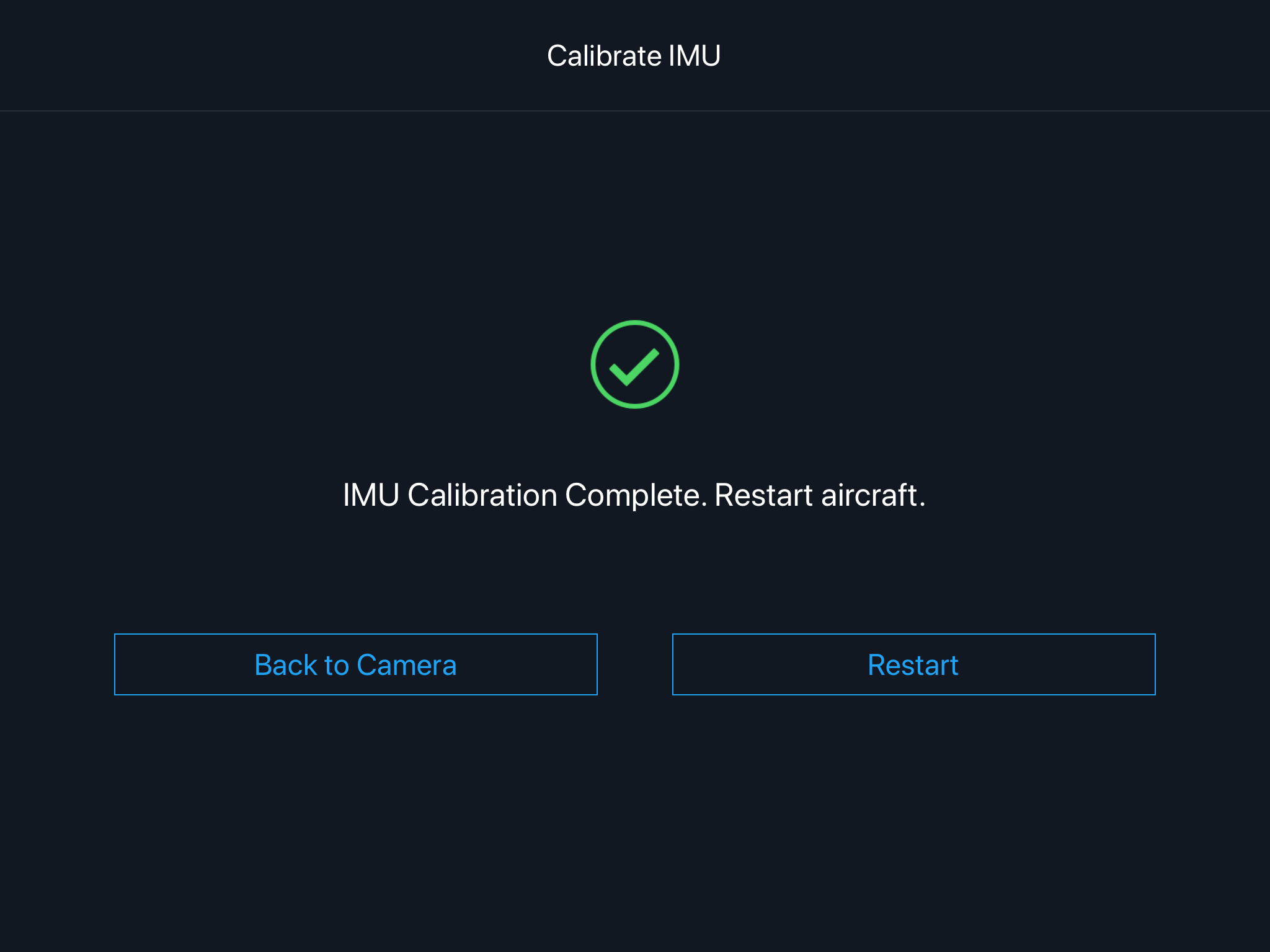

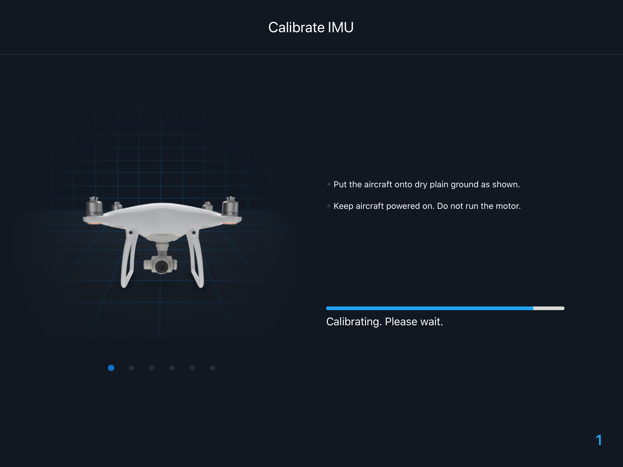

@ozboyblu ..This could indeed be hardware or wiring related. However, the data indicates @~85 seconds in to the flight, the IMU indicated a positioning error which remained for the entire flight. That could be the root of the issue. If that is the case, an IMU and compass re-cal could be all you need to clear that. Only a suggestion for something you can try.
That’s great information. Thank you for this. I’ll be sure to recalibrate IMU and compass before I test again in calm conditions. Hopefully the GPS error is a once off. If it occurs again most likely will be hardware related. Eg a loose connection or 3 in 1 board.

I have recalibrated the IMU and Compass. Will fly again when calm conditions are available to test for GPS errors.
