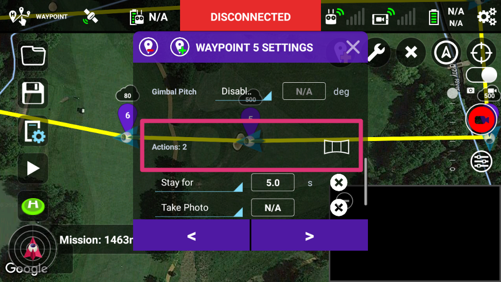

This is what I do... I personally create a mission then for the pic I select the the panorama (pictured in red box on my pic)
Then just as I launch it I adjust the camera to point down at a certain angle and leave it at that.
You can programme it to take panorama with the camera pointed up or down at a certain angle but I never play with that. View attachment 77348

Today I tried to do this, but theres a limit to only one row and I need the complete panorama (3 rows of 6 to 8 pics each and 2 nadir pics), however I tried but I started recording video from the beginning, so this waypoint route did not take any pictures because of that ;(
