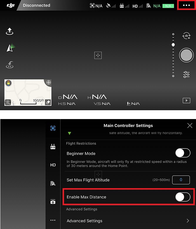

Assuming you don't have the go app limited distance and height issue (logged into your account), in your main controller settings, be sure not to have your maximum flight distance slider enabled. If so, switch it off and you should only be limited by your control signal.

If the "Enable Max Distance" setting (see the screenshot below) is not enabled in DJI GO, then check out this post.
