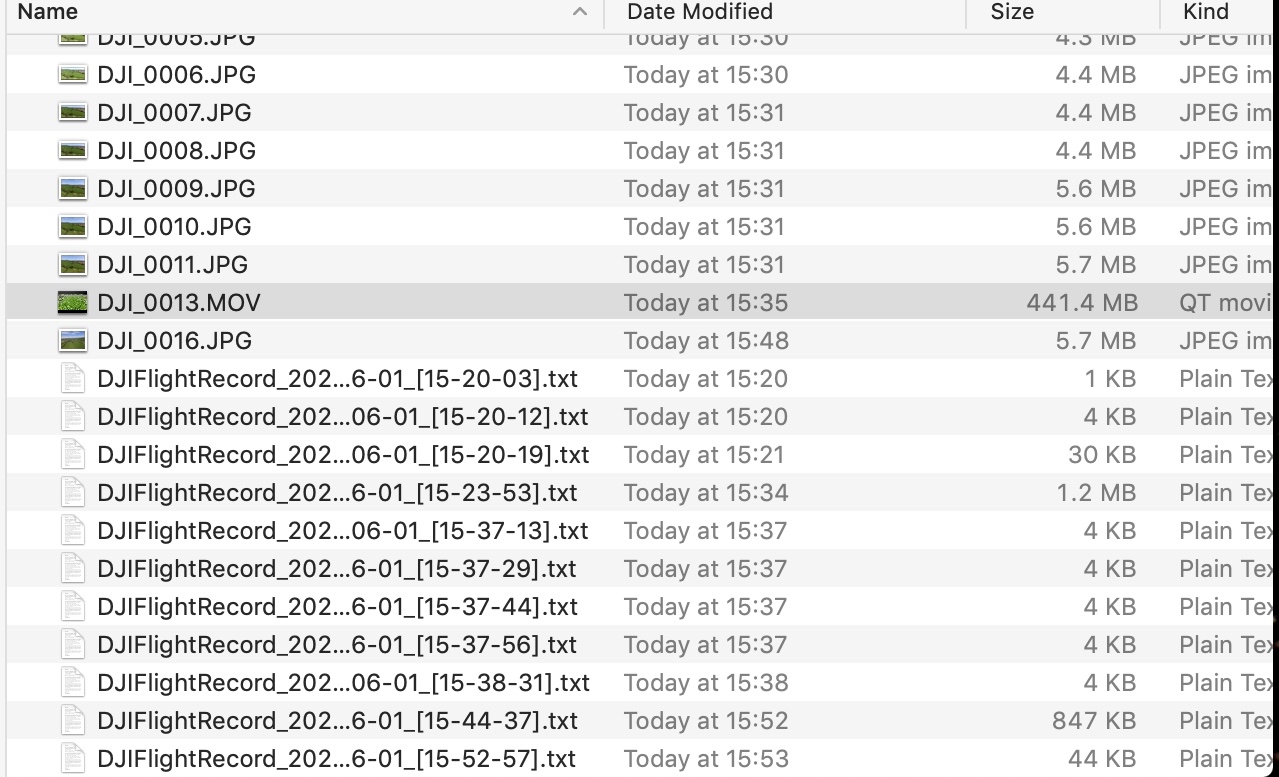

I'm trying to find the .txt file to see if it can give me a clue but can't find it?
Here are the files....im looking for DJI_0013 .txt.

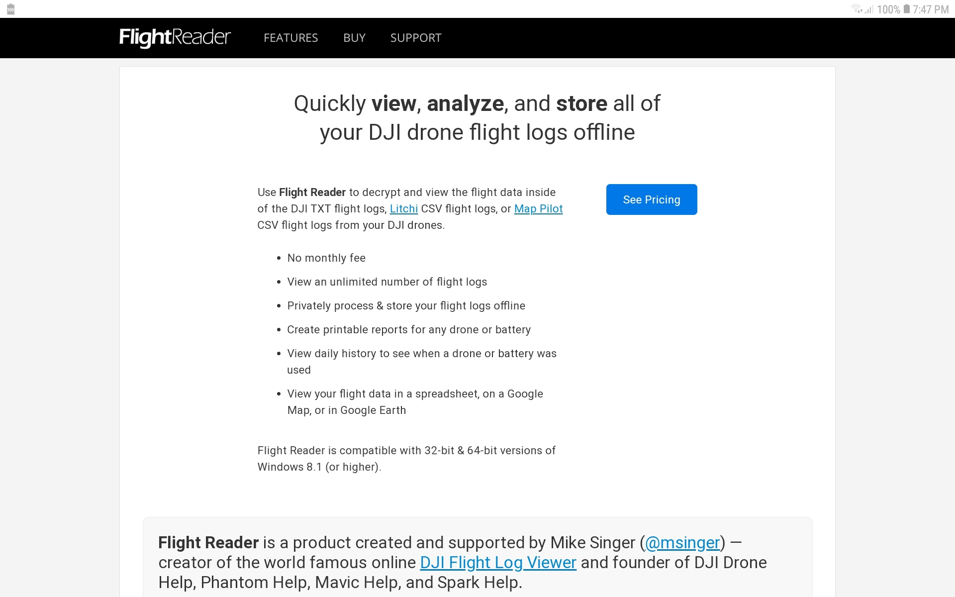

There is this one aswell,says unlimited and from Mike also

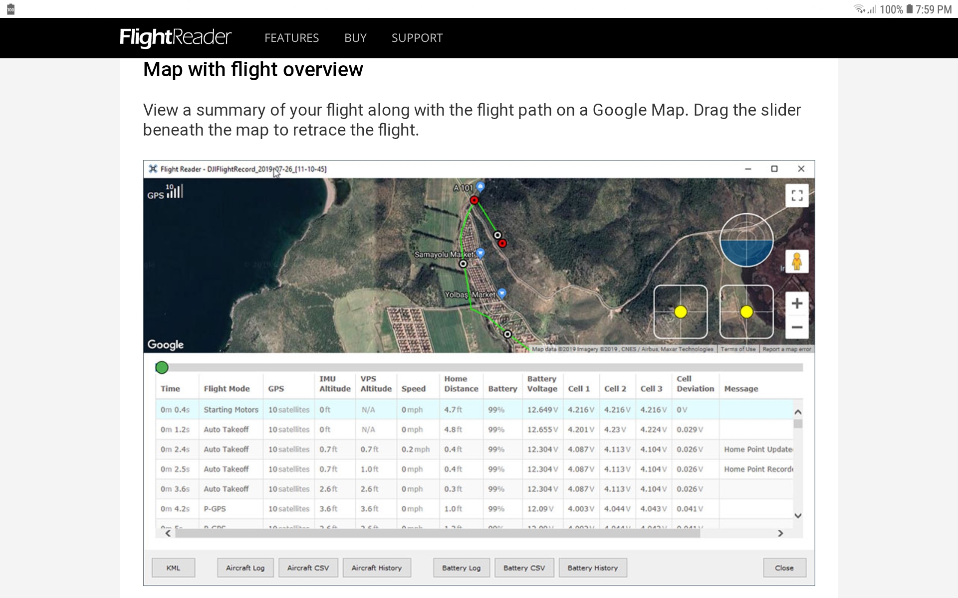

Came up with Google search called Flight Reader
Has this sort of info
Thanks ianzone, I saw this but it costs a minimum of $99 which as a UK pensioner I don't have to spend on recreational stuff ??

You don't know which flight it was?
If you do, post the .txt file and I can look at it.
It was one of the short, about 2 minute flights so probably this one.
Paste and go, this is the file.

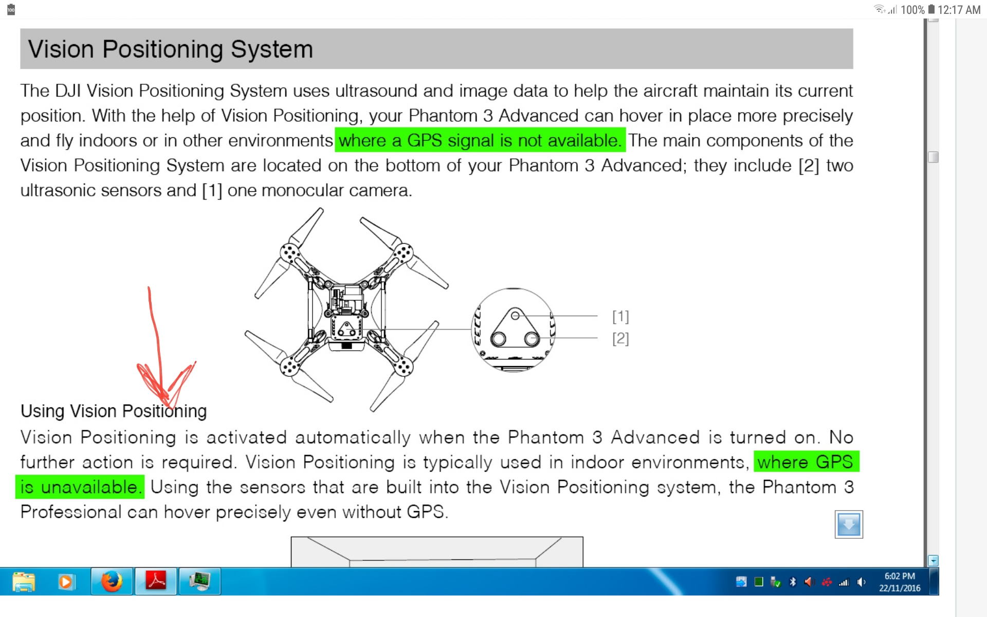

So doesn't the barometric sensor work with vps off . I read this over and over and still confused, I know sounds stupid ,I'm just trying to see what happened,,to me does that mean it land but still above ground? Strong hay ,
The grass is almost 1mtr tall and I think that even if the VPS was on, it might still get confused flying over this very tall grass as it can over waves/water.
I used to fly couple inches off the ground very often but always with vps off so it still makes me think of something I cant answer, if my vps was on as you mention the drone didnt like bein near the ground or trying to land on some surfaces and most times it wouldn't land on some,I had to come in next to what I was trying to land on,,,still boggles me brain lol,,some flights I did with landing gear 20mm of the ground,my drone was good leaf blower and was good at it,I'm still stumped on this even though the data shows what happen..
Is this the same for the pro ?
Did it lose GPS by any chance for split second, I can be automatically triggered,,could this explain the lack of data at end of flight or am I over thinking....I'll go sleep on it and see what my brain makes of it all
Ah, so VPS would have been "ON" in my case, when I turned the drone on. You have to physically turn it off from the menu if you want it off.
As I said, from what I could see it just seemed to stop, hover and then gently "land" in the grass. I immediately cut the motors.
The barometric sensor works independently of the VPS.
I mentioned that VPS was not working because the indicated height at the end of the flight was 5 metres but I couldn't tell what height the drone was above the ground as it's common and normal for the barometric sensor to shift during a flight and give readings that are a few metres out.
There's nothing wrong with shutting off the VPS.
Mine has been shut off for years as it doesn't do anything that's really important.
