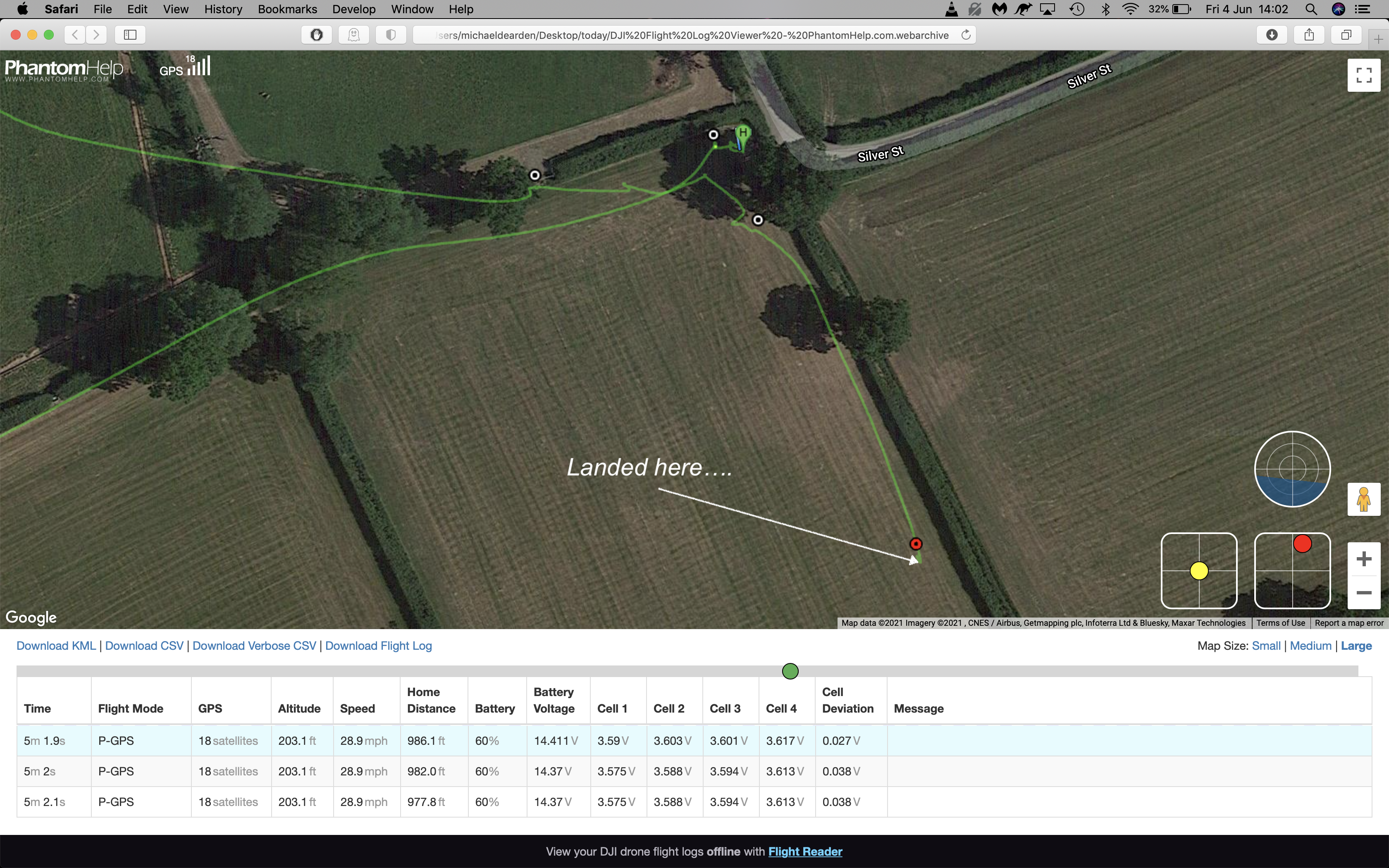

The landing in grass is at the very end of the flight, from the big Oak tree up the L/H side of the filed!
I have managed to open the right .txt file inPhantom Log Viewer and these are the csv, csv-verbose and log files from that.

At 9:22 you brought the Phantom down to 10 metres and at 9:38 you descended to an indicated height of 5 metres.
You flew around a little and hovered until 11:01.9 when you pulled the left stick down for 1 second, but the indicated altitude shows no descent.
The flight ends at 11:03.6 with the drone still at an indicated height of 5 metres ... exactly the same indicated height it had been for 1.5 minutes.

If you are sure that that is the correct flight, perhaps you can tell how high the drone was hovering above the crop for the last 1.5 minutes.
As the barometric sensor often drifts during a flight and there was no VPS data, it's not known if the 15 ft indicated height was accurate or how far out it might have been.
If you look at the video in post #23 at 20sec it stops and then descends. Probably no more than 1mtr above the grass.
That video represents the last 20 sec of the flight shown in screen shot in post #28 leading up to the "Landed here".

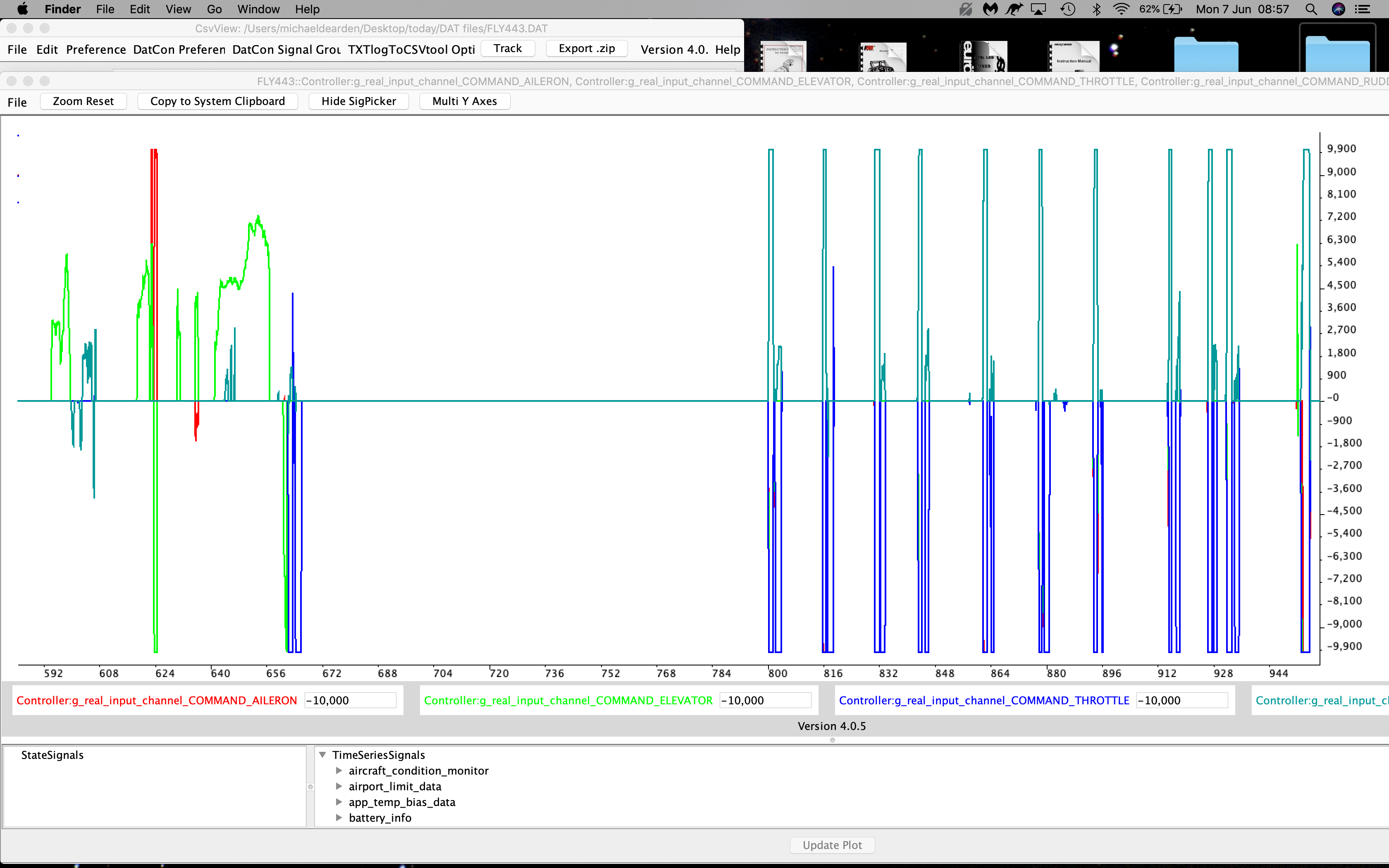

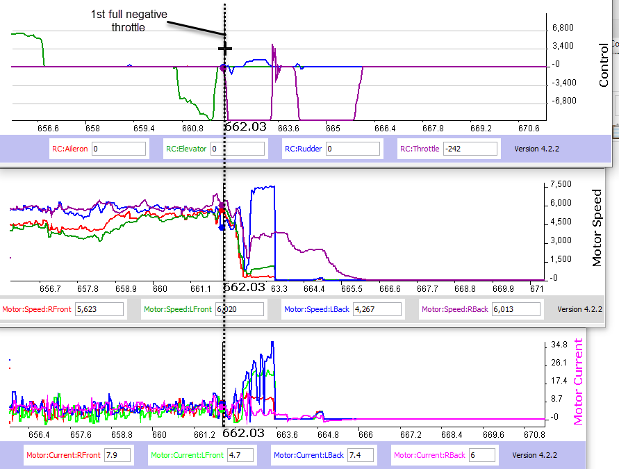

FLY443.DAT corresponds to the .txt and video you submitted. There were two full negative throttle inputs at the end, each about 1.5 secs in duration. The first caused the P3AP to descend into the grass. The second stopped the motors. From the motor speed and current data it is apparent that the leftBack motor got caught up in the grass.
As a matter of interest, can one get this sort of information from the .txt file? It would be much easier than uploading the .DAT from the drone?
Can I delete all the earlier .DAT files from the drone, save hunting through them all every time.

There were two full negative throttle inputs. The first started at 662.11 and lasted about 1.5 secs. That caused the descent into the grass.. The negative throttle was then released for about .5 secs. Then the second full negative throttle occurred at 664.2 secs also lasting for about 1.5 secs. This second one stopped the motors.
The .txt does contain these data but the down link was lost just after the first full negative throttle was initiated. Also, the .txt will stop recording when the flight terminates. I.e. the attempted motor starts after the flight won't appear in the .txt.
Yes, CsvView (and DatCon) is always changing - usually, but not always, for the better. Not sure which changes you are referring to though.
