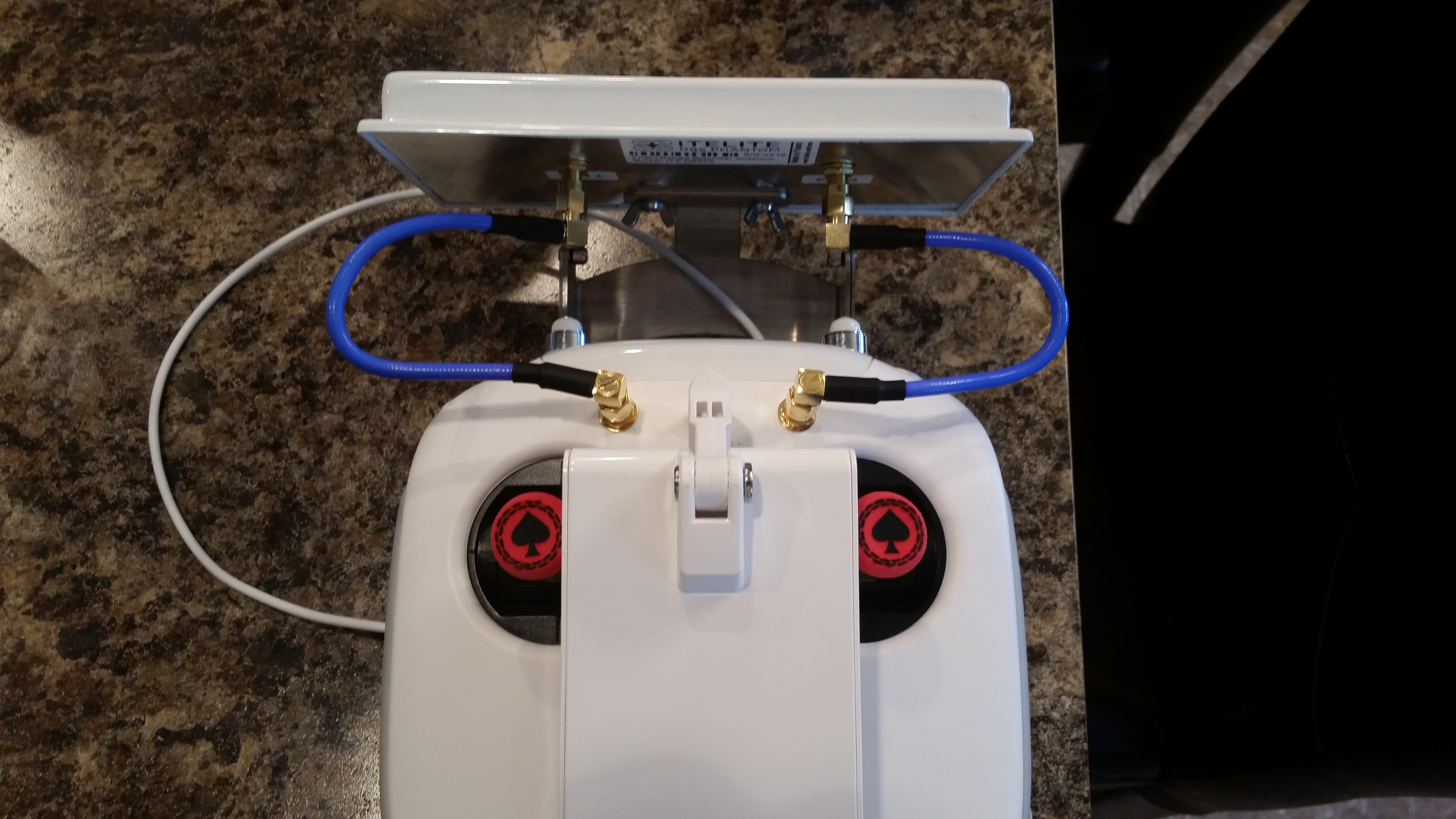

I like how you've re-used the original antenna location in the picture above. How difficult is that to do?

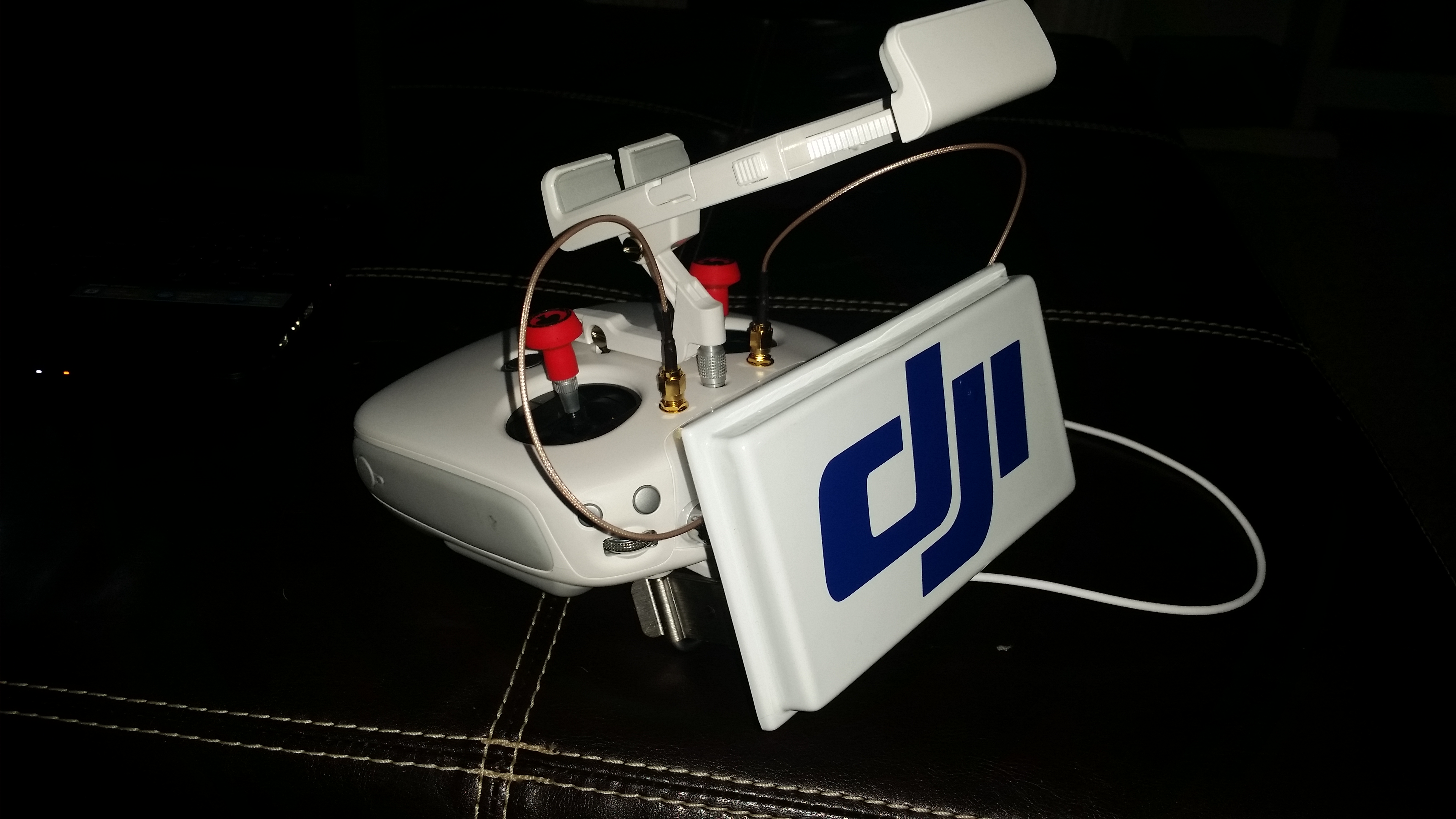

Absolutely the best antenna on the market clean and compact . The range is a lot more than the battery can do. Amazing . Thank you DBS!!
It was a bit of a pain in my case. I wanted them flush and not protruding out.
I removed the chrome ring. Then used a dremel cut off wheel to remove some of the inner white plastic because it was too small to push the bulkhead into. This allowed me to attach the bulkheads with the included nuts and washers to the white plastic. Put the chrome rings back on. Then had to lightly modify the inside area so that coax was not going to bind or kink. Defiantly don't want that stuff to get messed up.
In the end it worked out how I wanted it to & looks great. No gobs of epoxy or anything used. But I don't suggest it for anyone new to modifying stuff.
Had to modify my case to fit the controller all together. And yes there is plenty of clearance between the prop and antenna. The antenna is actually snug in the foam and won't move.
Glad everyone is liking their DBS ITELITE panels. Now only does it look great it also works great.
