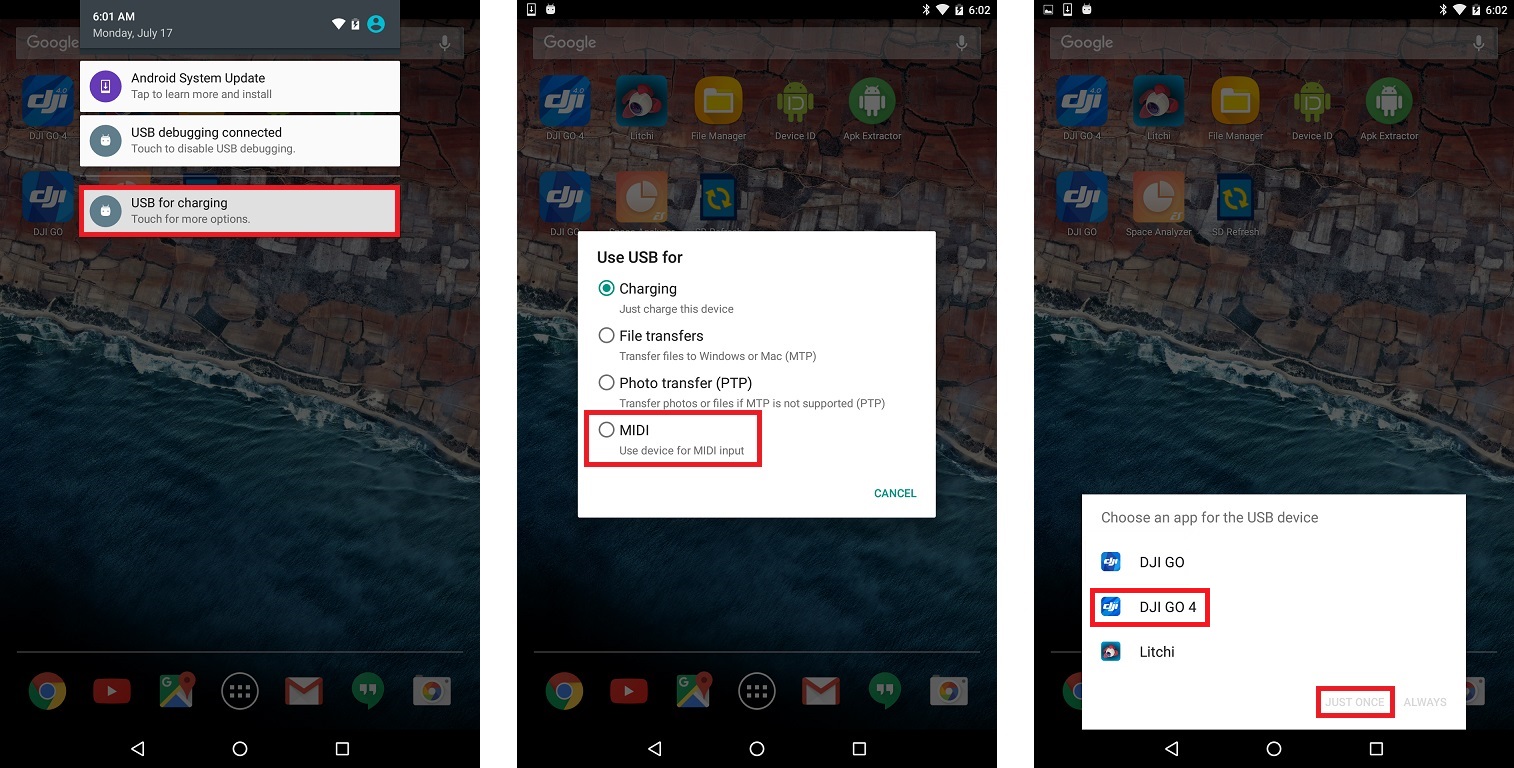

Unlike the P2, this one uses a cable between the controller and phone. Are you connected with a cable?
Geo
After connecting the cable to your phone, did you swipe down from the top of the screen and set these USB settings?
how do i get that APP to show up like u did in the last screenshot?
You'll need to clear the default app like this. After doing that, you'll always be prompted to select the app as long as you choose "Just Once".
Did that but
Did that but not working.
