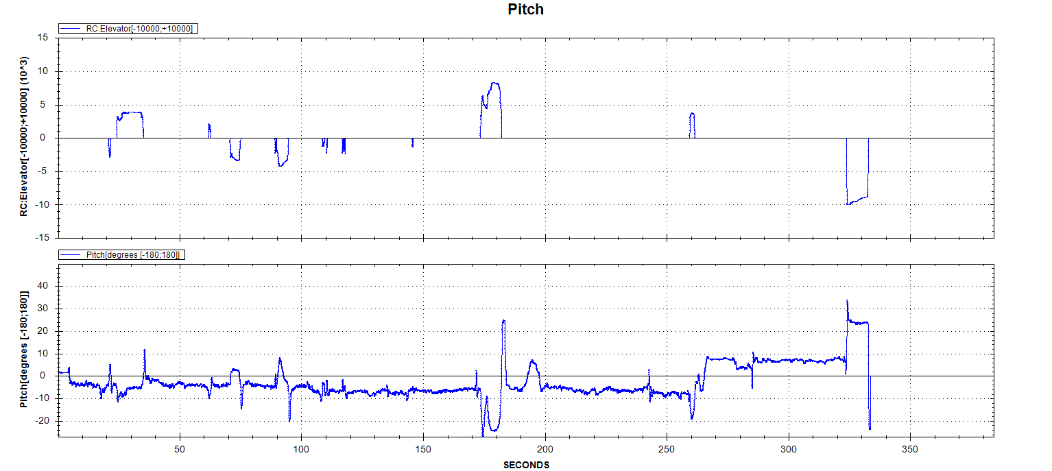

Ok, just at first look ( and I cant verify this 100% from this file), it appears as though one of two things occurred. A) A sudden power loss of some sort OR B) The battery dislodged. Just for informational purposes, I have seen quite a few P4's eject batteries around here. It is a known design flaw, which was changed in the P4 V2 series. ( May not be any better, just to add). Most of the time it appears to be heavy braking which causes a battery to dislodge. Not neccessarrly coming out of the housing, but disconnecting from the contacts. I say this because looking at the last few seconds, you gave the aircraft full elevator and were traveling at 20mph and you released the stick. This causes the aircraft to pitch upward very quickly to brake ( Unless you changed the braking settings). When this happens, the battery can dislodge. ( See Charts Below ). As I said, I cannot confirm this, however, since there have been quite a few ( More than there should be) of these batteries dislodging, that is my initial guess. If you can pull the .dat file from the aircraft that could provide more info, but probably not much.

Looking back closer at the above chart, that last braking maneuver did indeed occur before the loss of telemetry and only milliseconds before. The .dat file should confirm that, if indeed the power loss was near simultaneous to your device disconnect.

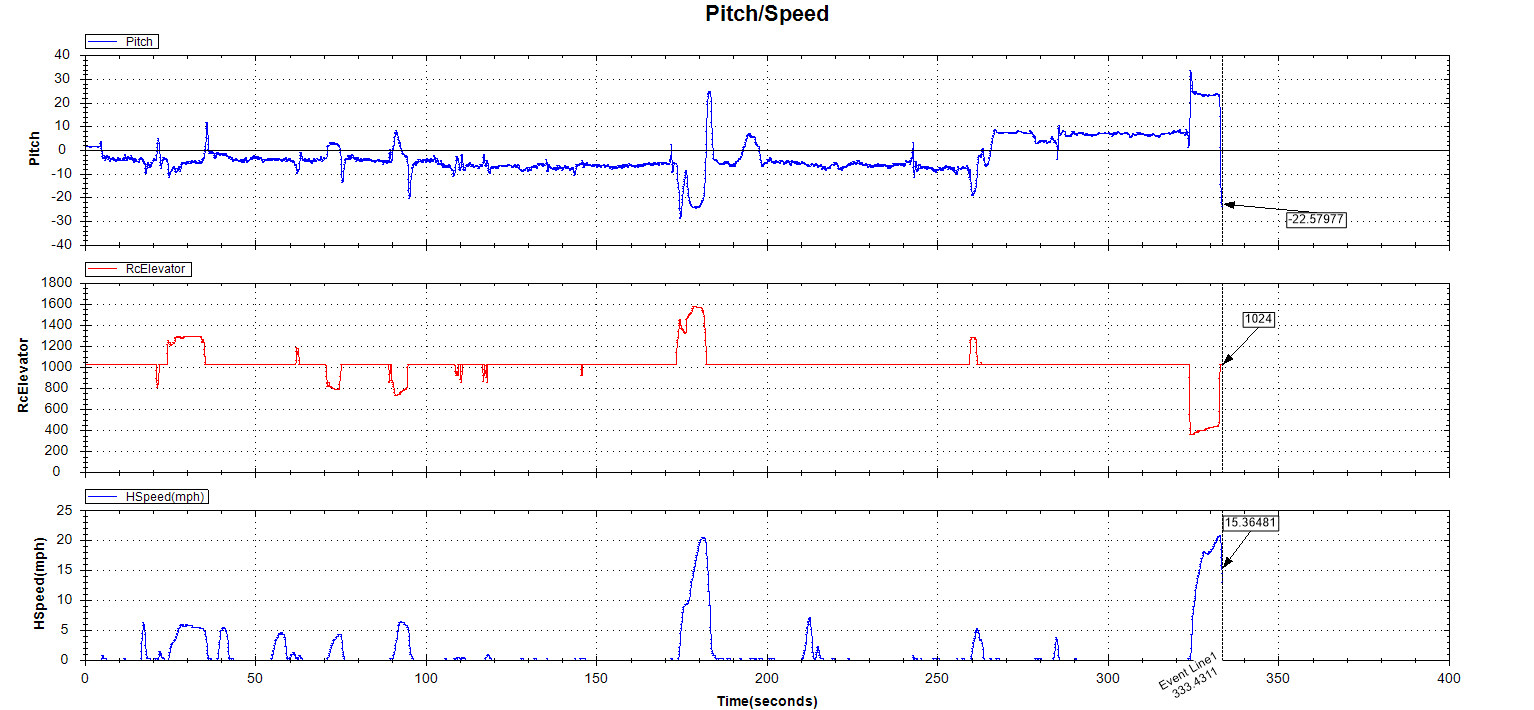

This certainly appears to be a sudden power loss of some sort as the data matches up with the device data. This occurred mere milliseconds after braking, which still leads me to believe that the battery disconnected. I am going to see what @BudWalker can determine from this. It is definitely a power loss, but where is the question. Your device USB connection is a completely separate issue and had nothing to do with the aircraft falling. Below is the matching .dat pitch chart to the device one posted earlier.

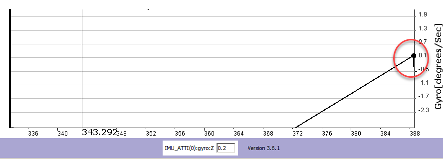

The only thing I can add is that the .DAT exhibits file corruption like what is often seen with the battery being dislodged. The last values from this flight were recorded at 333.542 secs. But, then there are some data recorded at time 388 secs with nothing in between. These last values are actually from another flight. The battery being dislodged caused the .DAT to not close properly.
If you run DatCon at the highest sample rate and then look at the .csv you can see a few gyroZ values from the other flight.
