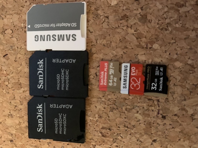

I’ve tried 3 brand new cards and they don’t work. Installed straight out of the package.
I’ve also tried diskpart clean and SD Card formatter. Along with formatting on my Canon camera first.
Even without a disk inserted I get invalid sd card error. Is that normal?
