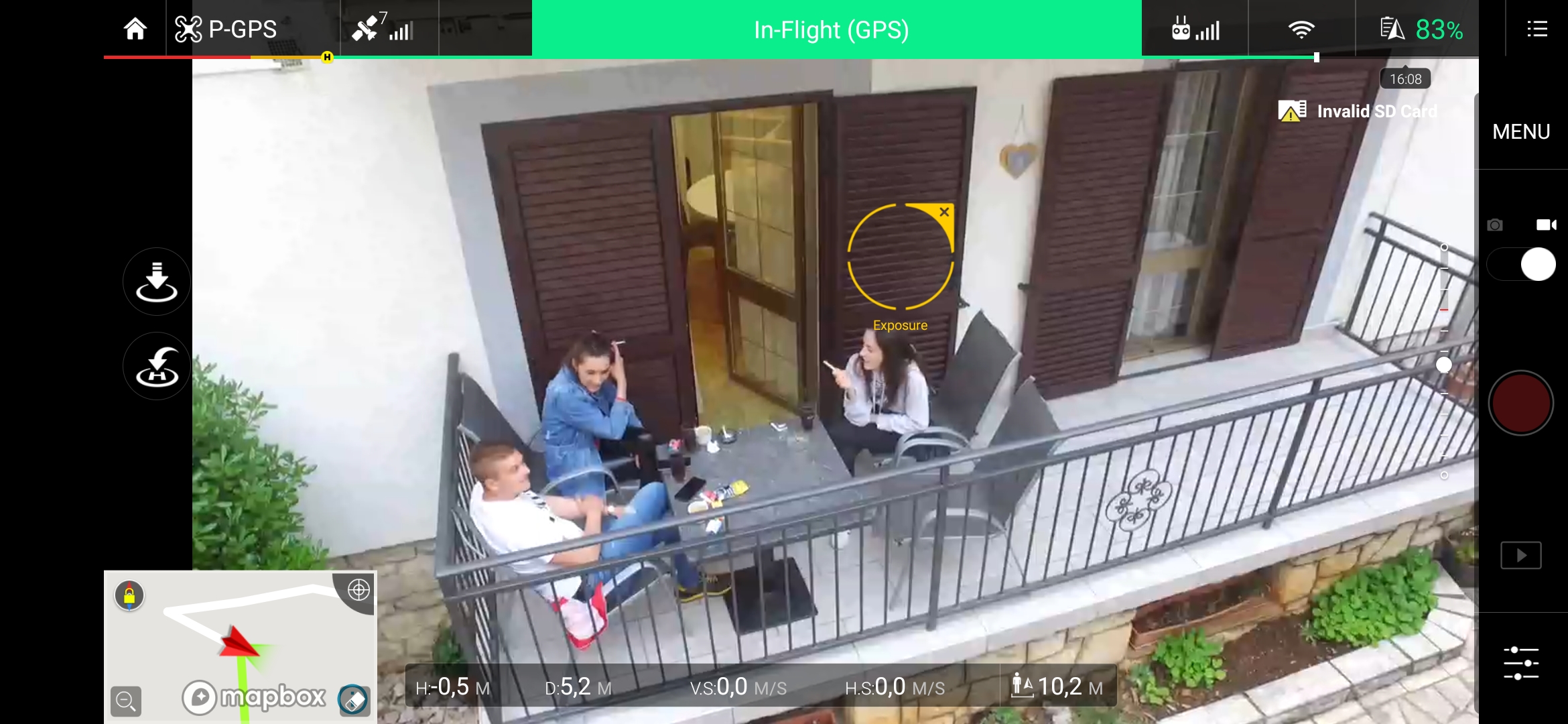

And regarding the sd card, when I connect the drone to my cell phone I see a picture and it works, but I can't take pictures or record, I just have a current display on my cell phone.

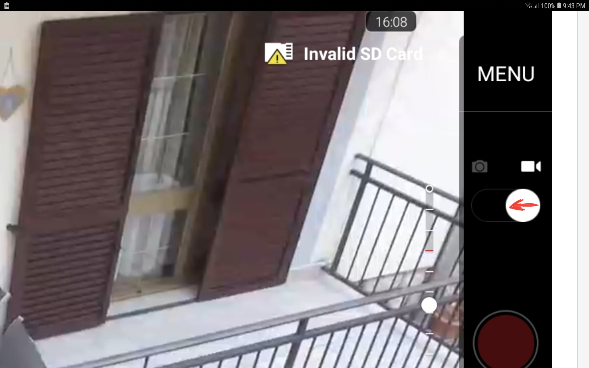

Yes my button on screen is grey an in the corner said invalid sd card.

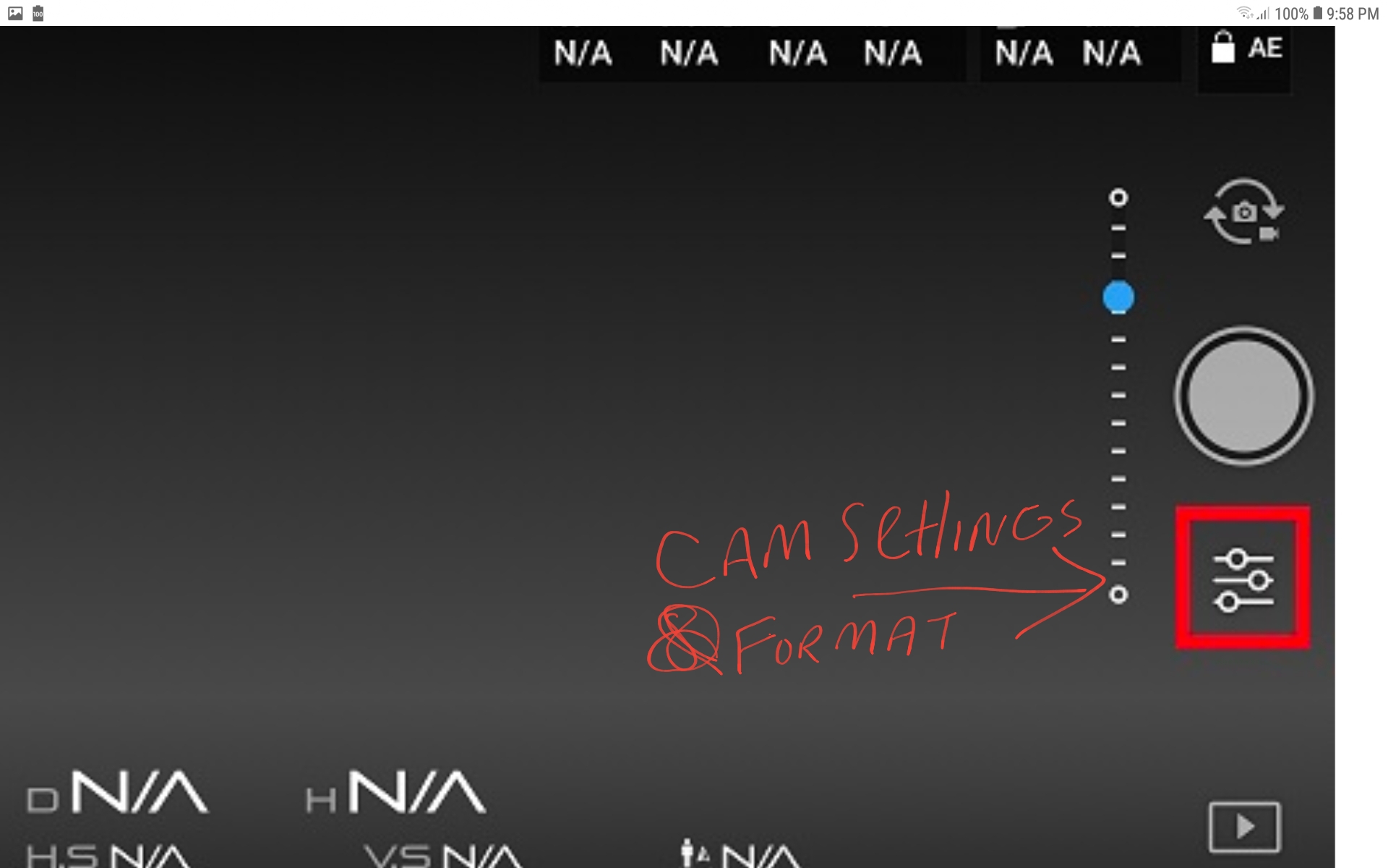

Are you able to enter cam settings,,did you try the format sd card through here,I just ask cause you not mention,,,also try take sd card out turn on drone,this will make gimble flash red which indicates not sd card then put sd card in,it should go green,,does that happen with any change
I tried to format the card via mobile phone while the drone is on and throws out an error saying it cannot be formatted. Maybe it's really up to the card.

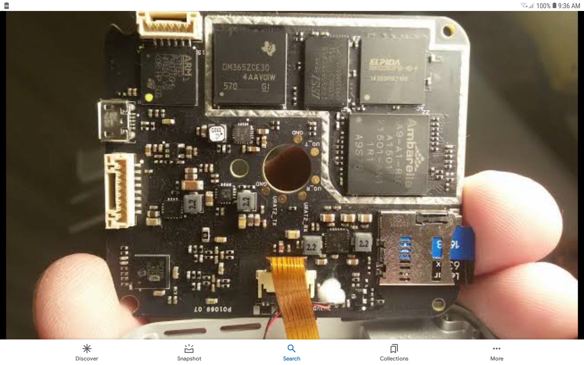

Mayby try blow sd card slot out with some air,its either dirty or has fault if multiple sd cards tryed,,I search around yesterday too but could only find card reader fault but unsure if that's the fault without having another to try,,and if it is this doin that,,not sure how to test this part
This what board look like inside..just for the record,,no real way to test unless you have another
