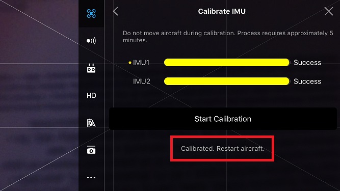

If you really have a P4, the drone must remain on a level surface throughout the entire IMU calibration process. Here's a video showing how it's done:
When the calibration process finishes, you'll see a message prompting you to restart the drone -- like this:

Right -- there is a new calibration process if running firmware 2.00.0106 (or later). DJI has not documented this process for the P4 yet, but it works just like this:
When calibrating the Phantom in each step, the back lights will be solid yellow. When they start flashing green, the Phantom should be moved to the next position (as shown in the DJI GO app). It's kind of a confusing process since the app makes it look likes it's calibrating -- meanwhile, it's waiting for the Phantom's position to be changed so it can continue.
That is exactly the way it must be done!! If you follow the pics in the app you don't have to worry about the light color! The app will tell you when to reposition the P4!

Try calibrating the IMU like this:
Any idea if it can be done inside? or does it have to be done outside?
It'll be easier to find a level surface indoors. It could be done outdoors though.
