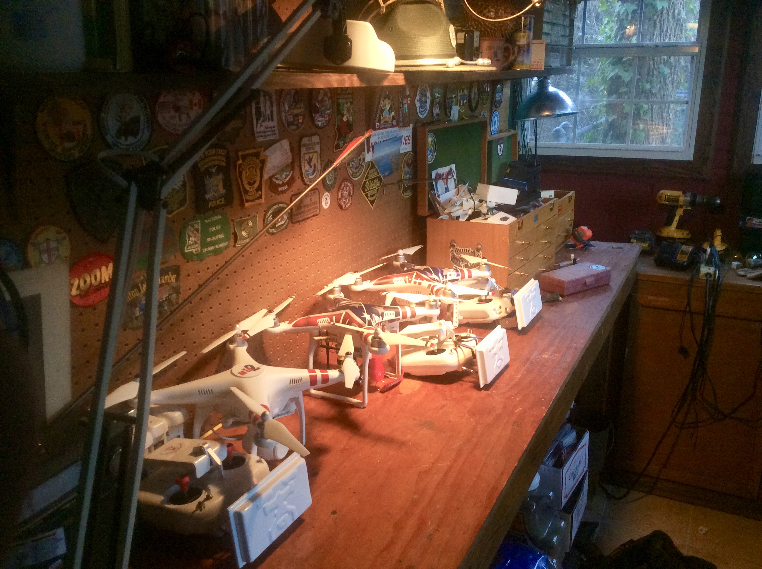

Great and has been so long on the RE500 I had forgot it was the 700 on the +.
Yes the itelite was as far as I am concerned the best one we were trying but you do have to stay aimed dead on to max it out.Liked em so much I had 3 on birds.:)
