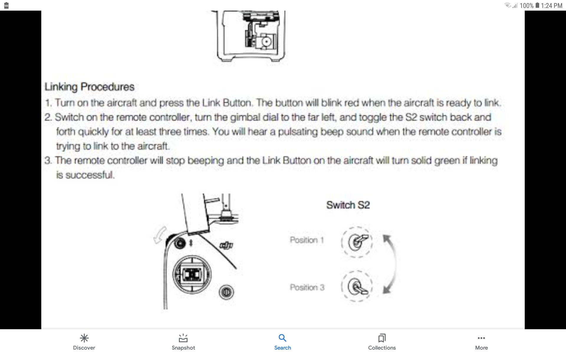

Did you try manual linking method,,,can you feel the link button click when pressed,....

I didn’t try that and yeah that’s why I think the crash either broke the link button off or it’s stuck down. Cant feel it click. Off tomorrow so going to look at it then.
