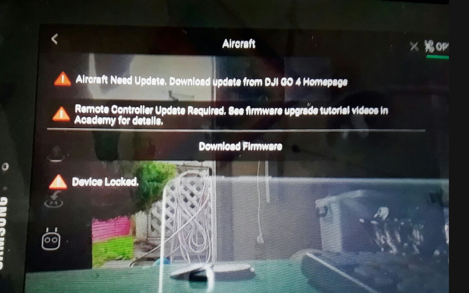

Lol and if you should fall victim as I did you ain't got a choice
I had prompt after prompt every time I powered up,I could work around it for a while till DJI put it in lockdown, solid red lights all over,dont seem to happen these days so dont know why I got it.im still unaware of any circumstances where DJI can do that but somehow they did or the app did !!
My update did go well which did surprise me but this p4 (pride and joy of the fleet) did end up doin a freefall from the heavens (rip) related, I dont know,was battery error that shut down fully in flight, :eek:

Never heard of a drone being "Locked" by DJI, that's terrible!!
