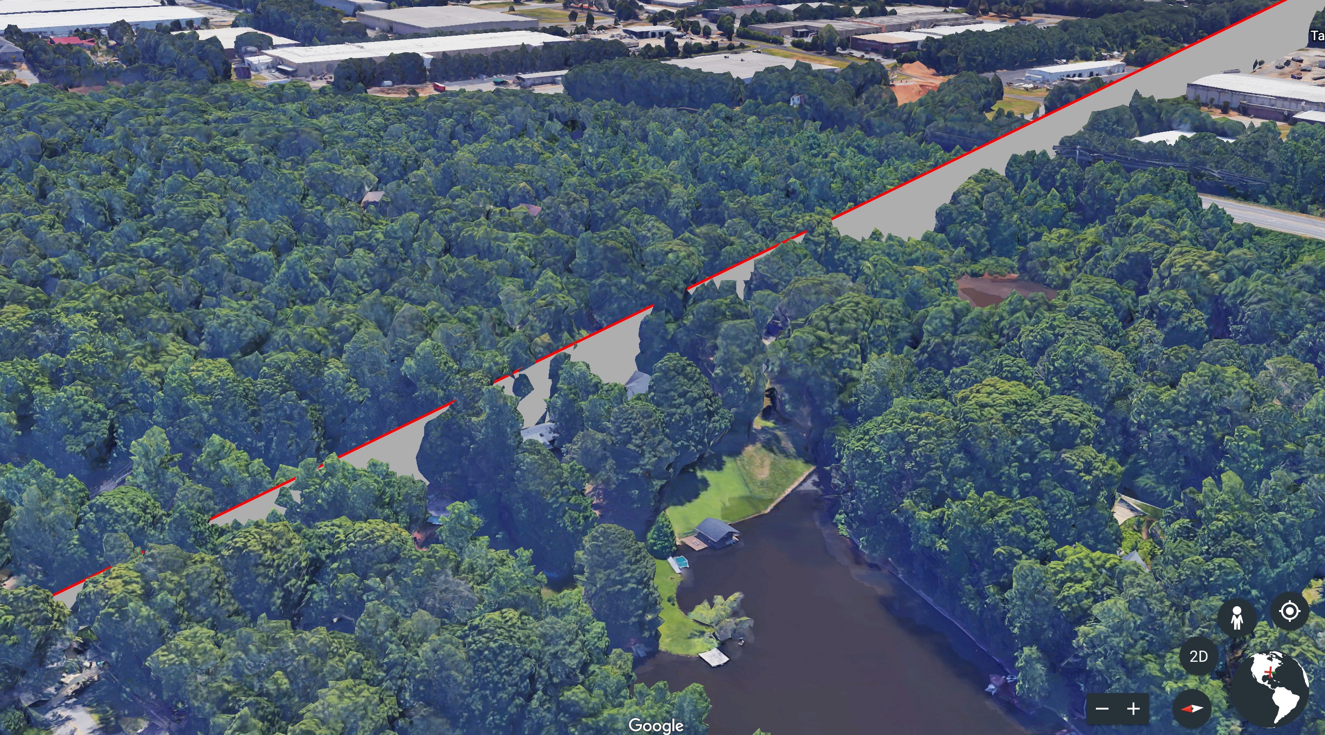

OK - I found the problem. The Google Earth Pro version that I was using apparently did not have access to the full 3-D database.
That certainly illustrates the problem with the trees as it descents towards WP3.
Reactions: WBN3 and Peio64270
Yes, very well ! :eek:
But this also shows that the drone is probably not far from the drive.
(How do you obtain this view ?)
I had previously created the kml file describing the path of the programmed flight between WP2 and WP3 with path extrude set to "on", and then I just imported it into a version of Google Earth that supports the latest 3-D imagery. I used Google Earth for Chrome, but the more recent (non-pro) desktop version also seems to work.
The problem with this is that the elevation of the surface objects can be exaggerated depending on what setting you choose (see pic)
and when was the 3D survey done (a few more years growth on the trees ?:))
Although It does sort of show the taller tree slightly to the left of centre of the smaller hill which I could see clearly in the OPs phone video of that area. I think this tree could have been right in the ACs path since the original post( shows the AC passing off centre as well .The OP says this as well)
It also depend greatly on the placement of wp2. If the last mission wasn't saved and the first one didn't have wp2 (you said you added that while hovering .How do you know where wp2 was ? Or am I mistaken in my understanding .
The latest (GE for Chrome) version doesn't have an option to exaggerate the heights, so I would expect the elevations to be at least reasonably correct. The path is dependent on WP2 being approximately correct but, as long as it is in the correct general area and at the correct height, it won't change the picture very much. I would not rely on this to try to identify exactly which tree it may have encountered, but it does show pretty well where the path of the aircraft starts to drop below the height of the surrounding trees.
It does indeed and I need to get in that little island [emoji267]...I called the steel company and they said that they didn't mind at all so I will try and rule that out..I also will search the area where the the path shows it making its way into the hood. You can clearly see the red line intersect a tall tree so that's a possible target as well.
