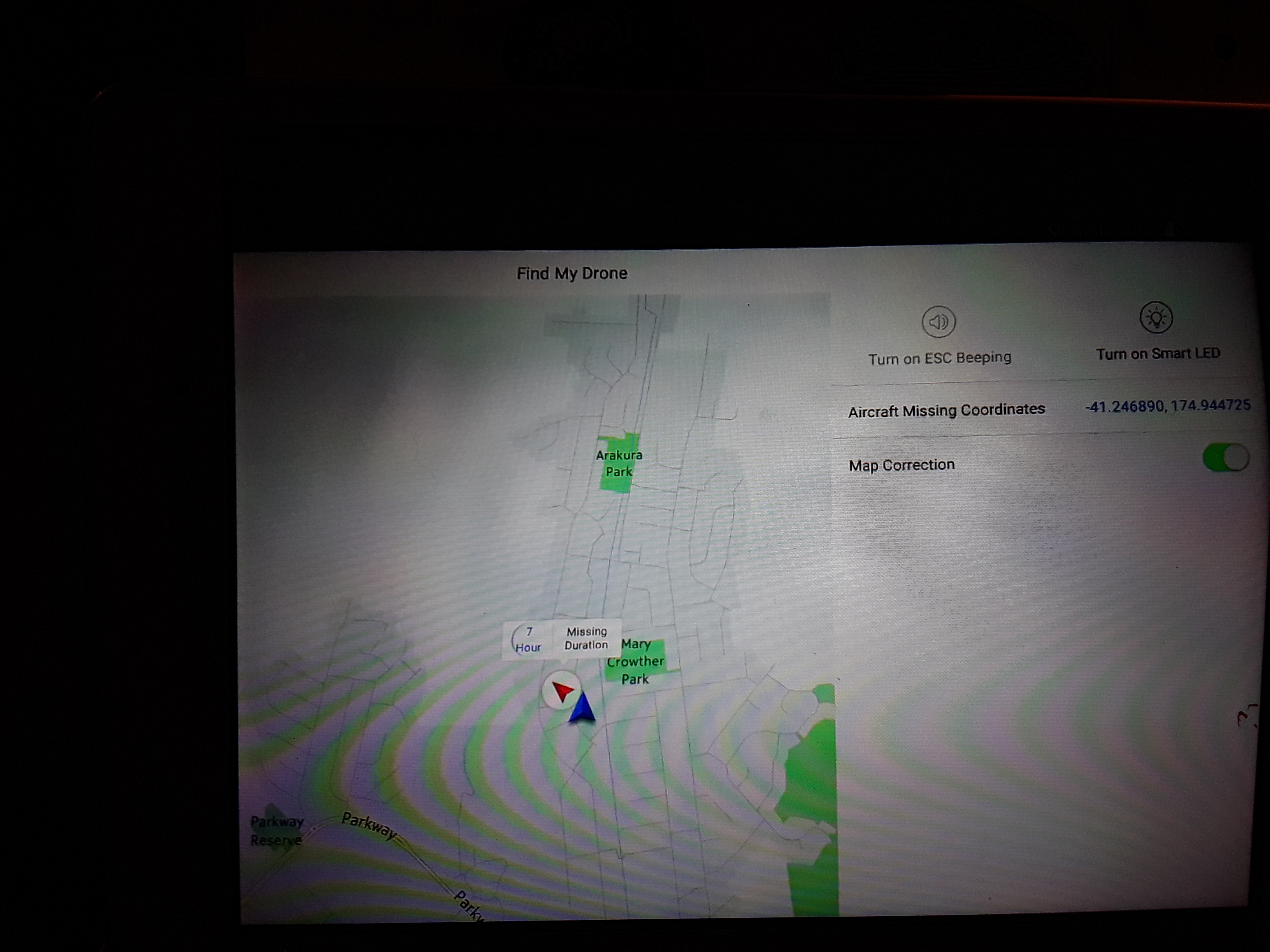

find my drone works giving you a map,you can touch red or blue icon and it give you coordinates like in this pic,
