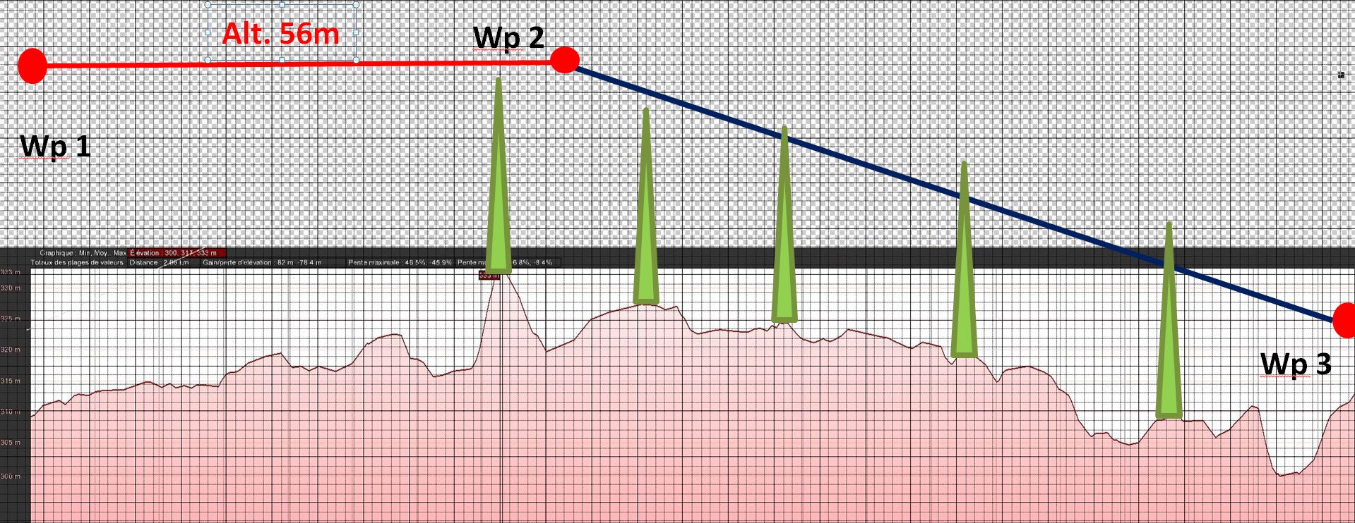

In an attempt to formalize what could happen, I draw the flight path from waypoint 1 to waypoint 3 over the terrain elevation profile from Google earth along this path.
Steady altitude from waypoint 1 to waypoint 2 is 184 feet (around 56m) over elevation of waypoint 3 (launch site) then descending from 56m (waypoint 2) to 12m (39 feet) at waypoint 3 (home).
I placed some trees (all high 30m) along the path. The projection shows that the drone could well meet the top of a tree anywhere between waypoint 2 and 3 but more likely close to waypoint 2 (just after or even before if one of these trees is taller than 30m).
Hope this helps.
Hope this helps.
View attachment 83090 View attachment 83091
Well, That opens up a new area as well..BEFORE Waypoint 2 near the power lines! I am taking this all in and will head beck out with a plan this weekend.

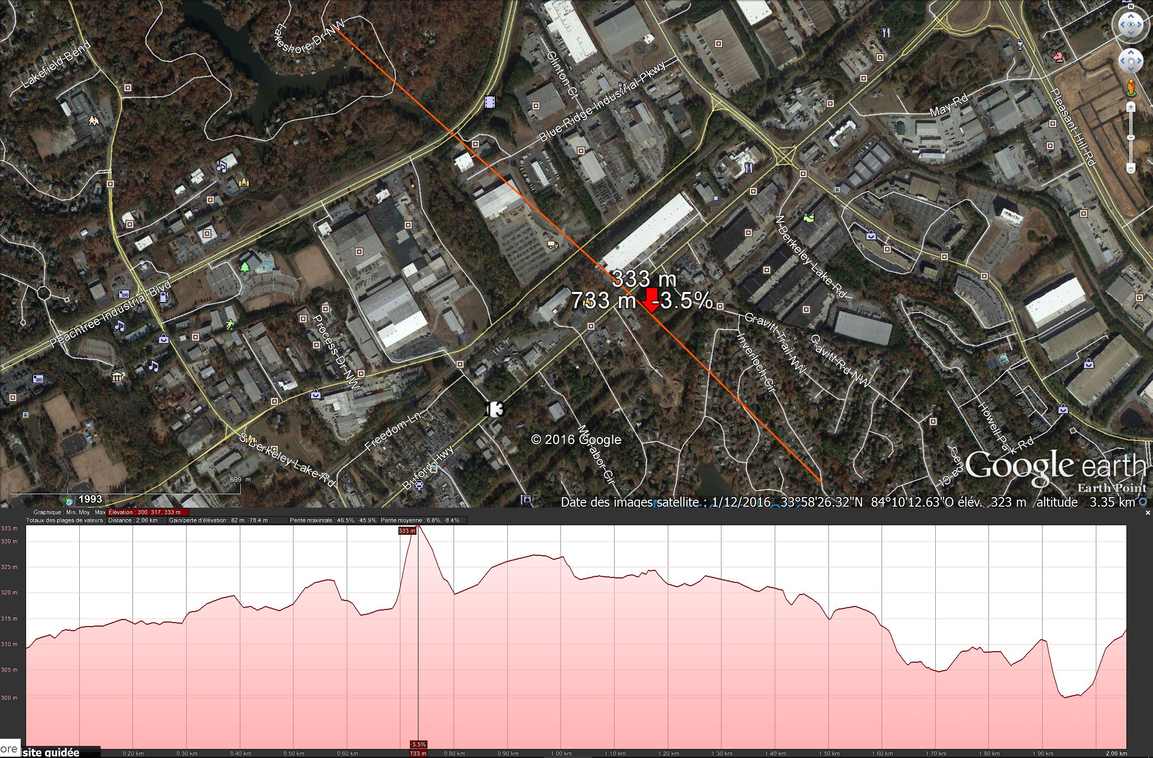

sar104 I worked out how to get what I was looking for .It probably uses the same data as your street view so may not be any more accurate but it does give another perspective .You can also fly the path in 3D which you probably know .
Very nice - that looks signicantly more accurate than Google's street view implementation. What did you use to generate it, and did it reveal any other likely areas?
Once you convert and import the recreated litchi file its just about the settings in GE I'd like to make it sound more complicated but that's it
