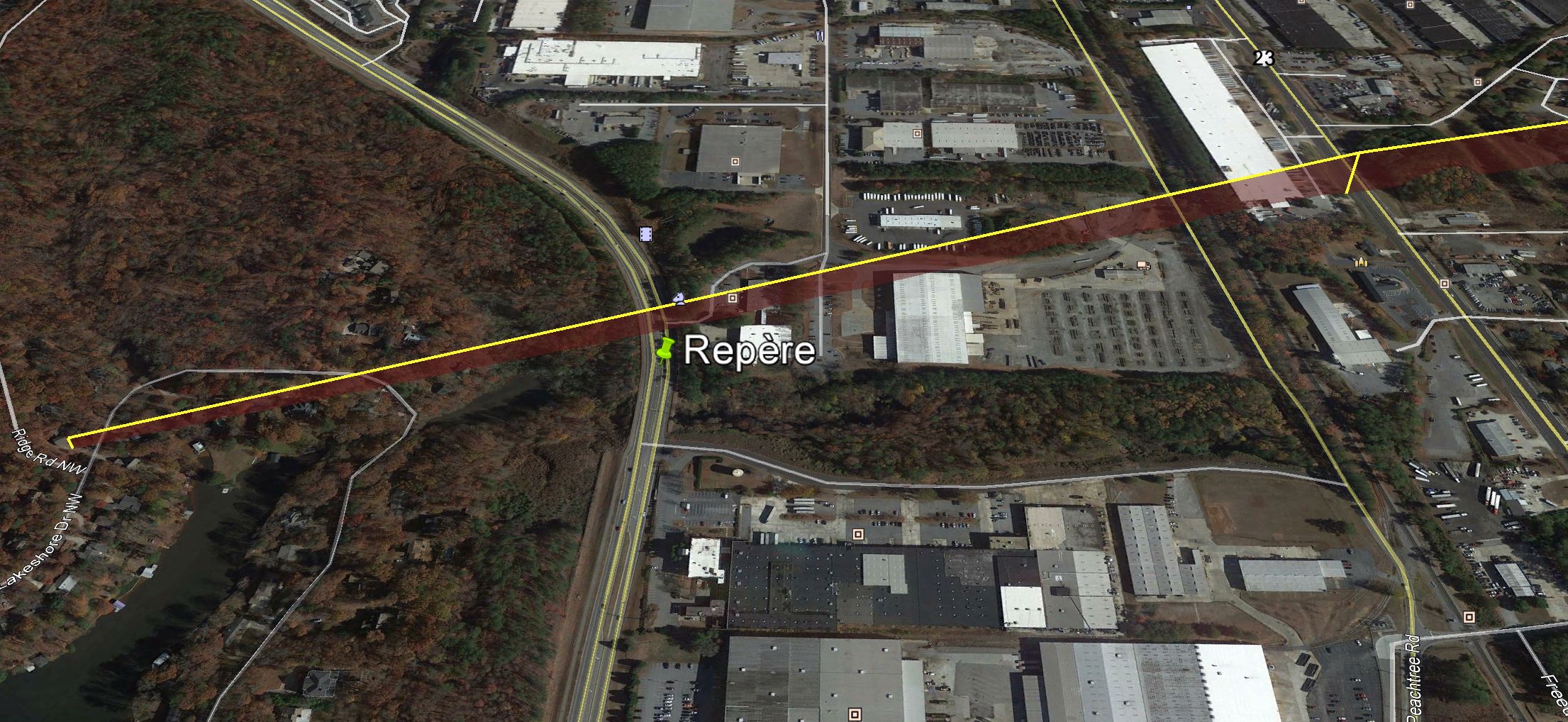

I did this first with Litchi hub taking into account terrain elevation changes along the path at given waypoints, then export a csv file that I transformed into kml file fort import in Google Earth. Altitudes are in meters but they translate faithfully your altitudes in feet at waypoints.
I must say that that the location where your drone could encounter an obstacle much depends on your take-off point since waypoint 1 of your path is located around 4m (12 feet) below waypoint 3. Thus if you took off from waypoint 1 and not from around waypoint 3, your actual altitude above the ground becomes 183-43=140 feet at waypoint 2 which elevation is 43 feet above waypoint 1; and only 38-12=26 feet at waypoint 3 !
But I assumed that you took off in the vicinity of waypoint 3 of your pic, that's why I have inverted the rank of waypoints in order to take the terrain elevation of this waypoints 3 as a reference for the other two. Waypoint 3 thus becomes waypoint 1.
Mission Hub - Litchi
As such I obtain these two figures in Google Earth :
View attachment 82936 View attachment 82937

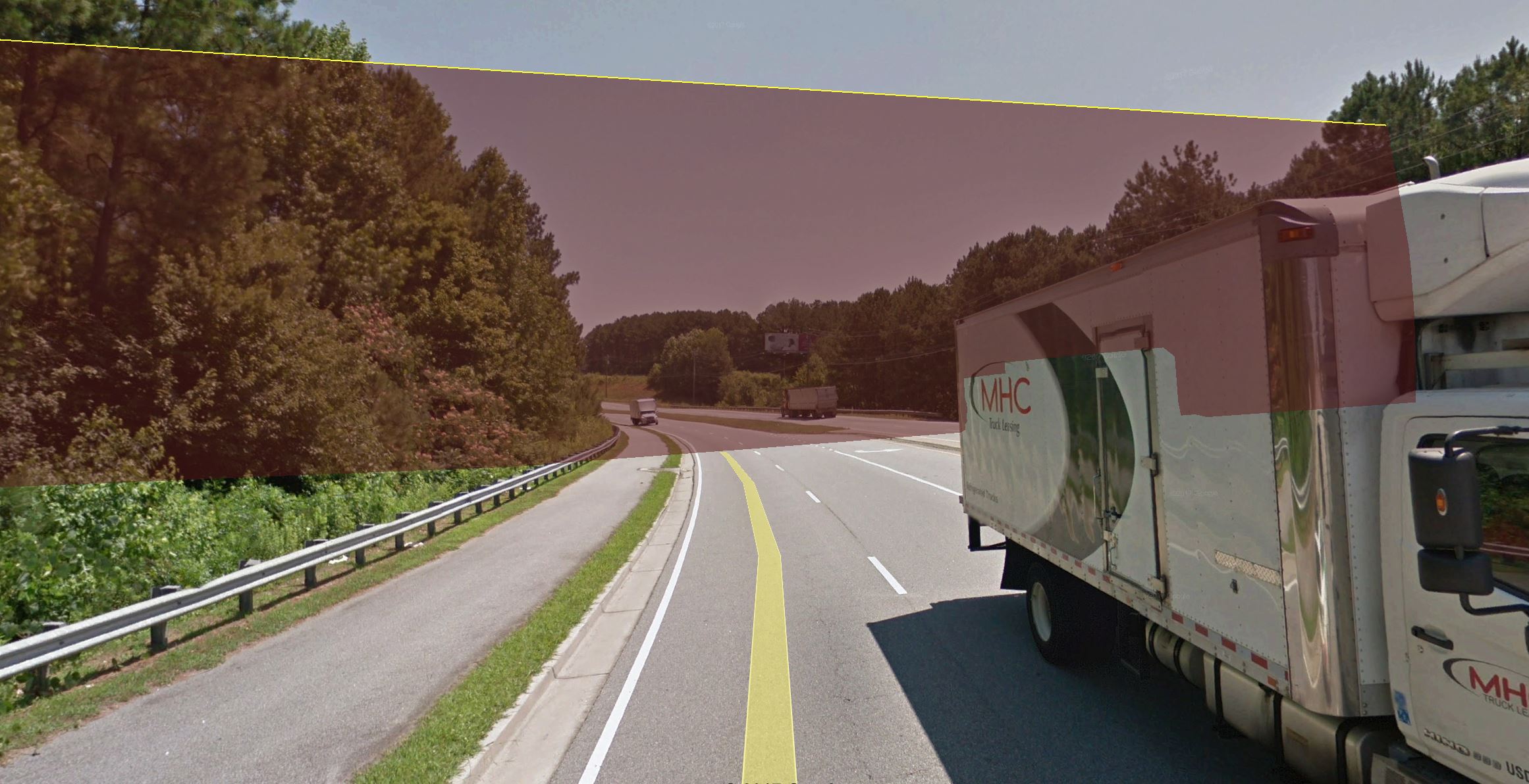

The second one is the street view from the location of my green pin named "Repere".
Your altitude above ground should have been around 25/27m at this place.
If I am right, you can have wrecked in a tree at one side of the other of this highway (maybe just before crossing it, I don't know how is the landscape further).
I would personnaly begin my investigations around this place.
Good luck, anyway !
