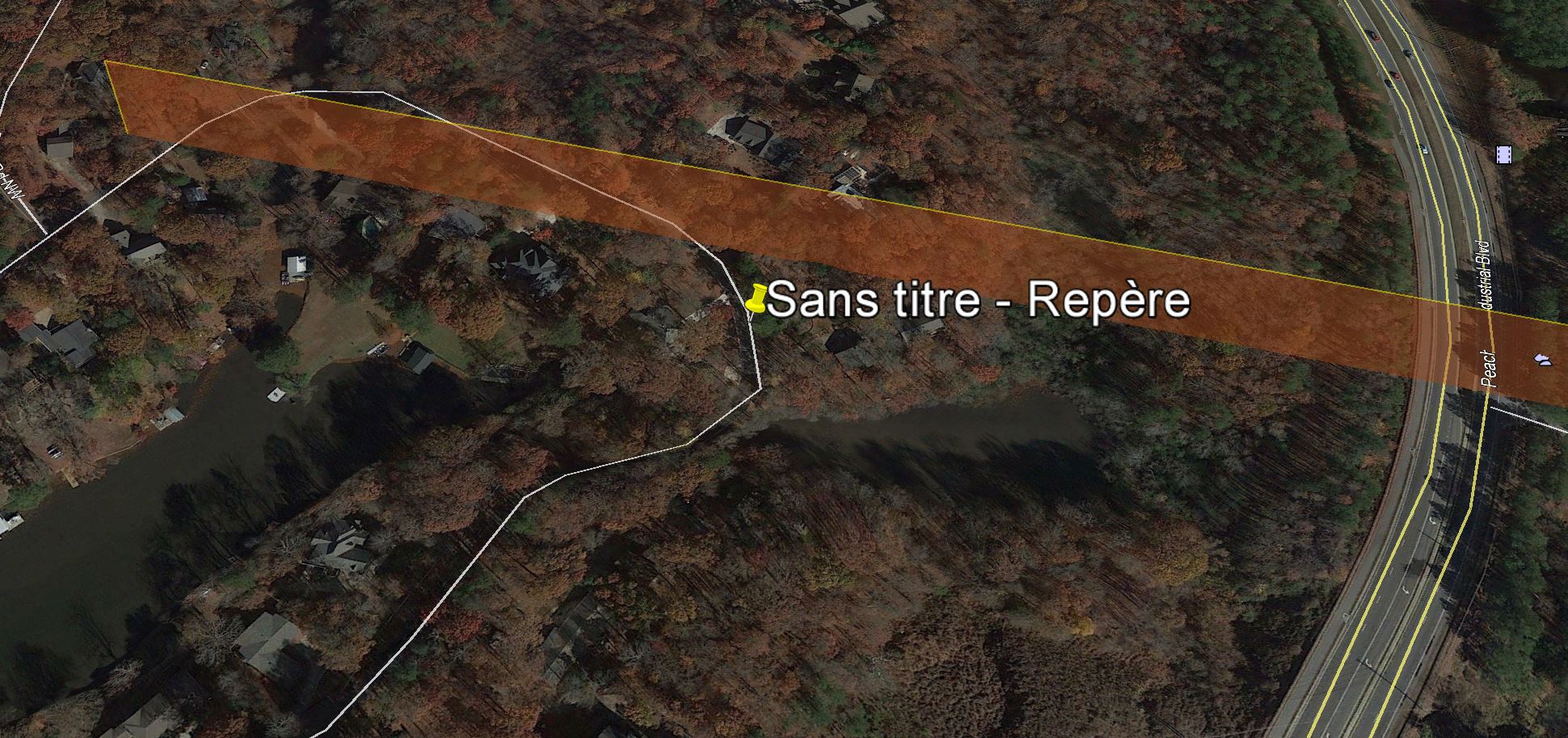

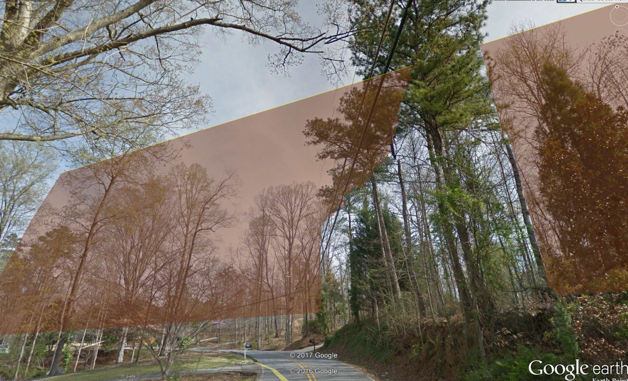

Very likely you lost it in a tree around Peachtree Industrial Bld. Even when setting waypoint 3 to 93 feet, it seems that it is not enough for flying over the tall trees that grow around.
I tried to draw your approximative path between waypoints 2 (183') and 3 (93') wich gives an altitude around 110feet when the AC is supposed to cross the little road where I put a yellow pin. If you have a look over Street view in Google Earth at the place of this pin, you can see that this altitude is not enough for flying over the tallest trees. Very likely your drone made a close encounter with one of these trees between waypoints 2 and 3.

This is very helpful I wish I knew the altitude of that line. I know what it is that way 2 but it would be nice to know what it is is it sloping down so I can determine if it cleared items. I'm posting a video that basically shows the path over the big pipe field..(That big Area that looks like a parking lot)..
It helps to remember that I lost communication right at the front of the building at the pipe field headed out. I never regained communication from the drone on the return home path.
So, it stands to reason it didn't make it to the front of that building that says directly in front of the pipe field. That makes me think that little island of trees to the right is the prime area..

I did this first with Litchi hub taking into account terrain elevation changes along the path at given waypoints, then export a csv file that I transformed into kml file fort import in Google Earth. Altitudes are in meters but they translate faithfully your altitudes in feet at waypoints.
I must say that that the location where your drone could encounter an obstacle much depends on your take-off point since waypoint 1 of your path is located around 4m (12 feet) below waypoint 3. Thus if you took off from waypoint 1 and not from around waypoint 3, your actual altitude above the ground becomes 183-43=140 feet at waypoint 2 which elevation is 43 feet above waypoint 1; and only 38-12=26 feet at waypoint 3 !
But I assumed that you took off in the vicinity of waypoint 3 of your pic, that's why I have inverted the rank of waypoints in order to take the terrain elevation of this waypoints 3 as a reference for the other two. Waypoint 3 thus becomes waypoint 1.
Mission Hub - Litchi
As such I obtain these two figures in Google Earth :
The second one is the street view from the location of my green pin named "Repere".
Your altitude above ground should have been around 25/27m at this place.
If I am right, you can have wrecked in a tree at one side of the other of this highway (maybe just before crossing it, I don't know how is the landscape further).
I would personnaly begin my investigations around this place.
