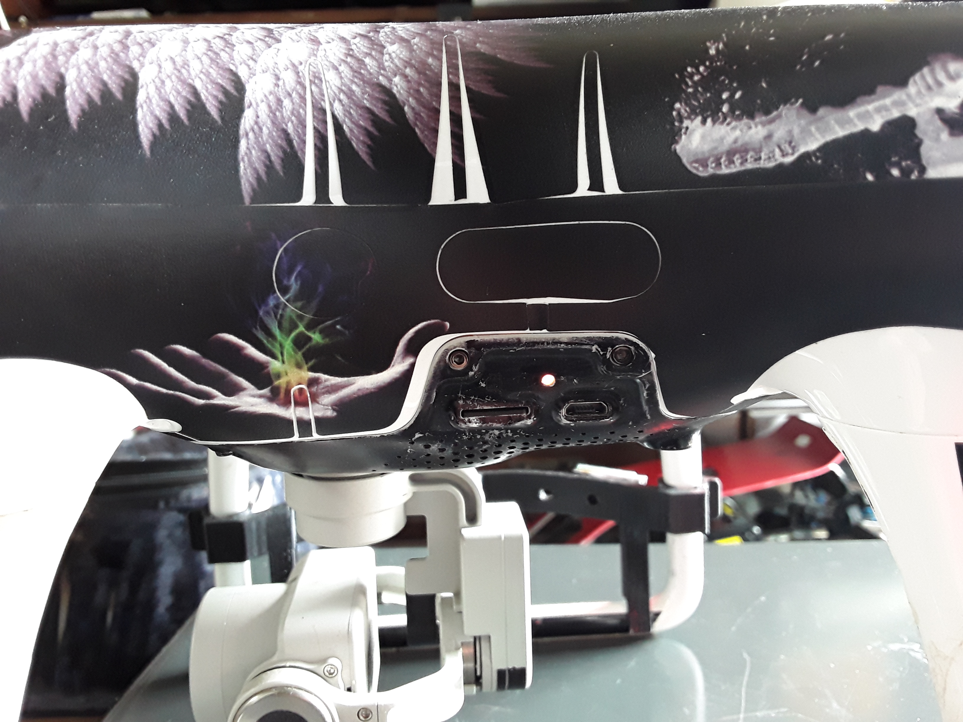

This is the link light ,need pin or needle to press
This is the link light ,need pin or needle to pressView attachment 103226

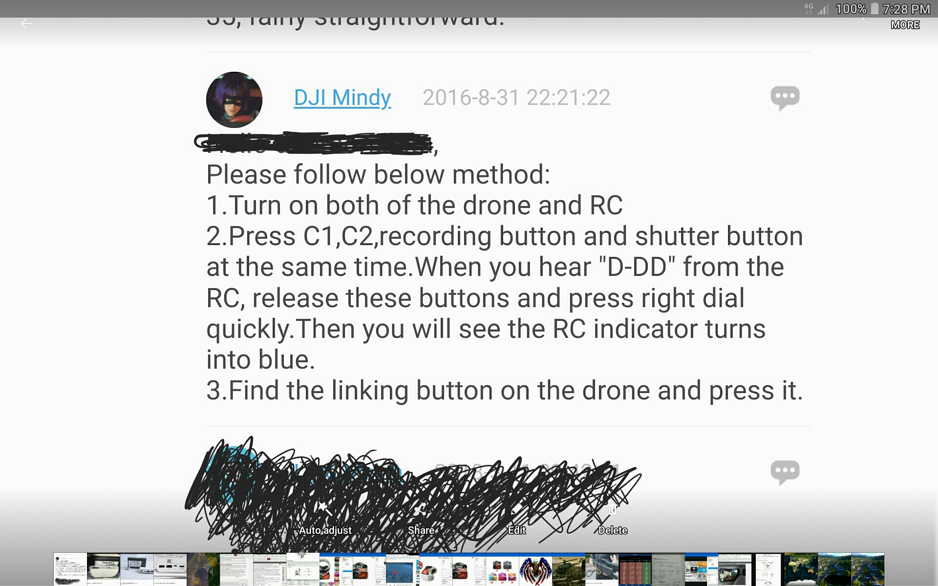

sorry I not read fully,when it says check frequency it does that itself ,this is when press link button,does it flash or what colour of lights when this is happening, are you using app under rc linking when doin this,,it might need a manual link without the app conected,,
Here's a manual relink link with out the app,try this method then restart all and try conect to app aswell

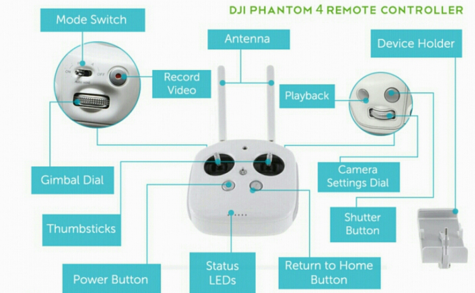

Sir, you have been very helpful. I will try the things you suggested as soon as tonight. I have one further question at this point: What is the "right dial"? Thanks so much again.
Sweet, left dial pans cam up and down right dial changes brightness of cam and when pressed in it works like a button,,

Well, that worked ... to some degree. So, many thanks for your help! Definitely hooked up to the drone but there are issues. No picture on the screen. Says it's ready to fly in dji go but when you select take off, it comes back take off failed. Also, I can't save changes in the settings. Sometimes comes back with instructions failed to send try again later. Front facing obstacle avoidance is reading the correct distance for obstacles. Battery level read on the RC for the drone is correct. When I click the top left green bar the indices come up "normal". When I try to sync to the drone (again just for a test) I still don't get the pop up telling me to push the button on the drone. Does any of this ring a bell?
