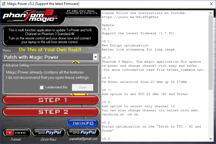

Magic Power v5.2
Support the latest firmware (1.7.9)
Download: http://bit.ly/p3magic

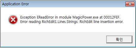

It has error in running Magic Power(5.1, 5.2)
why I did not find this error huh? [emoji53]
Sent from my MI MAX using PhantomPilots mobile app
I guess that it is language different in Riched20.dll or Riched32.dll on Windows OS. How about do you distribute files also or compile the exe files including dll files?
There was no problem in PowerMagic 5.0. But, 5.1 and 5.2 have the problem in running.

hi Papatita ... pls add RICHED.DLL into the app..

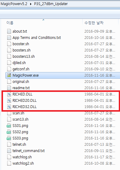

I already add riched32.dll and riched20.dll in a zip file
I don't recommend update fw 1.7.9 by a method insert into sdcard, try to install DJI GO v2.7.0 (all file on my drive)
You must add another one "RICHED.DLL"...check upsite #688
