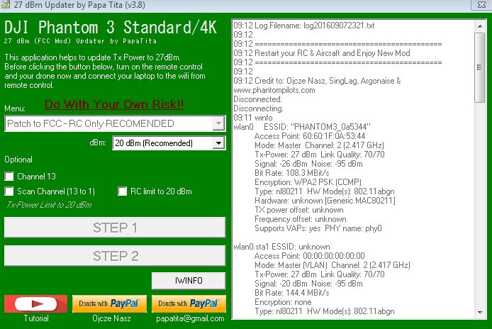

Ok, so I have an FCC Model with the DBS Antenna mod. As I understand, my remote and AC transmit power are set at 20 dBm by default. I'd like to pump that up to 24 dBm on the AC. Am I correct in assuming that I can use this patch to push the transmit power up to 24 dBm on the remote and AC selecting "Patch to FCC - RC Only Recommended" and "24 dBm". If I want to boost the the AC only, I modify the watchlog.sh file, change this line to "DRONELIMIT=2400" and perform STEP 1. I am not interested in the optional channel mods.
Just select like this:

You can try to test channel 13 via the telnet application, type the command: watchlog.sh -ch 13
If it fails just restart rc no need to revert back to ce.

A little note on master Papatita suggestion.....
You should run the MOD first without channel selection.
After that you can easily test if the desired channel works for you with the command watchlog.sh -ch xx
It will switch to the chosen channel untill you switch off the stuff, after switching back on it will select the channel automatically again.
