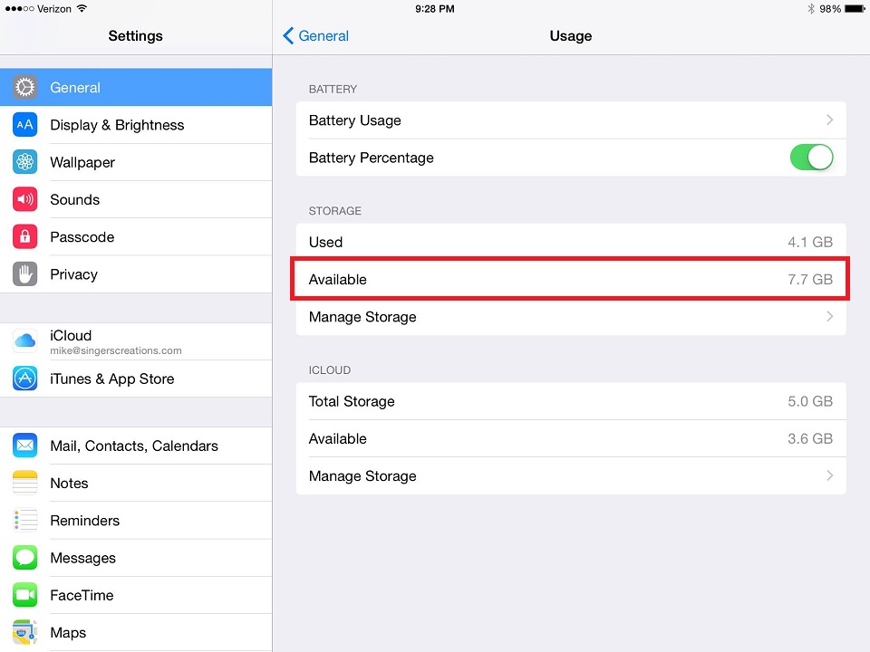

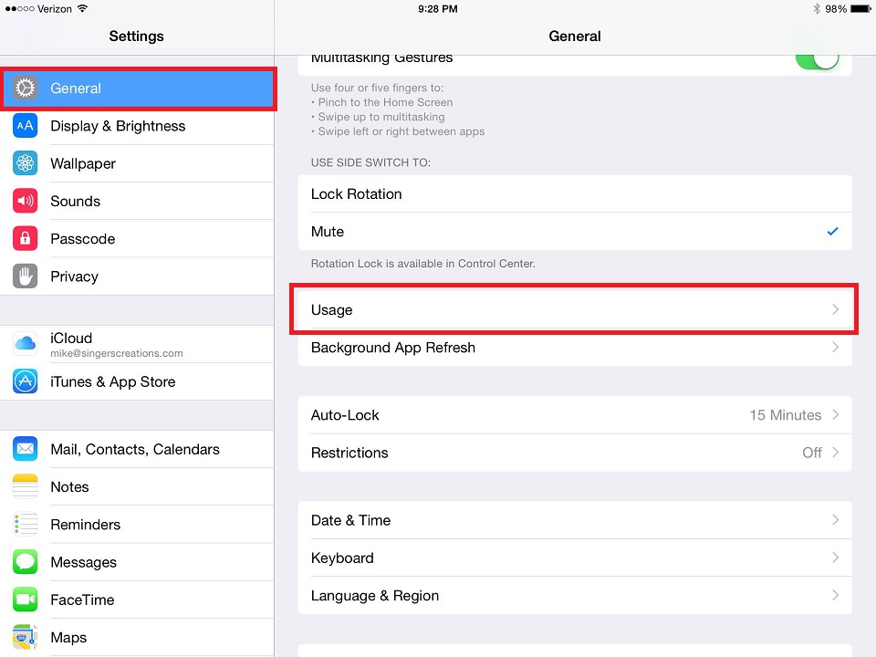

2) In the "General" --> "Usage" section of the iOS Settings, verify that you have at least 1GB of storage space available. If you're low on available storage space, uninstall apps that you're no longer using and/or remove all unneeded photos/videos from your device.

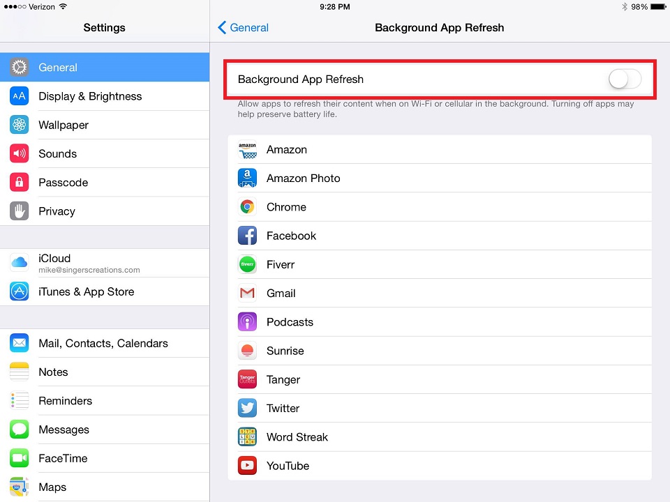

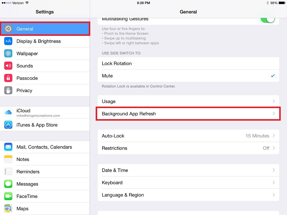

4) In the "General" --> "Background App Refresh" section of the iOS Settings, turn off the Background App Refresh feature. This will ensure that any running apps are not doing unnecessary work as you're flying in the DJI Pilot application.
