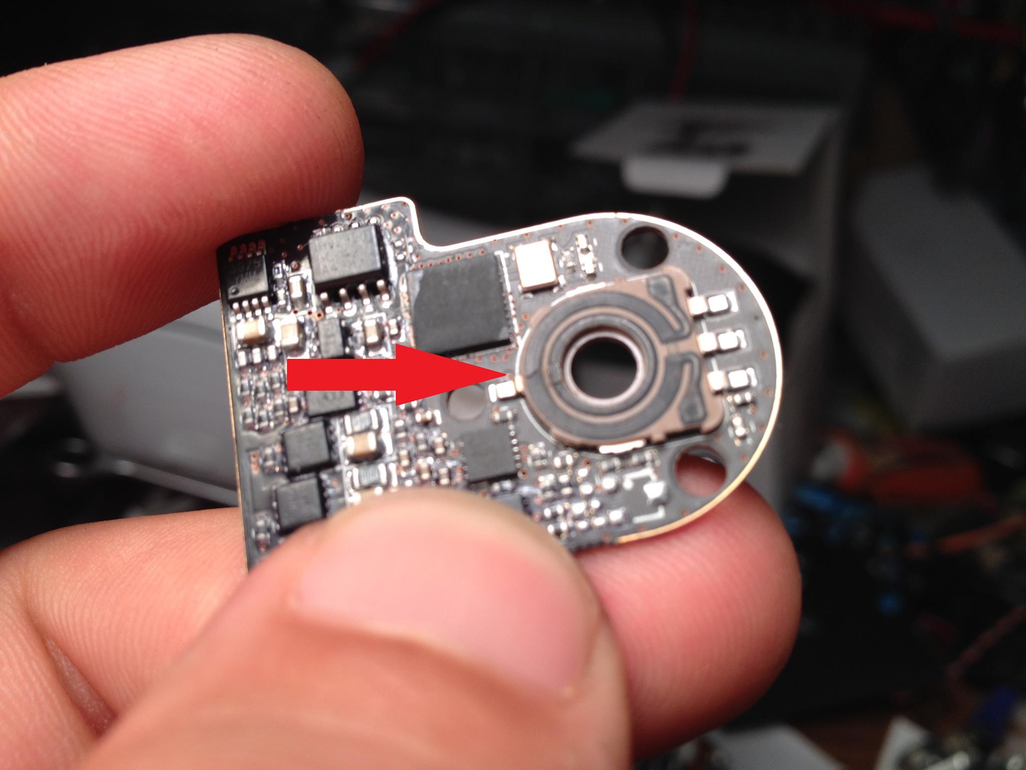

Check the condition of the rotary sensor.
Remove the plastic cover my carefully prying it off and check for any cracks or damage.
This is a what a good sensor looks like -
(note - no cracks, smooth surface)
These are 2 examples of faulty sensors
Second image courtesy of Jeremy @ USdronerepair.com
