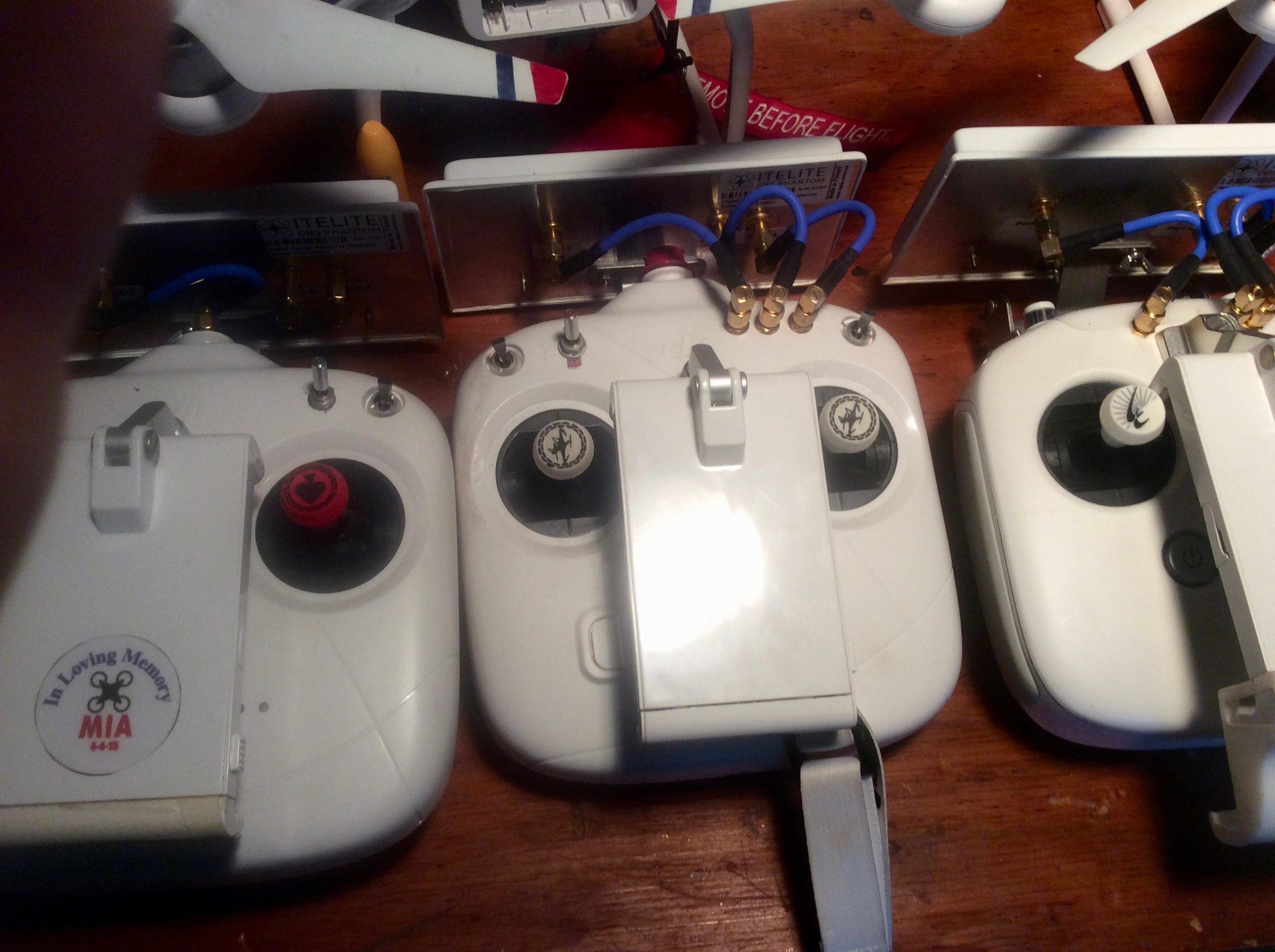

What I came up with that worked the best for me was like I have on 3 of mine .
Just do a search on you will find many threads on it . These are my P2V-Standard and P3 4K
I also use the thicker cables after trying the ones that came with the extenders and found them to get me the best range .Holes are on the back side of the P2V TX and these also have the Inspire device holders added .

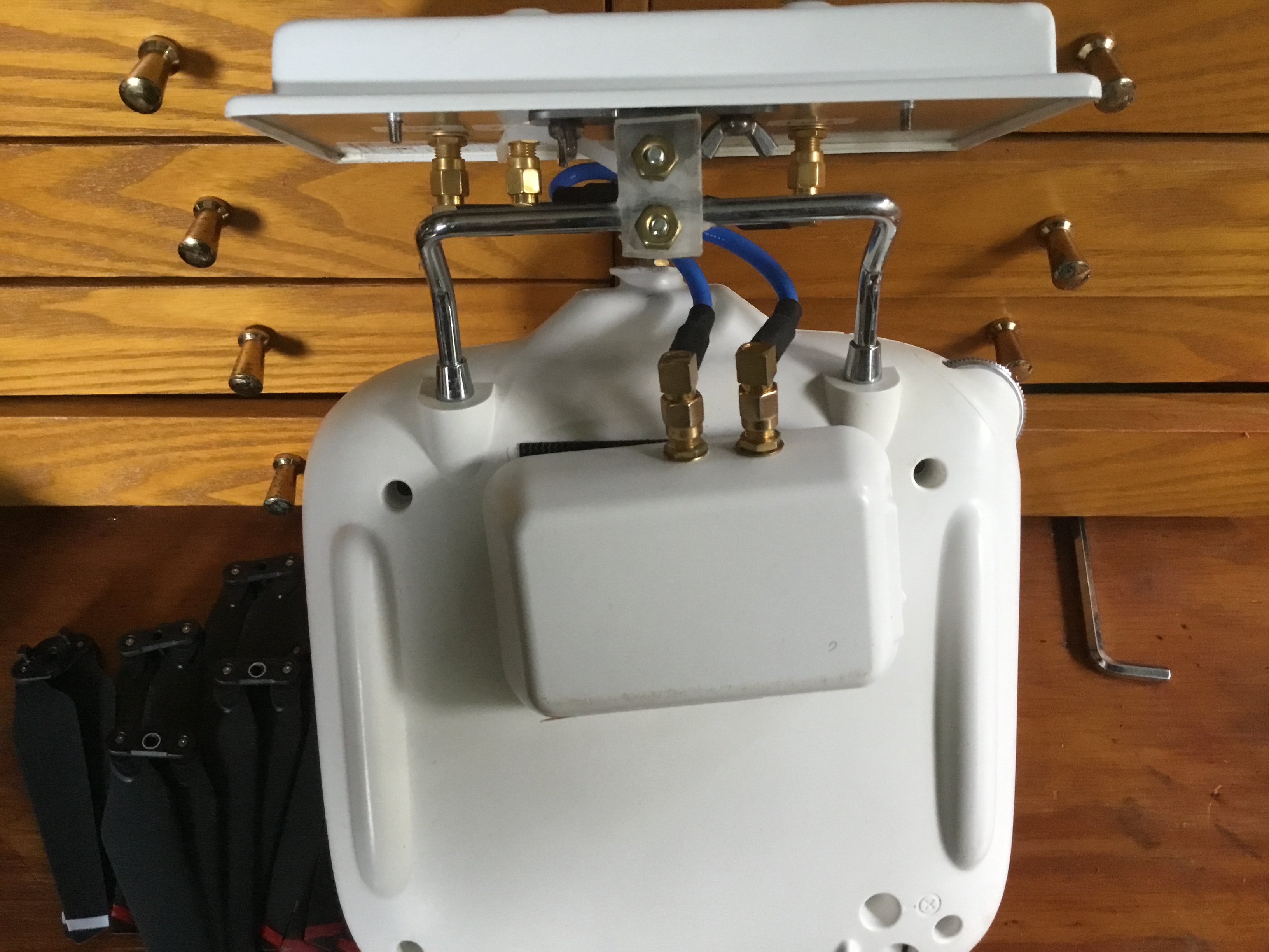

Top on the Standard and other. Reason for the other is the P2 has a extender which i mounted on the back so was just closer doing it there with that one .

itelite panels on all 3 and that last picture is the P2V RE700 I just have it mounted on the back .
