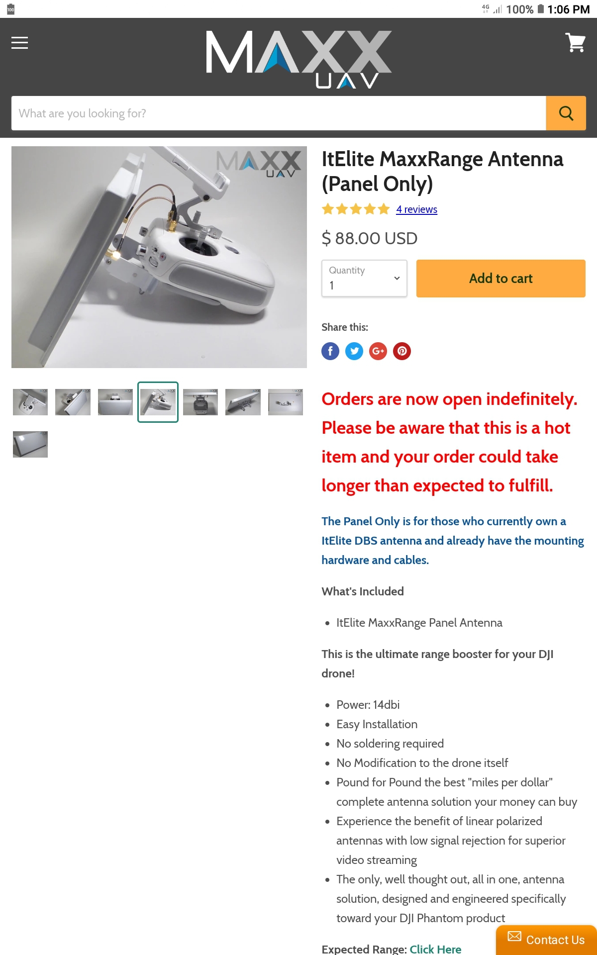

Could try a panel..these are awsome....good for better range and image free problems,,got one on the p4 and swear by it,,I'm not one to fly into sunset but do like to have trouble free flights,,,,my p3s has triple argtec anttennas but they pretty sad ,,bit like proton..this pic is just the panel but can get the full kit

Could try a panel..these are awsome....good for better range and image free problems,,got one on the p4 and swear by it,,I'm not one to fly into sunset but do like to have trouble free flights,,,,my p3s has triple argtec anttennas but they pretty sad ,,bit like proton..this pic is just the panel but can get the full kitView attachment 117790

No, don't be sorry. Antenna upgrades are a good thing usually. But in this case that's not going to help resolve the root problem. Something else is going on that needs solved. Once that's solved, then an antenna upgrade is a viable option, and that often helps to extend range more, at the price of the inconvenience of not having folding antennas for easy storage, but often worth it.
