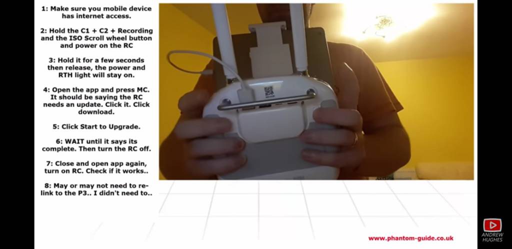

I had this problem and had to force reinstall rc firmware. That fixed mine
How do you do that? I put the Firmware on an SD, turned on the AC while pressing the sync-button, waited for the beep, had it do a full reinstall of firmware, still have the same problem.
What did you do for a process?
Just google or youtube the process. There alot of info on it. You hold a series of buttons down at the same time.
This is for the RC firmware, not the Aircraft. The RC must be changed via the app. The SD card is only for the aircraft. Below RC version 1.5 I believe uses an SD card. Do not have the aircraft powered up while installing RC firmware.
