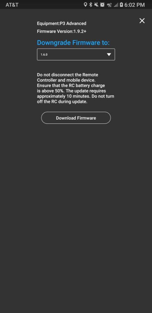

HELP - P3A thinks its P3P
Screen Shot Attached

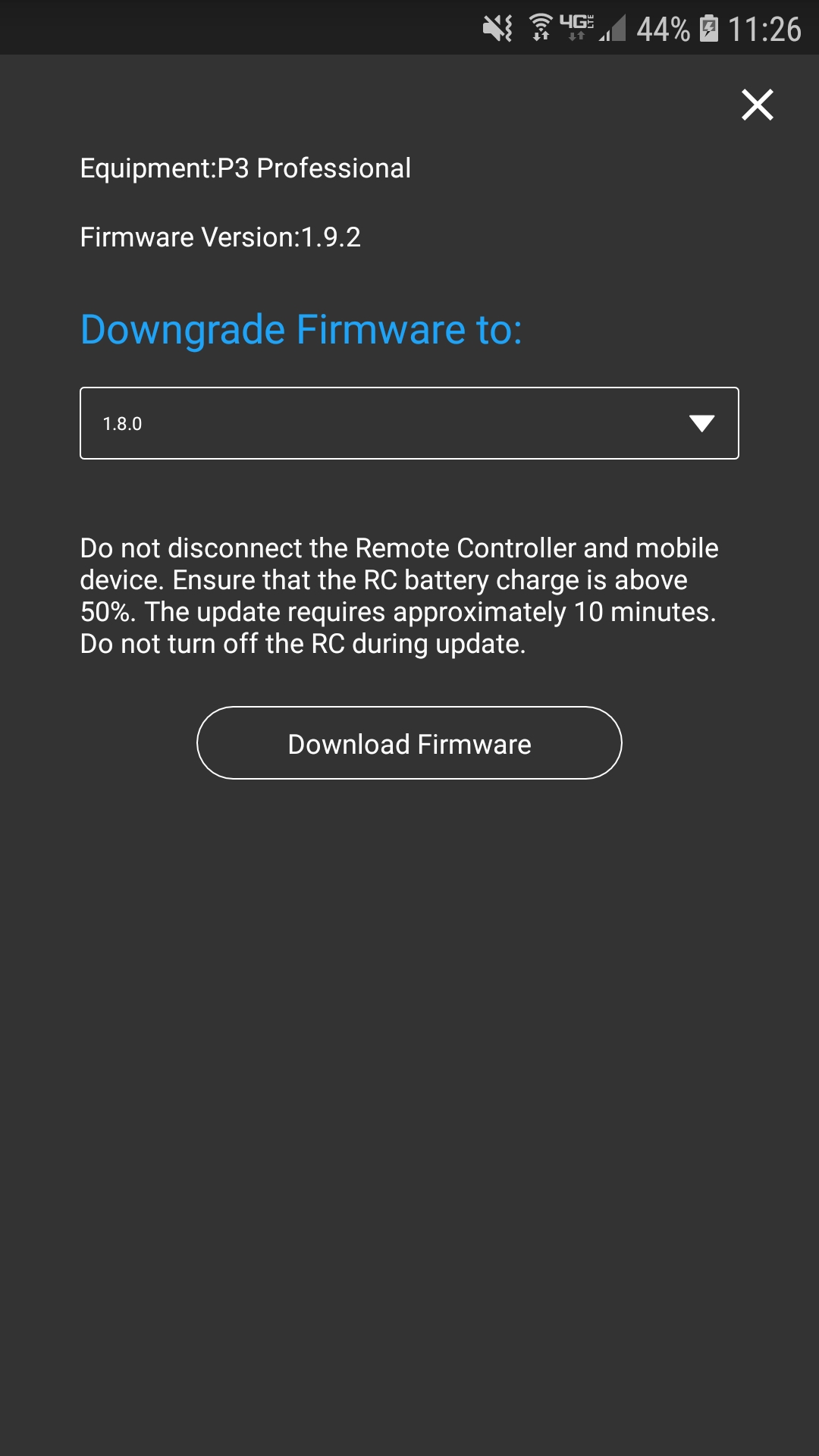

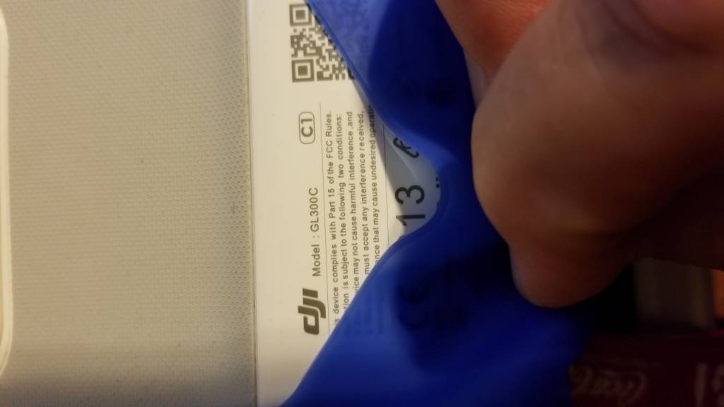

Sorry for your trouble , but thats what mine was saying also. My rc is up to 1.9.3 now. I almost want to ask what does your drone sticker say but i know youve problaly checked that already. Ill look at mine again when i get in from work. Dont want to stir you wrong.

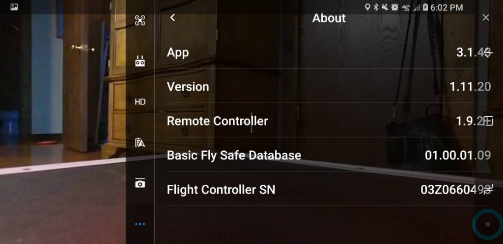

That all looks the same that I was looking at I'll still check my equipment when I get home and get back to you.
