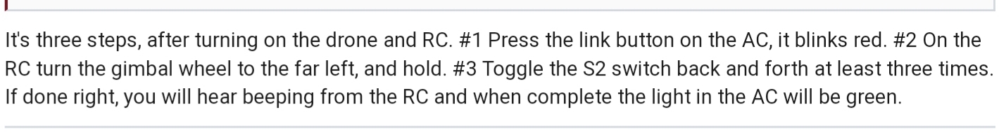

Try this linking process first..this is linking with the app
Reactions: Capt KO
i tryd--> wth rc on, pushed in and held th 2 buttons on bak of rc while flipped th switch on th left sevral times....no change.
(shuld th ac be on during this? and aftr flipping switch i then pushed link button on bottom of drone and that button startd blinking red and but nothing else changes. no green lites. shuldnt resettng th controller make it com up in wifi network list on my phone?
th wheel doesnt stop wen i turn it either way. that process isnt for th dual antenna controller for th p3 4k. is it?? it dont work.
