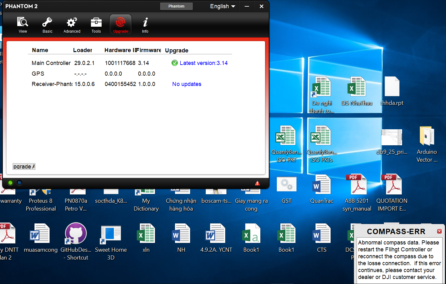

My phantom2 can see GPS and compass, I don't know that Gps and compass are false.
Who is mode GPS, compass other factory into Phantom2, please give me advanse.
Rgs.
Reed.

The GPS unit is screwed into the top of the shell and there is a cable from that unit which plugs into the main board. The antenna for the GPS is made of ceramic and place on the reverse side up against the top of the shell. In case of a severe crash, the antenna can be broken. Now if the GPS cable disconnects in a crash the P2 will not start. The same thing applies to the spring loaded pins under the battery terminals if one or both does not make contact with the battery.

A cracked or broken GPS antenna will not stop the motors from spinning up only the two cases I mentioned.
