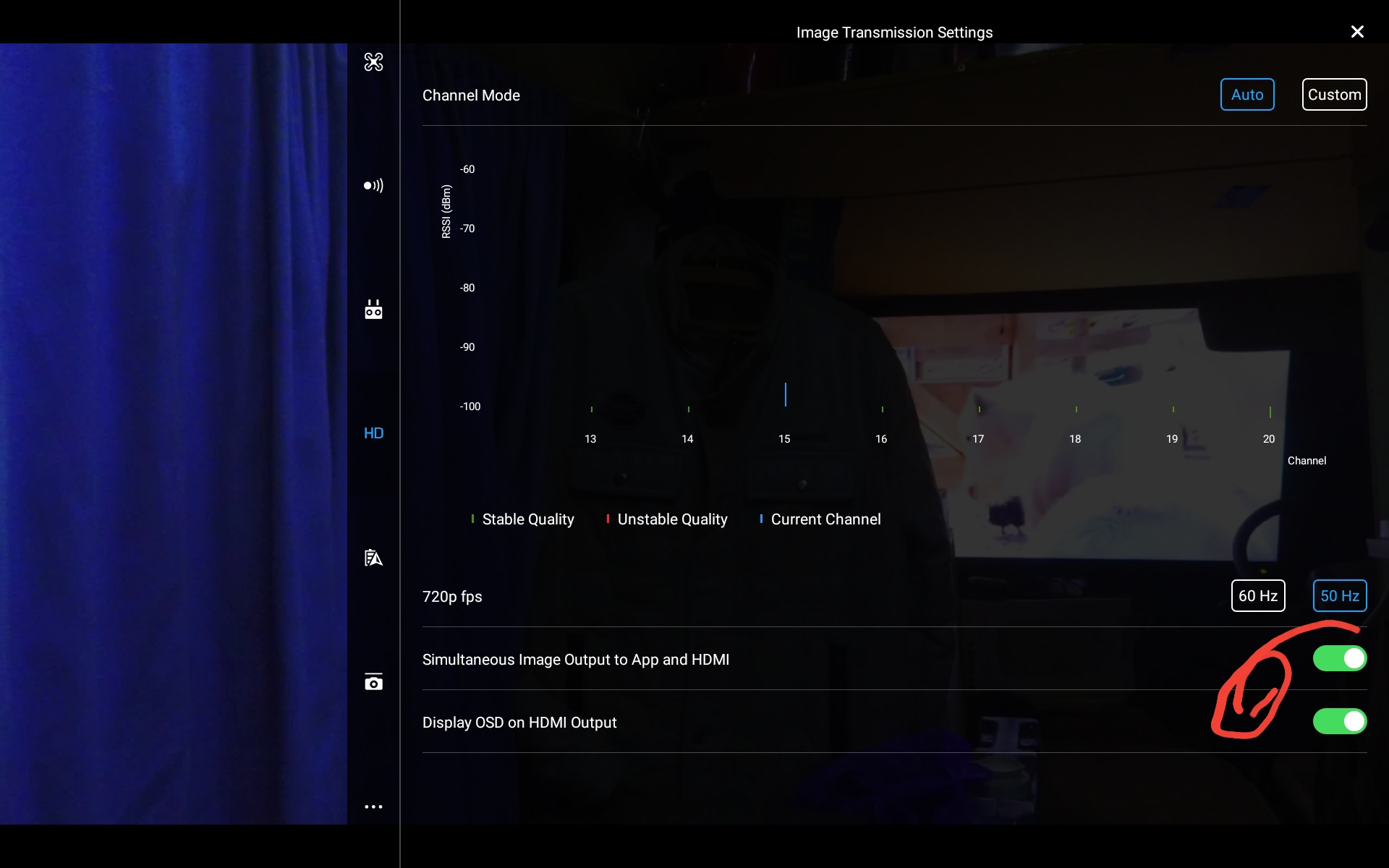

It's in HD under settings,,it wont show unless all powered up,has option to display for 2 devices

This what I see with go4,is this same app,,,,if you have hdmi adapter plug which allows the hdmi lead they supply fit the updated module,,then plug small micro end into goggles charging port into hdmi adapter and another device will run to view,,either tablet or TV in the car running off power inverter

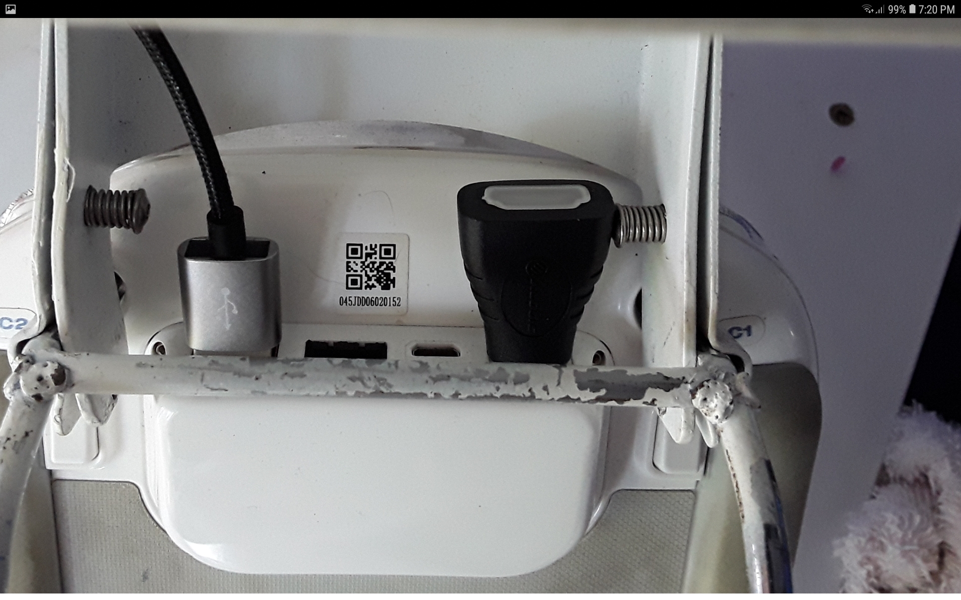

Here's how mine set up but no longer use goggles, remember to use a seat so dont fall over nothing or goggles fall off your head or get hurt,,,this little plug is hdmi adapter which allows the hdmi cable to fit because dji has used the large cable which dont fit the remote without this plug
Here's how mine set up but no longer use goggles, remember to use a seat so dont fall over nothing or goggles fall off your head or get hurt,,,this little plug is hdmi adapter which allows the hdmi cable to fit because dji has used the large cable which dont fit the remote without this plugView attachment 119589

This what I see with go4,is this same app,,,,if you have hdmi adapter plug which allows the hdmi lead they supply fit the updated module,,then plug small micro end into goggles charging port into hdmi adapter and another device will run to view,,either tablet or TV in the car running off power inverterView attachment 119588
Update I reinstalled the HDMI today all is working I now have the option in djgo 4 hooray
