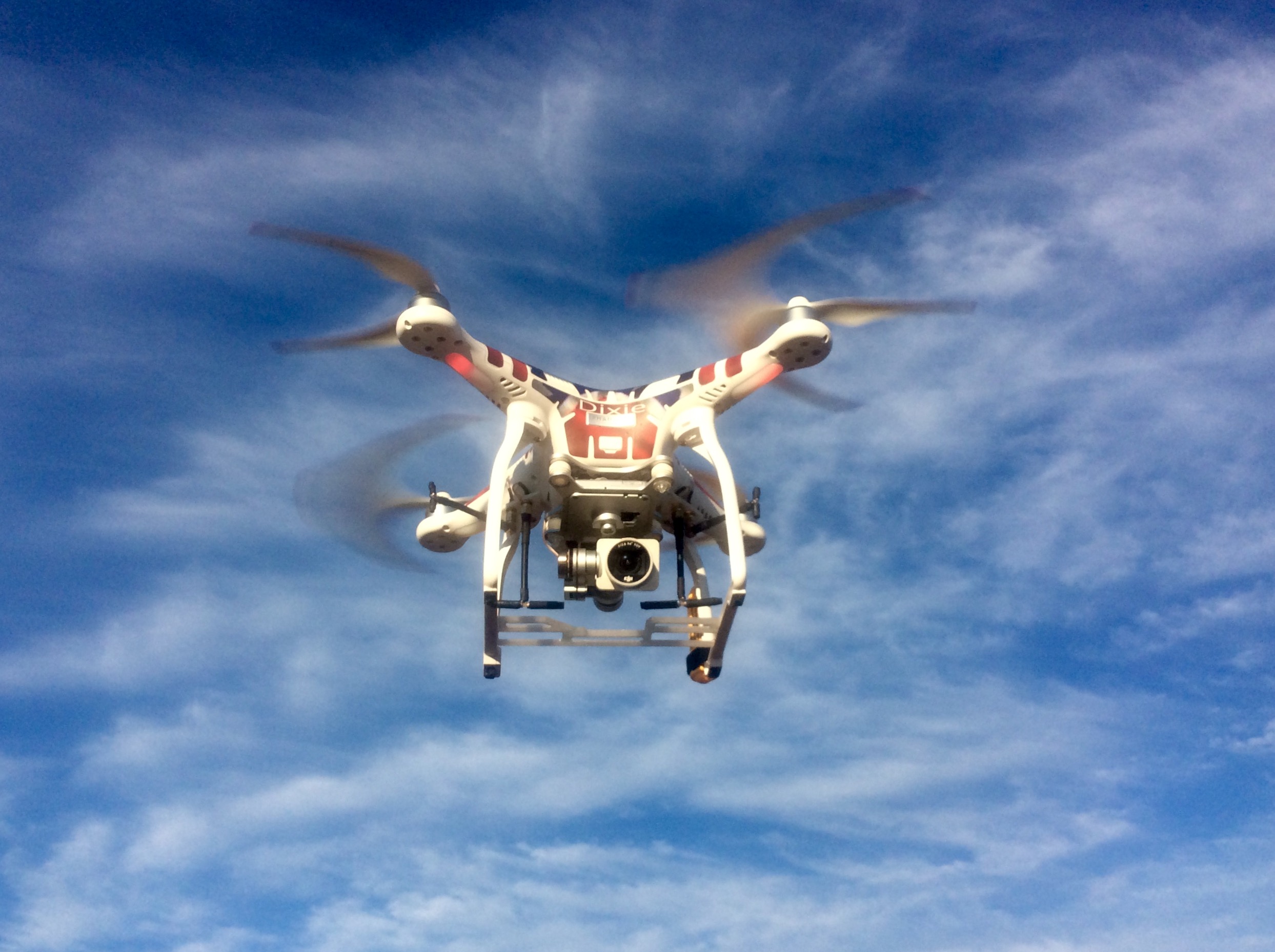

That's what I have on my Standard and works good .Took er out today .Have my 5.8's where I can spread em out to go long or just leave em in for short . We had blue sky's today and just had to get out . My other will be back Tuesday .
ie.jpg I had him make mine the way you see them .

View attachment 56543 I had him make mine the way you see them .
Surprised you pointed them straight down Dirk its been proven they dont get great reception unless the face straight out w/ the arms facing top to bottom like your other two
Tried everyway I could db and that's where I got my best . Went through 2 sets of em being made differently and that's just what worked for me here .
I thought Tony said to have the antenna at an angle not parallel with bottom landing gear.
The main stem of the dipoles pointing straight out from the bird with the arms pointing north and south or top to bottom of the bird with it being no more than 30% deviation from north to south is what Tony stated publicly and privately to me, and what I found in my own testing to be ideal for extreme range
Ok I seen a picture with the main stem bent down and the two arms running parallel with the landing gear. I thought Tony that would work if you were overhead but should be at a slight angle.

Tony told me It wasn't right .Might not be but this was the best I got and just quit testing .

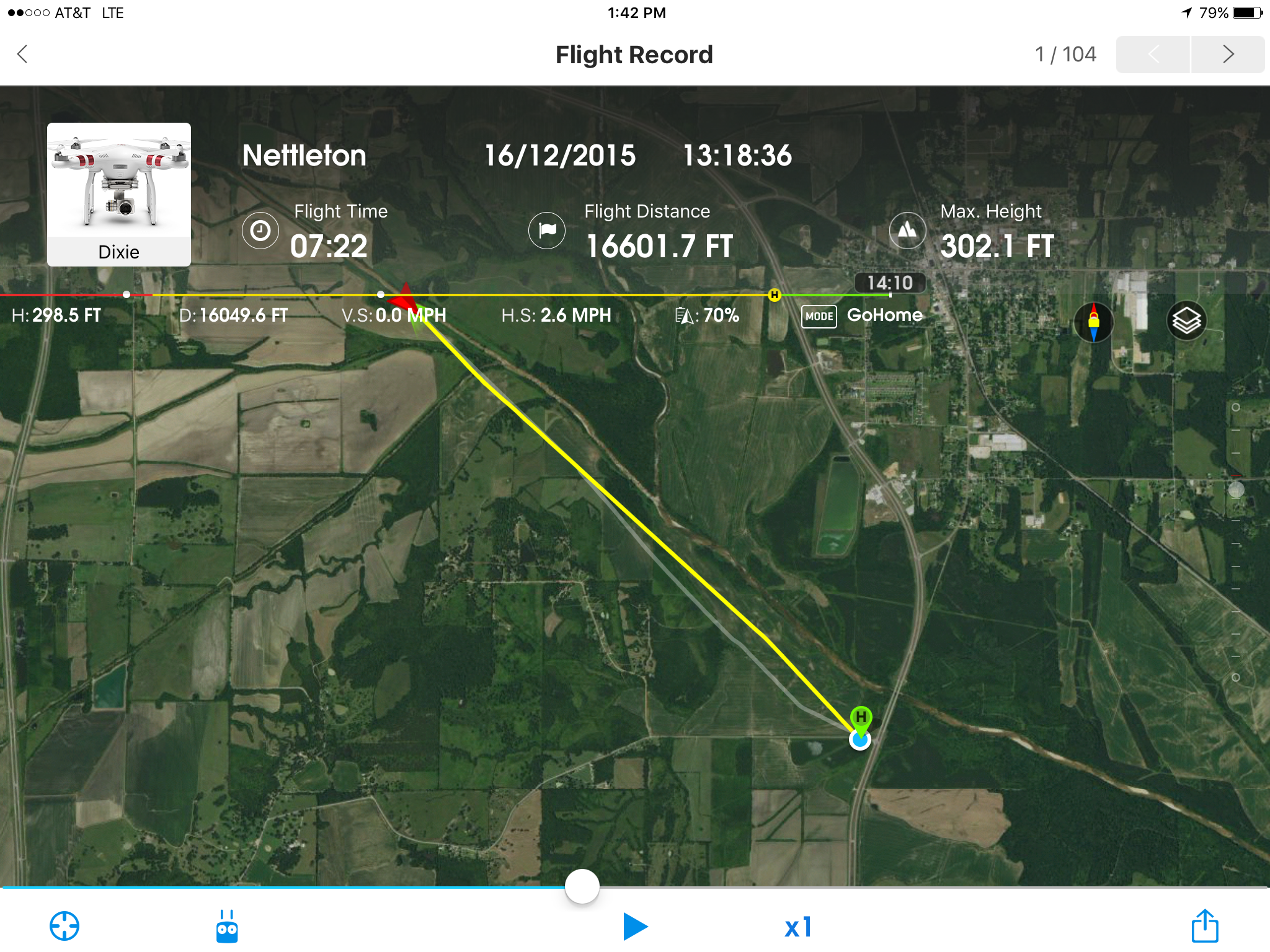

At 70% I hit RTH
3.04 miles.PNG Now what you see on mine now is longer than what he has now on the 2.4's .
Ordered a set and they came in short .He has since changed the picture on his site . I just sent him the short ones back .

At 70% I hit RTH
View attachment 56611 Now what you see on mine now is longer than what he has now on the 2.4's .
