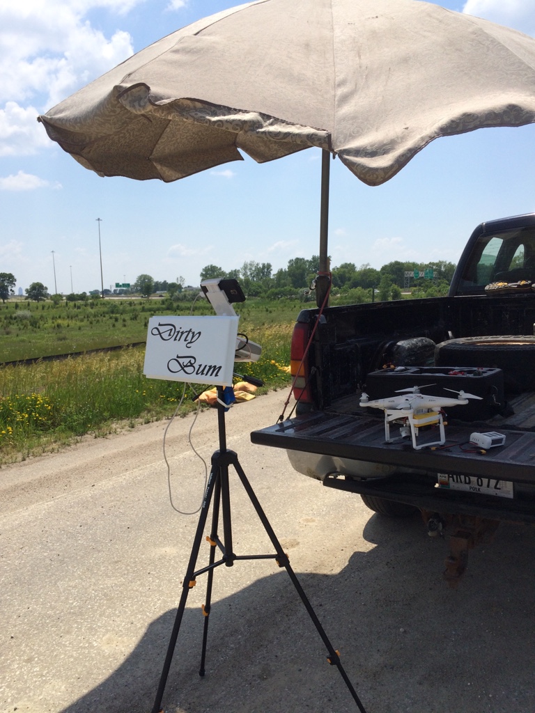

we have used 10 x 10 canopy. but even then if the temperature 119 degrees how fast will the battery reach 140 degree's. What temperature does the battery go terminal and maybe blow up that would be a good video, costly.

Had to makeshift some shade thoughView attachment 57061

I suppose if it's 119° out it's not gonna take long for your battery to go above 140 which will cause a lipo to fail if it goes much about that and I wouldn't be surprised if most smart batteries wont even fire up the engines
I know my engine does not like firing up at 119 degrees :D
