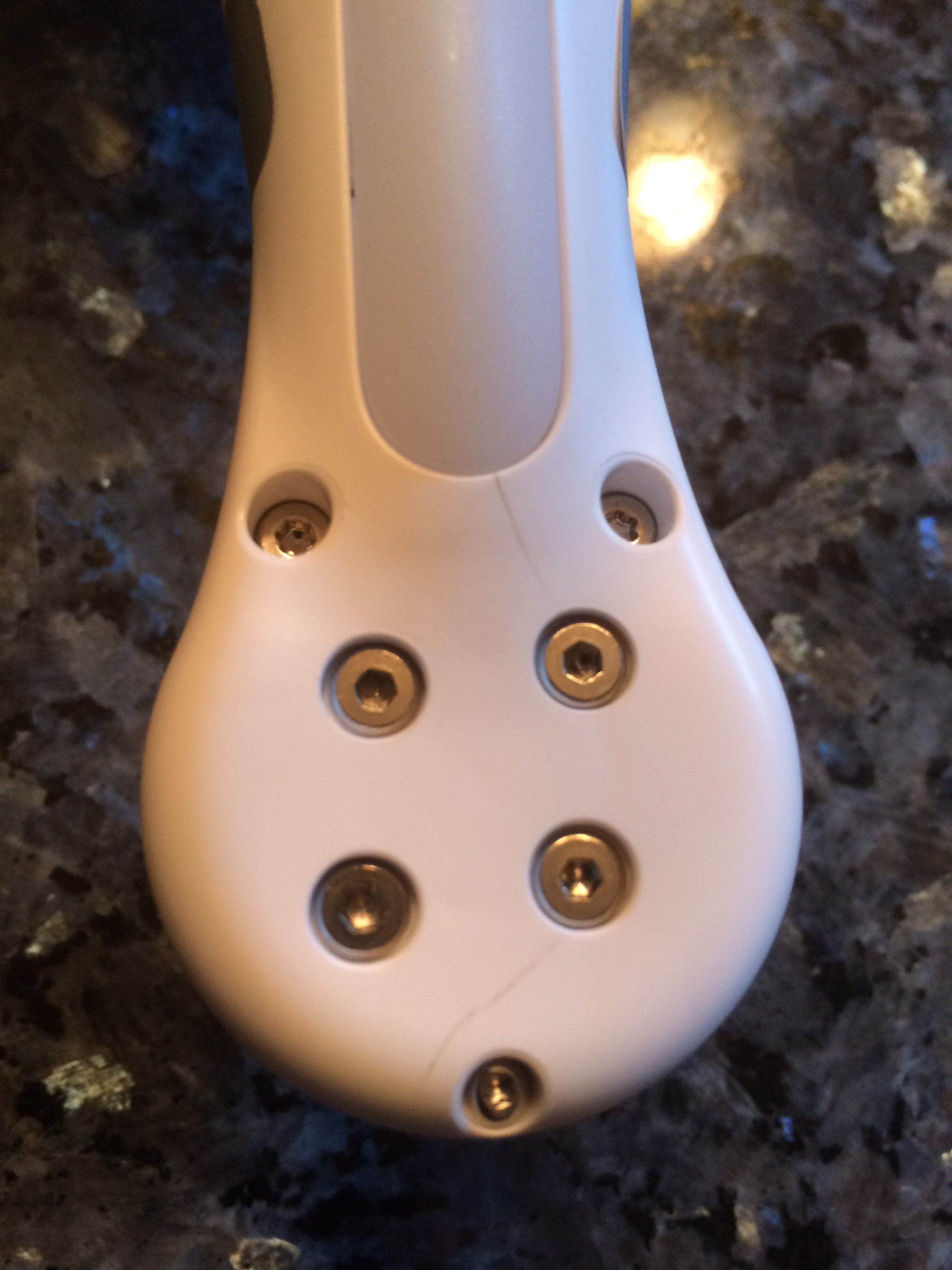

Never even fired up the motors on the replacement unit. Cracks were there when it came out of the box !!
Ok, I am so disappointed. New unit just out of box. Never flown. So all of the people saying this is not a problem are drinking the DJI KoolAid. I'm out. Will be returning for refund, not replacement. I'll wait till the problem is solved for real before I get back into the game. View attachment 36585

Overtorqueing the screws? Yes that can crack not only the P3 shell but ANY plastic part. I myself doubt that one too though, I´d say it´s pretty hard to achieve that much torque needed to crack it with such small and fine-threaded screws, even the torx type. As with most other P3 parts the shell is quite well engineered, so I´ve narrowed it down to the manufacturing, possibly plastic mix / injecting issue. That´s my opinion anyway.
But these look different than what others are reporting. They don't look fatal, but...
This is a 2 week old unit with 1.5 hours of flight time, no crashes, not even a hard landing.
It is a new unit with the new shell and new motors.
My brand new Phantom 3 with the new motors has cracking after just two flights with nothing but feather soft landings. It looks like my vendor is going to put a new shell on the thing they issued a return label immediately. And by the way I am not even an aggressive pilot, no erratic moves. I can only hope the replacement shell does a better job.
