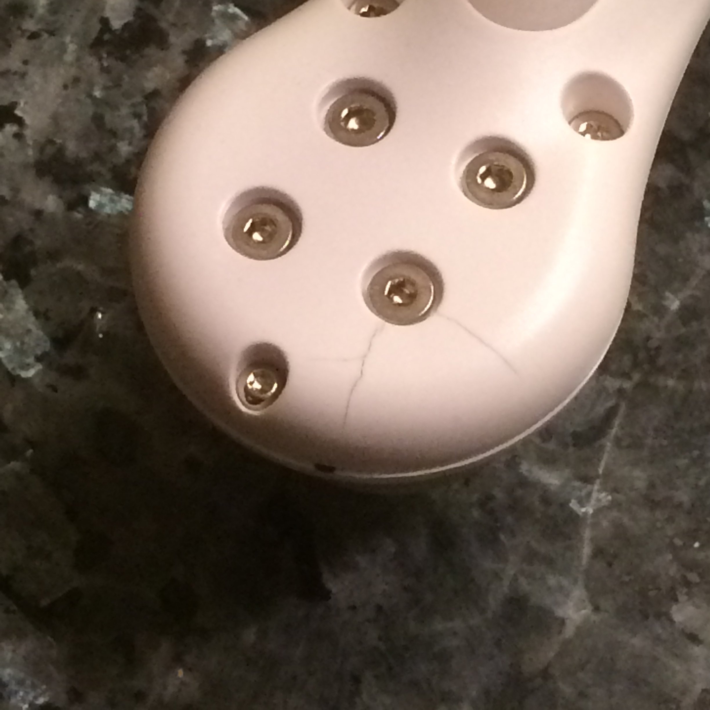

Ok, I am so disappointed. New unit just out of box. Never flown. So all of the people saying this is not a problem are drinking the DJI KoolAid. I'm out. Will be returning for refund, not replacement. I'll wait till the problem is solved for real before I get back into the game.

Ok, I am so disappointed. New unit just out of box. Never flown. So all of the people saying this is not a problem are drinking the DJI KoolAid. I'm out. Will be returning for refund, not replacement. I'll wait till the problem is solved for real before I get back into the game. View attachment 36585
As time passes, we see more and more shell crack cases. This means that the issue is not yet resolved and the theory that it was a batch problem is not correct. It is also true that every one is not facing it. Does any one know the true cause of the problem? DJI has design experts, is it possible to get a feedback from them and avoid guess work.

Ok, I am so disappointed. New unit just out of box. Never flown. View attachment 36585
I'm not a crack expert or physicist but to me, and given that this bird has yet to be flown, these look like they were caused by over torquing the motor screws at the factory. This almost seems worse than a bad batch of plastics because it's simply human error that made it through the QA process.

I guess you didn't read the thread. This is a brand new P3 with new motors and shell. Arrived with cracks. My previous one also was new motors and shell. Cracked within 2 weeks. So you don't know whAt you are talking about!
Your brand new P3 came with cracks? Is there no QA to inspect before packing or it cracked during transportation? I'm slowly coming to a conclusion that issues are mainly due to poor QA. Cause could be poor material, poor design or poor manufacturing processes but they are slipping through QA hands.
