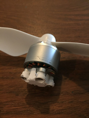

View attachment 48689 Look at this this is the new improved shell???? I am getting so tired of this problem.this is the 3rd shell.
It sure looks like the crack is related to the reinforcement plate mounting screw. Maybe the screw is too long?
IMHO the reinforcement plate mod is absolutely necessary - not to stop cracks but to prevent the motor from totally separating from the arm!
Is this a detached motor with a reinforcement plate? I'm on the fence and thinking about getting them. All these stories about cracks have me nervous when I fly.
