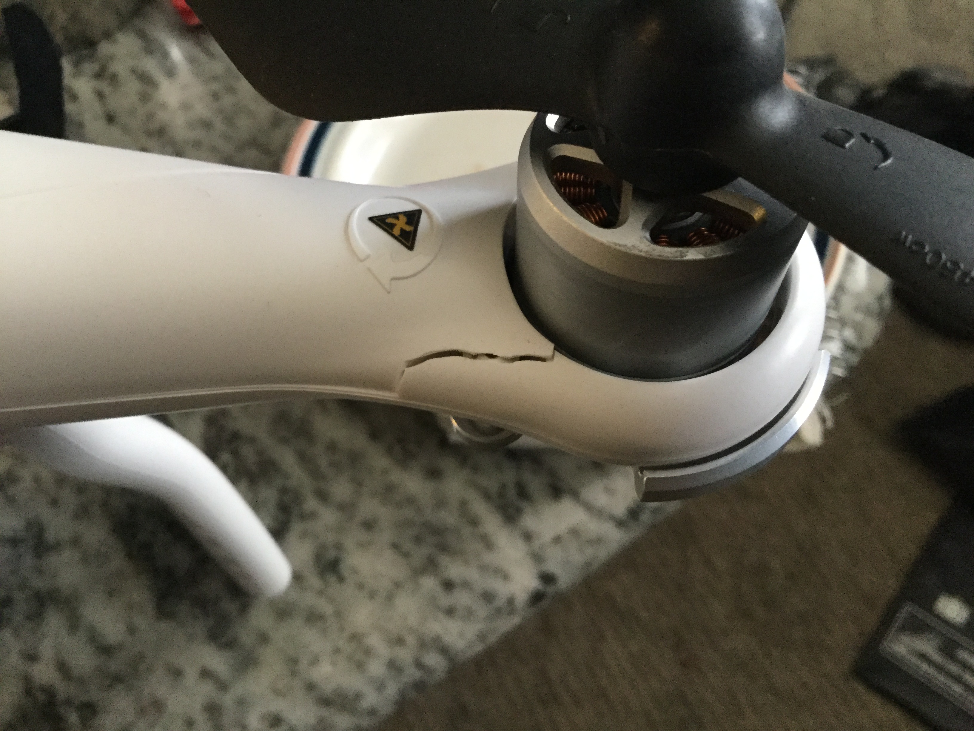

Look at this this is the new improved shell???? I am getting so tired of this problem.this is the 3rd shell.
Looks like you the arm reinforcements from infinity hobby, the aluminium ones?
I was planning on getting those but was wondering if they are so strong that they simply transfer the stress to another area?
Loos like your crack is directly above one of the screws. Did you screw it in too hard by any chance?

Yes I think that might have been the cause.i have loosened the bolts see if that may stop the cracking???
I doubt that loosening the bolts will do any good. In fact it may cause extra stress due to motor vibration on a loose mount. I also noticed you are using CF props. I have nearly 100 flights on mine with one crash into a rock wall that dropped the P3P about 20 feet to the ground - and survived without damage other than two props thanks to some grass and sage. No cracks or any other she'll damage. I only used CF props for 4 flights, but stopped because of the jerkiness and lower stability in gusty wind conditions. Much more difficult to soft land with CF props. Not worth the extra risk.
Thanx for the info I use CF props becoz I use a battery mod it's about 450 extra grams of weight Need strong props.extra weight does make it stable in the wind.i always had catch I don't like to land it do to all the dust.the cracks came from doing hard maneuvering and yes over tightened bolts.i only loosened the 2 body bolts.i have used bondic around the inside of motor pods to reinforce the body.and only the top shell cracked so I do have 2 extra top shells from replacing the other first generation of P3 bodies.it was an easy fix.how ever if this problem occours again I may not use the strong arms.but really I may not fly so aggressively what a shame.....

Sorry to say I have had 3 shells crack glue does nothing once cracked it always cracks.i have used crazzzzzzy glue,hot glue,bondic still cracks it's just a band aid!!!
Use plast-aid, I used it on my cracked shell.
I do all big, long, hard flights and no crack spread with this product.
Even reinforced the arms underneath the motors with it.
Magic stuff.

View attachment 48689 Look at this this is the new improved shell???? I am getting so tired of this problem.this is the 3rd shell.
Never seen one this bad.
All 3 of the phantoms I had suffered hairline cracks, but this looks almost like crash damage to get into that state.
Did you ignore the hairline cracks or something? This just happened like that?
