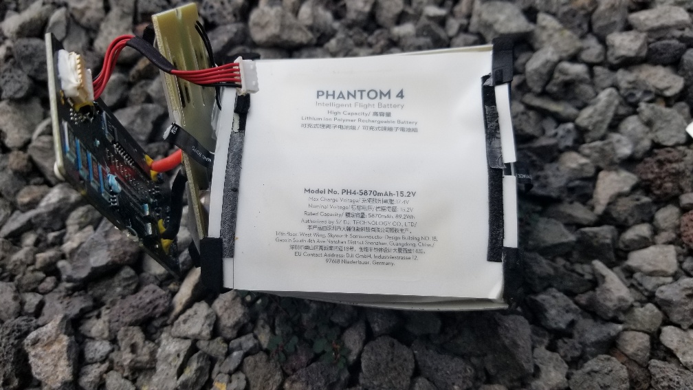

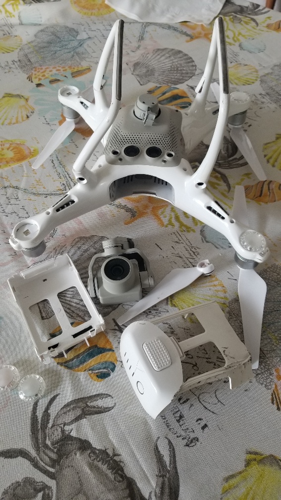

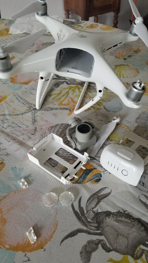

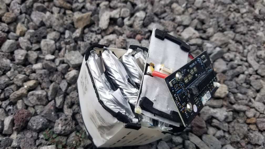

Well, after 230+ hours of flight time and over 10 million feet travelled, I just had a "permanent disconnect event". Flight going fine until a very brief 'high wind' warning (on a rather calm day) then it disconnected, never came home, never reconnected. Found the carcass and it's likely a total write-off. I don't have a lot of time as I'm off to work in a few minutes but I'm hoping someone might be able to give me some insight on the failure. Flight records attached. Here's some gory pictures. Figure it has to be either the propeller snapped in half and caused the crash (three were found still attached, the fourth broken in half and loose) or the battery popped out (I'm always fastidious about ensuring the battery is firmly installed). Leaning towards the latter in this case though, based on the condition of the battery it looks to have fallen without the protection of being inside the bird. See pictures. Let me know what you think, I'll be back soon to answer any questions. Post Script: the crunched battery is currently outside in a salt water bath to discharge it.
Can battery swelling cause the battery to push itself out of the drone???
I always thought with the encasing of the battery pack inside the drone that you wouldn't have an "ejecting battery pack" issue if they swelled excessively during flight. I always though that if you had excessive battery swelling while in flight it would lock itself inside the drone and potentially damage drone internals, but not "eject" itself.

True but batterys dont swell every flight,thankfully,,not sure if battery in picture has swelled due to the impact it has been in,sure is nasty
Well, after 230+ hours of flight time and over 10 million feet travelled, I just had a "permanent disconnect event". Flight going fine until a very brief 'high wind' warning (on a rather calm day) then it disconnected, never came home, never reconnected. Found the carcass and it's likely a total write-off. I don't have a lot of time as I'm off to work in a few minutes but I'm hoping someone might be able to give me some insight on the failure. Flight records attached. Here's some gory pictures. Figure it has to be either the propeller snapped in half and caused the crash (three were found still attached, the fourth broken in half and loose) or the battery popped out (I'm always fastidious about ensuring the battery is firmly installed). Leaning towards the latter in this case though, based on the condition of the battery it looks to have fallen without the protection of being inside the bird. See pictures. Let me know what you think, I'll be back soon to answer any questions. Post Script: the crunched battery is currently outside in a salt water bath to discharge it.View attachment 121182View attachment 121183View attachment 121184View attachment 121185
Wow that just sux,,been there,,good thing you at least got it back,you still got remote so hunt a cheap p4p down,,,hard to say what's gone on without log file,,,,I think you post wrong one,,,was the battery far from drone or look like it pop out on impact ?,,disconnect or power loss might occur if battery comes out in flight,,something happen before the disconnect happen if you got false wind warning ????yip I'm curious
Hmmm, not sure why the log file would be screwy, only did one flight today and that log bears the correct date stamp. Just pulled the .DAT file from the tablet, I'll attach it here, perhaps it'll have some usable data. I haven't tried powering up the craft with another battery yet to see if I can salvage a .DAT file from the bird. As far as the orientation of the parts, unfortunately by the time I reached the drone some construction workers were already gathering the parts up so I didn't see the complete aftermath.
Here's a summary of your flight data:
It doesn't show what the cause of the incident was but it helps eliminate the battery's state of charge as a suspect.
It also shows you flying fast but without any sudden changes of speed or direction that might have dislodged the battery.
It looks like a sudden loss of power, but whether the cause was in the battery or the Phantom isn't shown.
