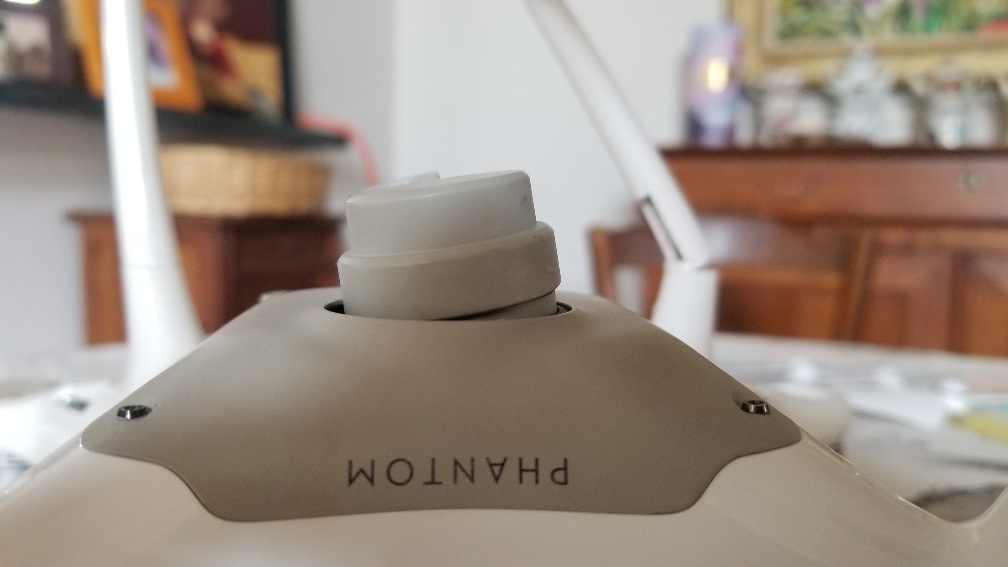

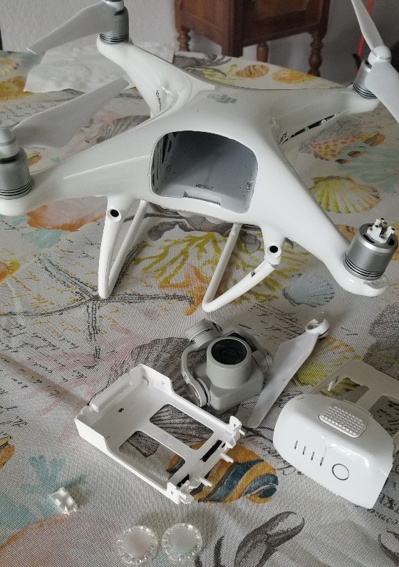

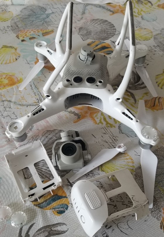

My P4P fell out of the sky from 200' yesterday, debris and flight log point to the battery popped out mid-flight. I'm trying to get a feel for whether or not it would be worth it to send it in to DJI for possible repair. I've heard encouraging stories of getting near-new replacement refurb drones for just a few hundred dollars, and contrasting stories where a drone is sent to DJI for a simple single fault and they return a laundry list of problems that the owner wasn't aware of. Gory pictures below. Obviously damaged components are the main body top and bottom, gimbal arm and ribbon cable snapped, landing gear bent, Nav light bezels popped off. The camera itself doesn't appear to have taken much impact but the yaw motor that's till mounted in the underside of the body is noticeably bent to one side. And obviously the battery was toast and the props damaged, but those aren't really going to be part of the quote for repair.
I'm guessing I won't be able to receive a ballpark quote from DJI based on pictures alone, or am I wrong? I mean, if they can look at pictures and say it'll probably be $1000 then it's obviously not worth the effort to repair.
How does DJI handle shipping costs once a repair ticket is opened? Would I need to cover the cost of shipping either or both ways? I'm out in Hawaii, so shipping a box that size would be fairly costly. I'm worried the repair bill will be too high and then I'll need to pay an inflated shipping rate to get the carcass back. If that's the case I may be better off parting it out rather than sending it to DJI in the first place.

Short version: You have nothing to lose by sending it to DJI. And you might be pleasantly surprised by the cost and quality of the repair.
Contact DJI's repair service. They will typically ship free to and from their service center. You'll get a quote, based on what parts are broken, plus a flat labor fee - I think for a P4Pro, it's about $150 plus parts. Most people, including myself, have been pleasantly surprised at the repair prices. The prices they charge for parts is about the same as, or better than you'll find anywhere online. That's a happy / unhappy lesson I learned, after buying a lot of parts.
They'll send you instructions and what you can or can't send back to them.
Looking at your pictures, don't be surprised if their quote comes back around $300. And, don't be surprised if what comes back from DJI is a brand new (or factory-fresh refurbished) drone. When I sent the thoroughly trashed and dismantled (parts missing) X5 camera for my Inspire 1, the quote was less than $300, and what looks like a brand new camera came back. The whole process, from contacting them, to having my 'repaired' camera arrive was about 3 weeks including passing through customs in each direction (New Brunswick, Canada to California and back).

Send an email to the DJI service Center. They'll typically pay the cost of shipping, give you an estimate - prices are less than you'd expect- and pay return shipping back to you.
I don't have the link handy but there's a list of all the replacement part and service prices on their site. I'd be surprised if their estimate came to more than $400 but you'll have to get yourself a new battery. Based on the condition of your drone, I would also expect that you'll get a new replacement, rather than repairs.

Sent 4 drones to them over the years! Two were wrecked worse that yours. Highest price I paid was $312.00. They sent a replacement drone. For me, well worth sending it in!!
So DJI repair service won’t fix in depth issues. They will replace anything that requires soldering, advanced flashing or “gatekeeper” repair. The P4 series gimbal yaw motor assembly is what I call “gatekeeper” (the yaw motor housing is calibrated to the roll/yaw esc board on the gimbal) so the repair cap for a tear down of the old motor, salvage the housing and install it on a new coil/ribbon cable set. DJI wouldn’t do this, so you’ll just receive (and pay for) a new gimbal. Bottom shell replacement requires soldering esc motor wires. You’re probably looking at a new drone body as well. Im going to guess your quote from DJI will be around $800-$1000 plus shipping and you would receive a refurbished unit.
3rd party services (such as myself) would charge you parts plus labor and most likely repair the actual damaged components. I know it looks bad but crashes like this are common, and if there is no damage to the gimbal main board stack, your main controller or your camera housing, you’re looking at around $200 in parts plus labor from a 3rd party.
