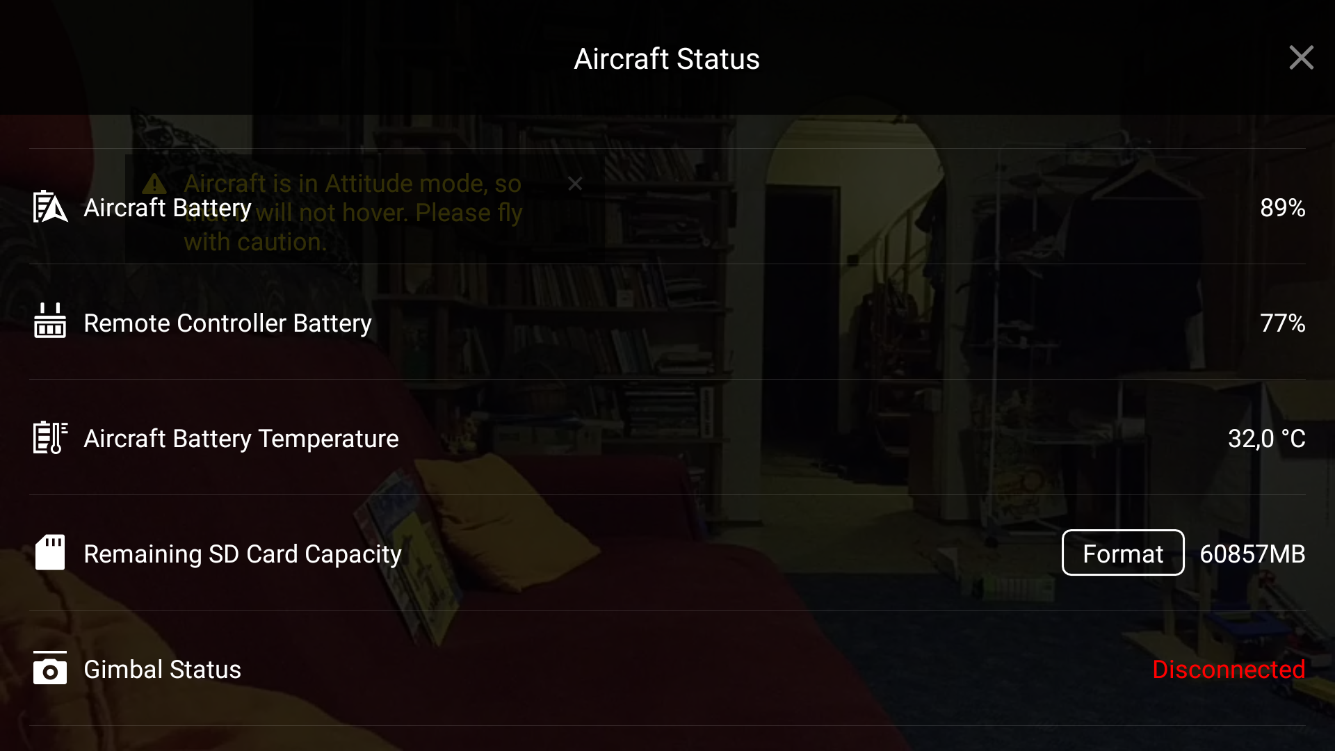

Hi, Im new on the forum, and have just unboxed my new P3SE.
It looks all things to be good, but at the aircraft status I see: Glimbal status - disconnected.
I have live image in the DJI Go app, camera makes movements at the start, an can be controlled by gimbal dial on the controller.
How can a fix the status? I restarted multiple time aircraft and controller, but it not changes.
How can I decide, if there is any problem with gimbal or it works well?

Today I made some test flights, both fpv and follow mode of gimbal works well, but the status stays disconnected...

I was told on another DJI form to ignore it as it was a firmware problem and the new 1.1.22 will fix it....My P3 SE was doing the same thing exactly
And To Ignore it... as long as you can see the FPV (first person view) on the tablet or phone that you are using.

I have the same message, Gimbal disconnected, but until I have my FPV, and I can move the gimbal scroll, I don't mind. Sometimes it disappears, but it comes back...
I have the same problem, but onley on 3.1.18 if i use the last version my gimbal is connected
In case of P3SE it's not a problem, it's just a status display bug in this app version, gimbal works perfectly.
