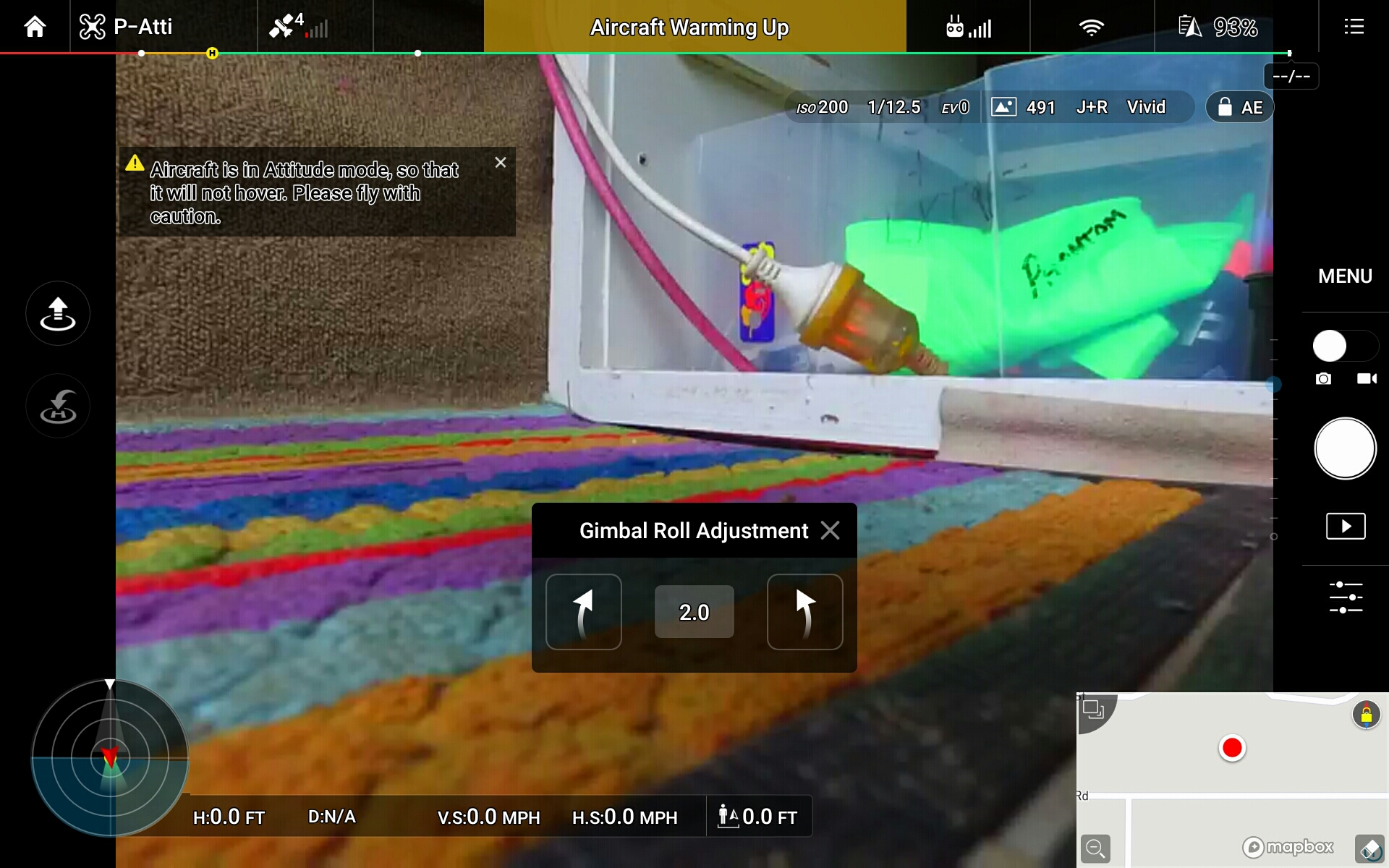

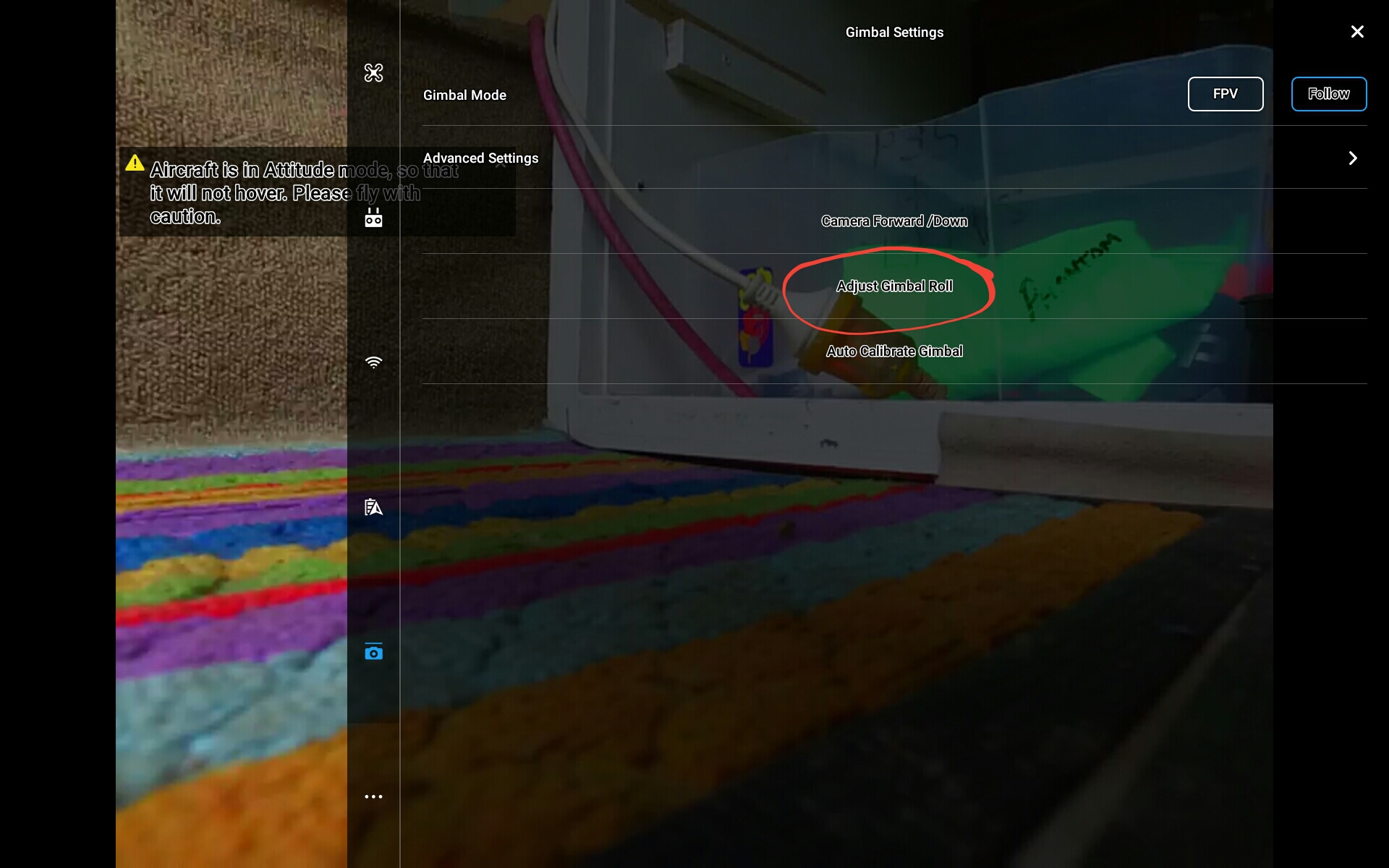

Gosh your drone busy today,,have you tryed playing with this roll setting or same result....ps mine on 2 or it sits crooked aswell could never fix it,p3s.

Gosh your drone busy today,,have you tryed playing with this roll setting or same result....ps mine on 2 or it sits crooked aswell could never fix it,p3s.View attachment 110534View attachment 110538
Thanks for the response.
Yes, I did try to adjust the gimbal roll using that method and unfortunately it doesn't seem to work. The amount of adjustment is negligible. The gimbal roll adjustment was set at 0, and adjusting the roll didn't help really at all.

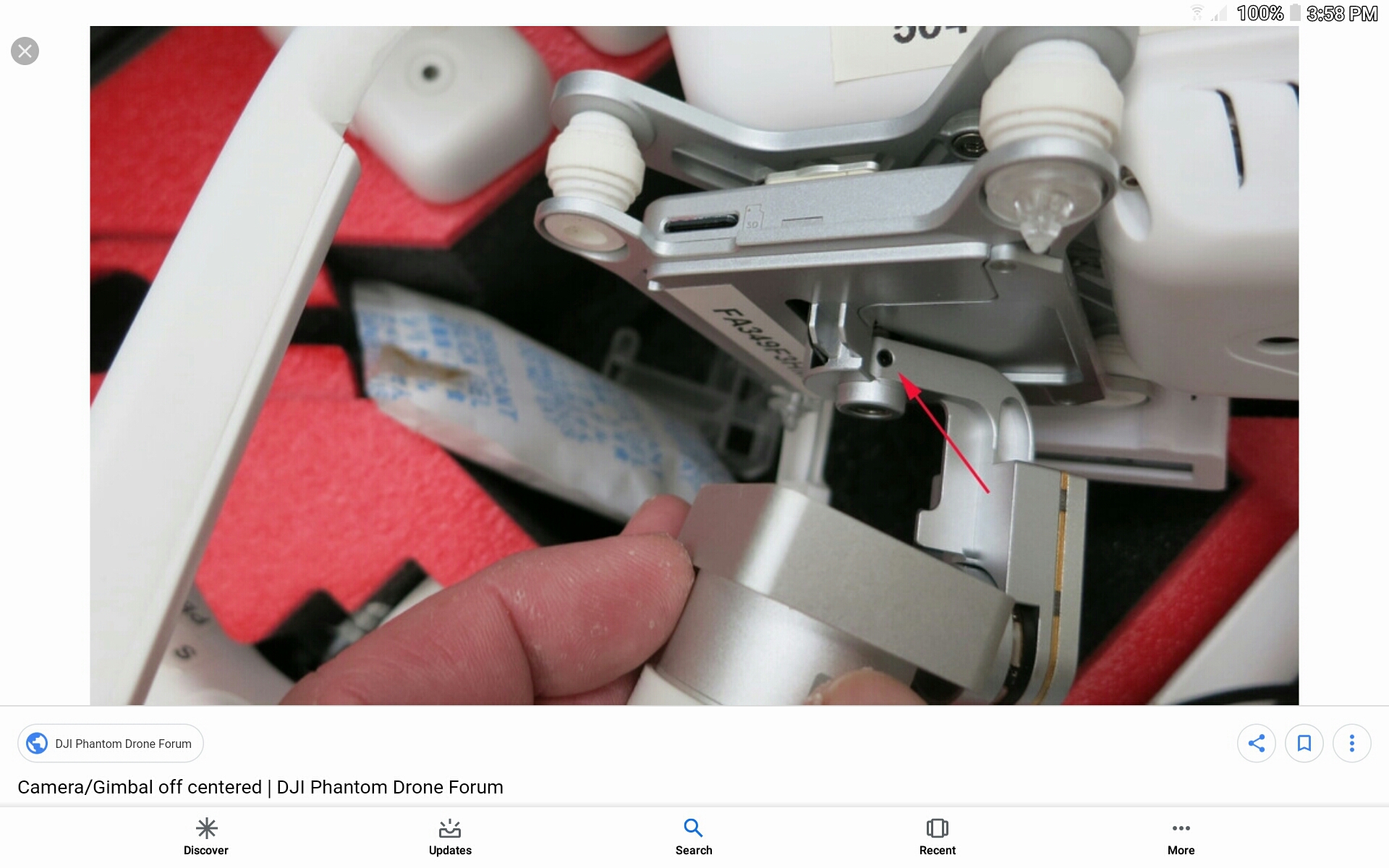

Hey found this turn all on and loosen this grub screw or is it cam that's offset,.

Hey found this turn all on and loosen this grub screw or is it cam that's offset,.View attachment 110539
If you loosen that screw - you will most likely introduce Jello .... as myself and others found that possibly factory had not 'pressed' the arm fully home before tightening. The slight gap and we are talking tiny such that hard to see was enough to cause jello.
That screw has nothing to do with roll or angle of the camera ...
Very good what screw does ,all good saying I'm wrong but without corection if was mine I twist it with plyers, how would you do it,,chap needs help here was just a idea
Fine ... I was just saying that the screw highlighted will not correct the slanted camera. It will cause Jello if slacked or altered. It has only effect on horizontal rotation of the gimbal.
I would suggest and this is only a suggestion without having the machine in hand ... that the lower part of the gimbal arm that has the 'roll' part carrying the camera may be at fault.
My P3P had a small slant to horizon for some time ... I calibrated gimbal ... played with it ... but mine was nowhere near 30 deg as the OP mentions. I just persevered and eventually it sorted out. How I did it escapes me now ...
I know there was a post somewhere a guy mentioned resetting arm alignment - but it was lower part ...
