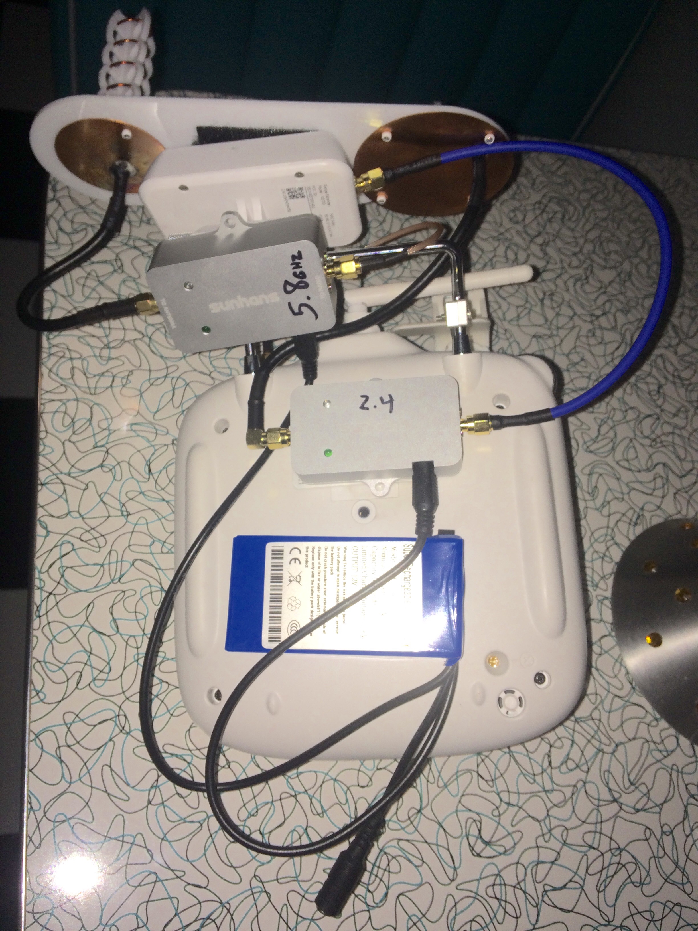

image.jpg rrmccabe I don't think it was a cables fault. I don't think I had them ran property. I'll post a picture of the back of my remote tonight. Just to be positive. Jasonnelsin I have the FPV Booster app that I'm flying with. It shows a line from your radio to the bird on screen. And I'm always keeping them lined up as best as I can. I'm hopeful that it's just the crowded area that had me shorter than you might expect. There is some farmland not too far away with no trees around for a very long ways. I hope to get down there and get the kind of range you are speaking of.
View attachment 17707 rrmccabe I don't think it was a cables fault. I don't think I had them ran property. I'll post a picture of the back of my remote tonight. Just to be positive. Jasonnelsin I have the FPV Booster app that I'm flying with. It shows a line from your radio to the bird on screen. And I'm always keeping them lined up as best as I can. I'm hopeful that it's just the crowded area that had me shorter than you might expect. There is some farmland not too far away with no trees around for a very long ways. I hope to get down there and get the kind of range you are speaking of.
Your wires look good. I like Tonys products and do plenty of installs but...... You need clean the connecting ends with 99% alcohol or wiggle the connectors. I twist each one individually when the nut is finger tight. The pins and the receiving end of the SMA connectors often will not be clean enough to give full signal power. I have tripled the distance in testing on costumers birds after cleaning the connectors and this is not just on one or two of them.
Jeremy
Reactions: Scoot-Scoot
Jeremy
Thank you Jeremy. I'll do that tonight. How exactly did you clean them. Did you just dip the ends into alcohol or use a q-tip or cloth?
q-tip and try not to get it on the plasti-dip coating. I let it dry and then put them on finger tight with a little twist of the antenna leads.
