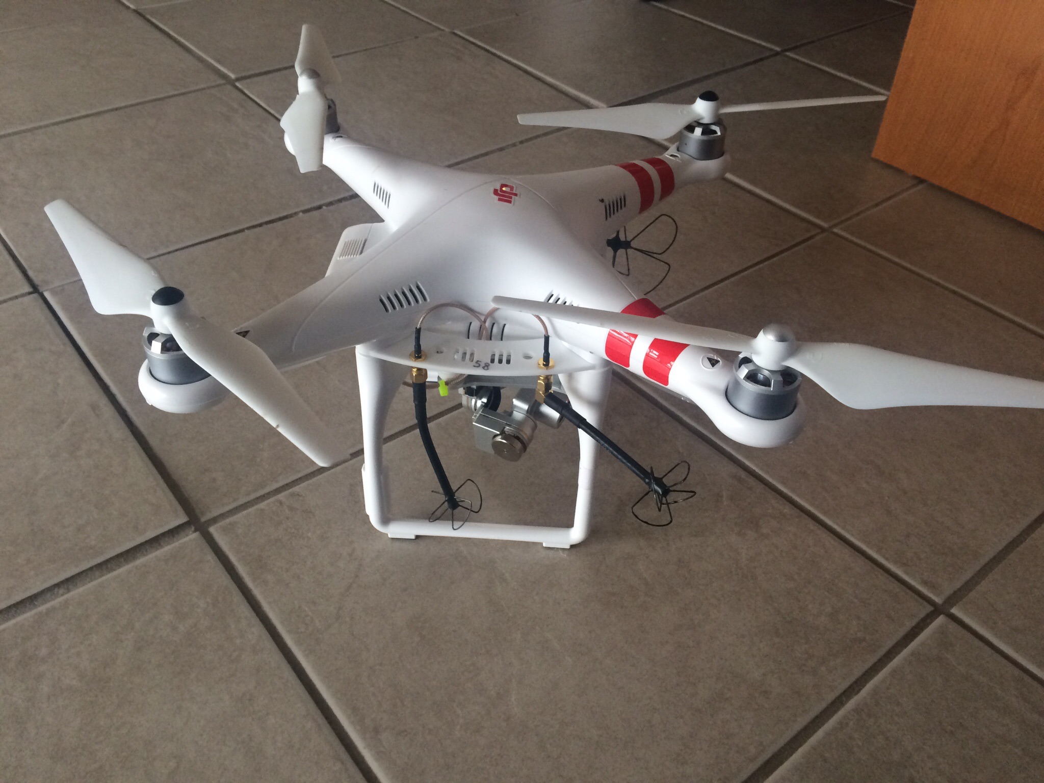

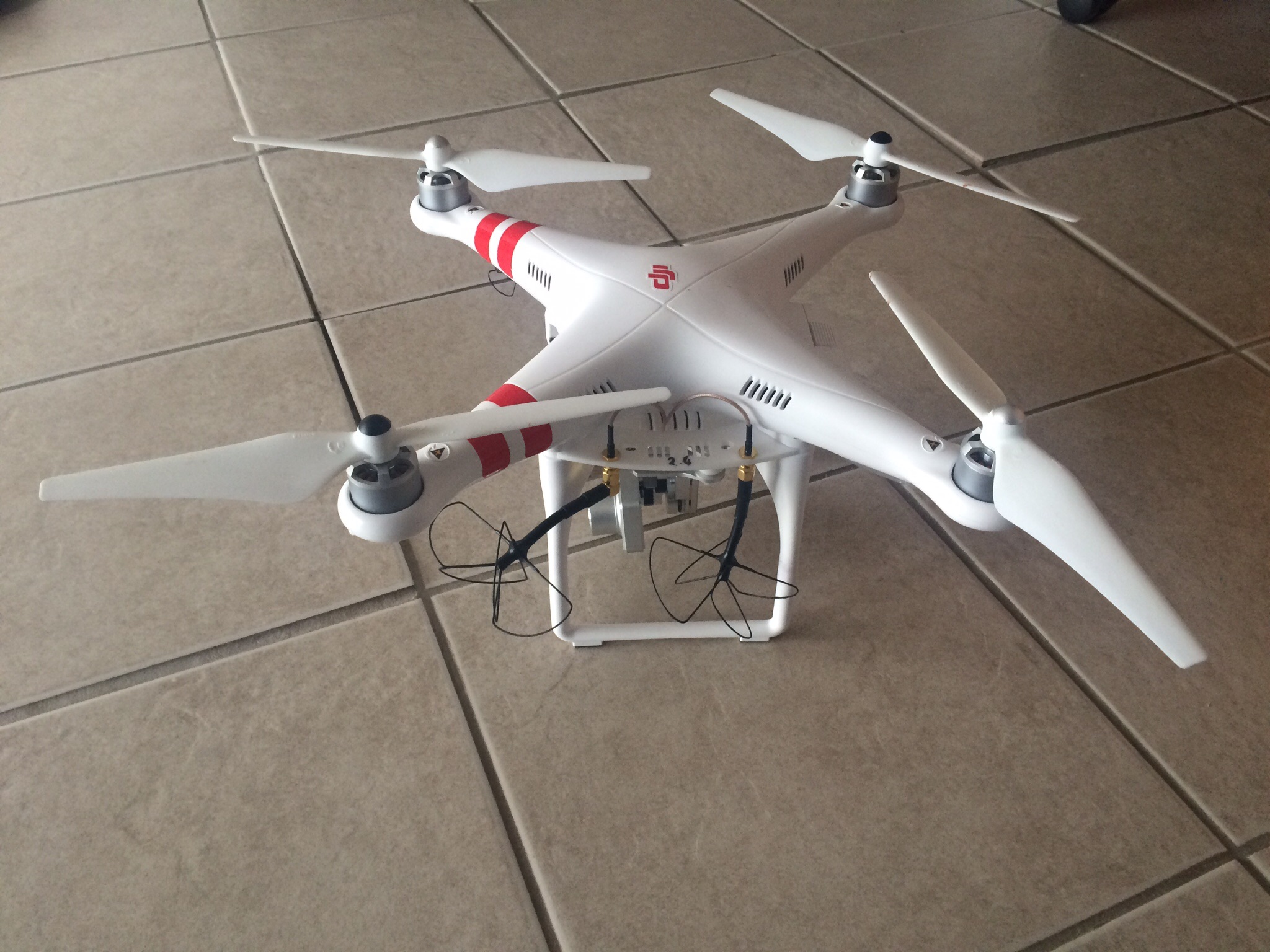

Flew with antennas only per FPVLR asking me to. I made it 1500 feet distance at 175ft. Before signal broke. Waiting to hear back now. Here's a pic of how I flew tonight. View attachment 17165

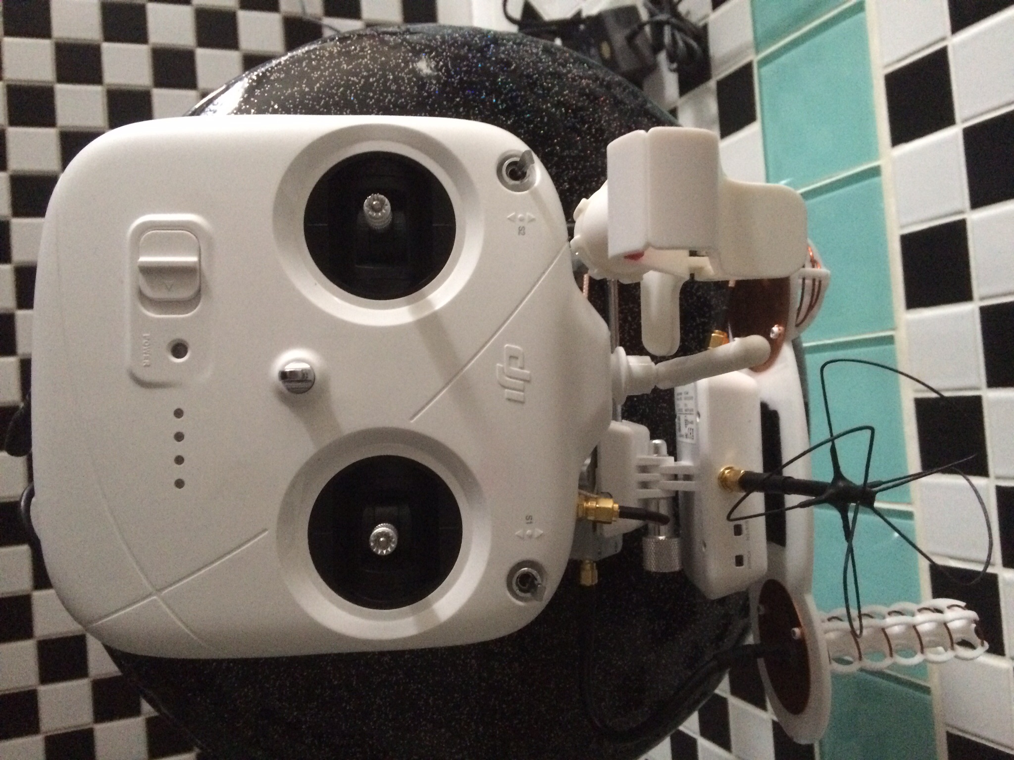

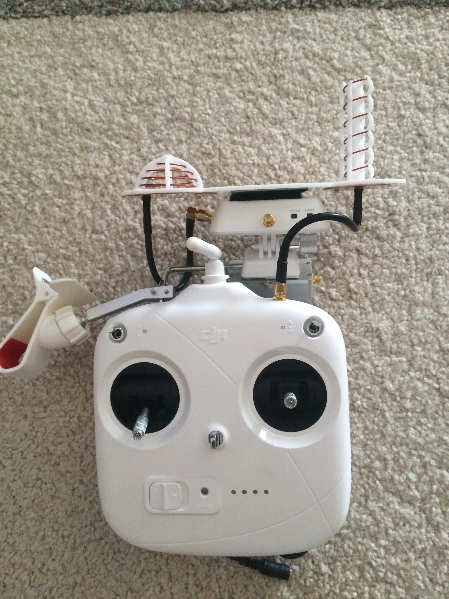

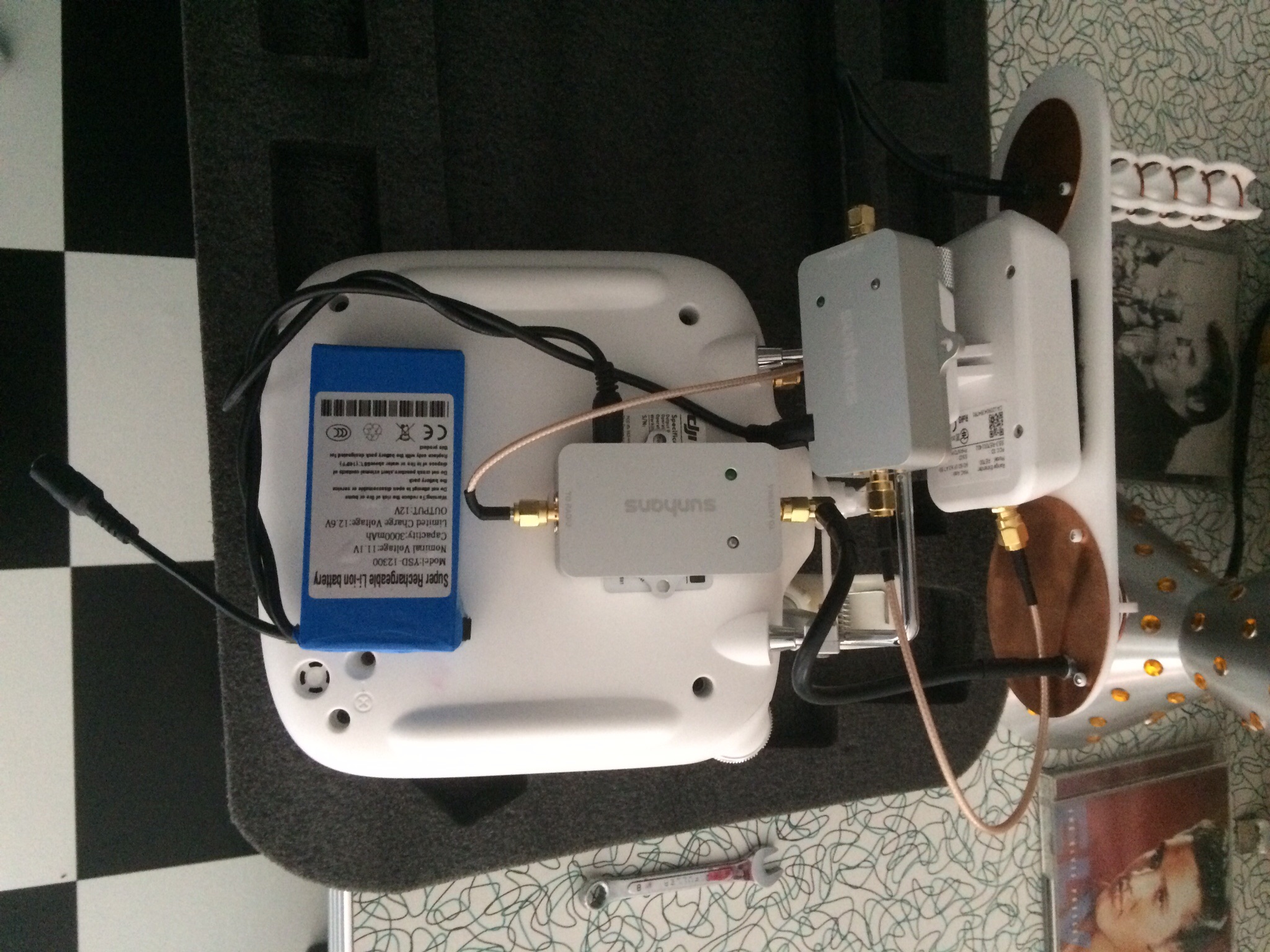

View attachment 17120 View attachment 17119 View attachment 17118 View attachment 17116 Received my installed Stage 4 FPVLR kit yesterday in the mail. Kept loosing connection and camera will not pan up and down anymore. At first I sent pics to Fpvlr asking for help. After saying my 2.4 and 5.8 antennas were installed on wrong side I switched them. But still no longer have any camera control. Any help would be appreciated
I may be new at this BUT I think you have them hooked up wrong. The semi-dome is the 2.4gHZ and the Helix is the 5.8gHZ. The pictures looks like you have hook up the Helix to the extender (2.4).
Reactions: Scoot-Scoot
Yea I see the same. Helix to one side of amp and other side to wifi.
I'm waiting to hear back from Tony. I sent him a email earlier telling him I had a good flight today and if that was a possibility. I don't have them still attached to my remote or I would double check.
Control side should be like this.

I'm happy to say today was a good flight using Tony's antennas, no amplifiers connected. And flew 3400 feet on one battery charge and 3550 feet on the 2nd battery pack. That was at 375 feet high. My next question is when my battery connector comes in from Tony, Do I need to have the 2.4GHz amplifier ran to certain antennas on my controller. And the 5.8GHz amplifier ran to another? Before when I received the kit and no instructions I ran the amps without knowing where they should go. And thought that might possibly help.
Yes 5.8 goes to the Helix and 2.4 goes to the little dome
Make sure the connectors are plugged in the right way around as well between controller, wifi, amps and antennas
