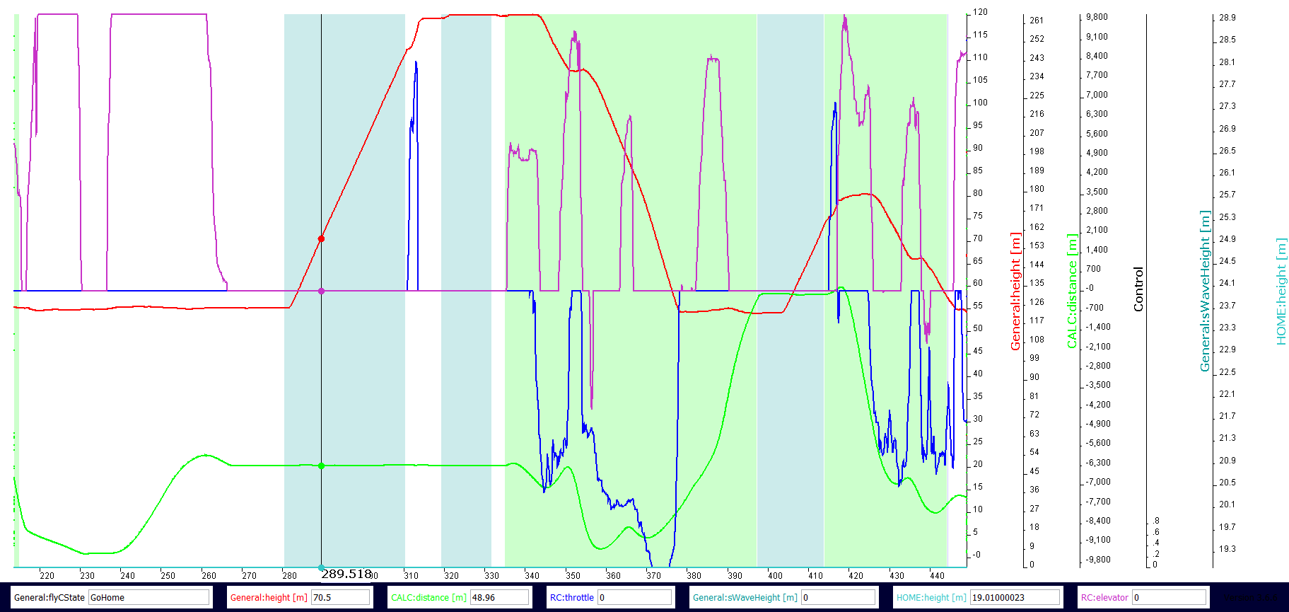

so I did flight... DJI Flight Log Viewer - PhantomHelp.com and I can confirm, when I disable obsticle avoidance it goes normal ~50kph speed forward. I also experience problems with RTH... I set my RTH alttitude to 40m but when I press RTH its start facing me and going up... to the limit at 120m and not going back... Maybe factory reset will do the trick with dji assistant? I think this started after I updated drone FW... I ibought it used and it was I think never updated...
Im reviewing my LOG and see that after I pressed RTH it gives: RTH: Backing up to avoid obstacle , looks like front sensors after calibrations are messy... I did calibration on my 15'' laptop, passed...

Did you also disable the downward sensors? According to this data set, you did. That said, with these disabled the aircraft should not climb as it appears to have done. Your RTH was set for 19 meters and you were already above that when you activated RTH. This may indicate an issue with the downward sensors. It is possible that they could be reporting erroneous data, although the data set here does not actually show that since they appear to have been disabled.
yeah, about that vertical sensors... its also little bit messy. Now I ave tem disabled. because when I enable them it shows me 0.0-0.1 values when Im up in the air and descending is very slow then... I did calibration with dji assistant hoping to fix it... But when I turning on P4 and just lifting it from ground, looks like VPS sensors showing good value, but up in te air is something not right... sensors looks clean... and I bought this P4 for 350 euros, it was crashed once, bottom shell cracked near one motor, but flies OK...

@scorpiopaulius I don't recall off the top of my head if the proper data is included, however, you could try retrieving the aircraft .dat file for a more in depth look as to what may be going on with the sensors. If you have never done that, see the link below and follow the instructions. You will need to upload that file to a share site such as dropbox..etc....then share a link back here to the file. The file you should look for is FLY258. Retrieve Aircraft .Dat Log
