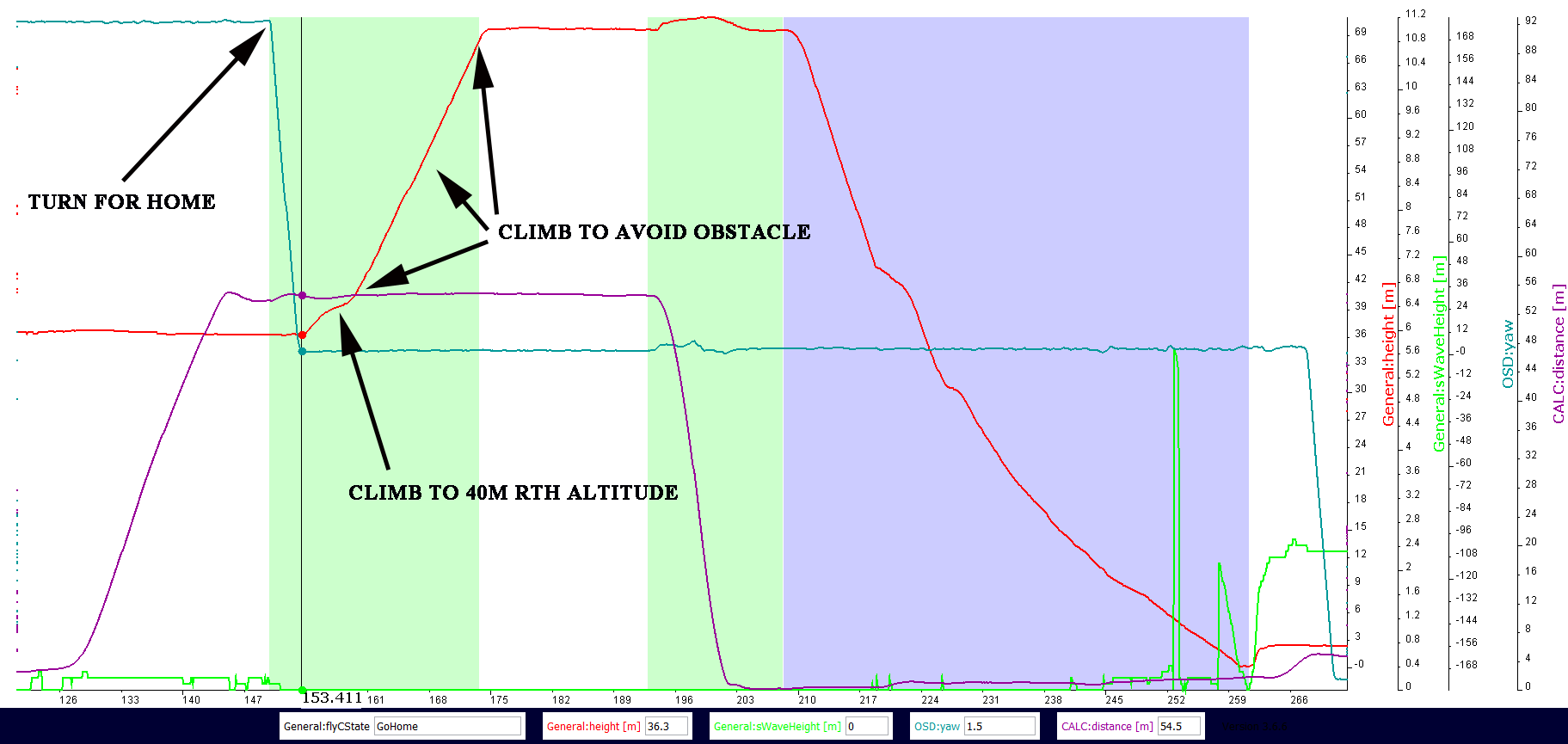

Ok, in this second flight did you notice this? After the aircraft began to ascend to RTH altitude, the OA detected something and tried to climb over the obstacle ( Which there were none ) with the only exception being the sun. It will confuse the sensors at times.

The graph below shows the aircraft turn to head for home, then began the climb to 40m. Right at the 40m mark is where the OA detected the obstacle and the climb began.

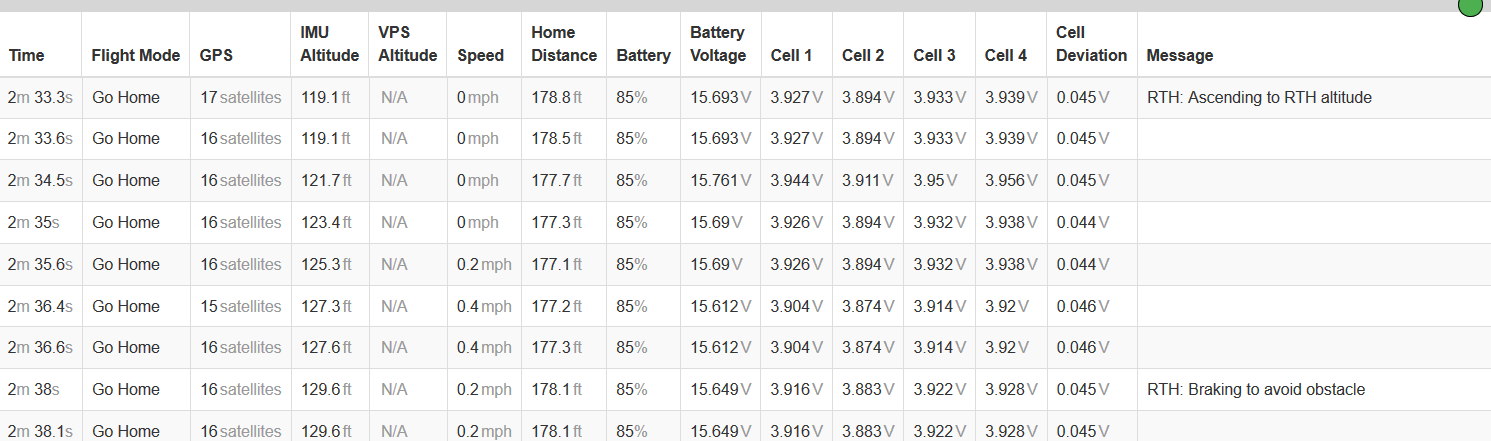

If that is the case then I do not see why the message appeared as shown in post #25. Unless you uploaded the wrong flight. That says the OA was working.

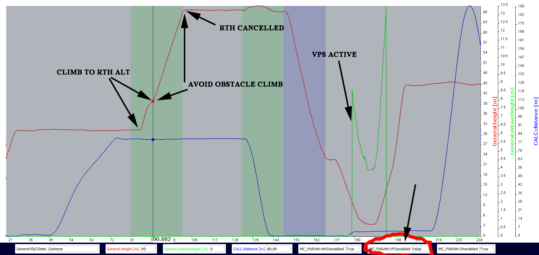

This flight as you mentioned shows the exact same as the previous flights. Immediately after reaching RTH altitude, OA is triggered and the aircraft climbs. The odd thing here is that it looks like you had the VPS turned off for the flight BUT it is still reporting data. This one is very odd. @BudWalker . Any idea's on this?

That was my point. The VPSenabled flag was false, which should mean the VPS is off. But it was still reporting. It does sound like a hardware issue of some sort.

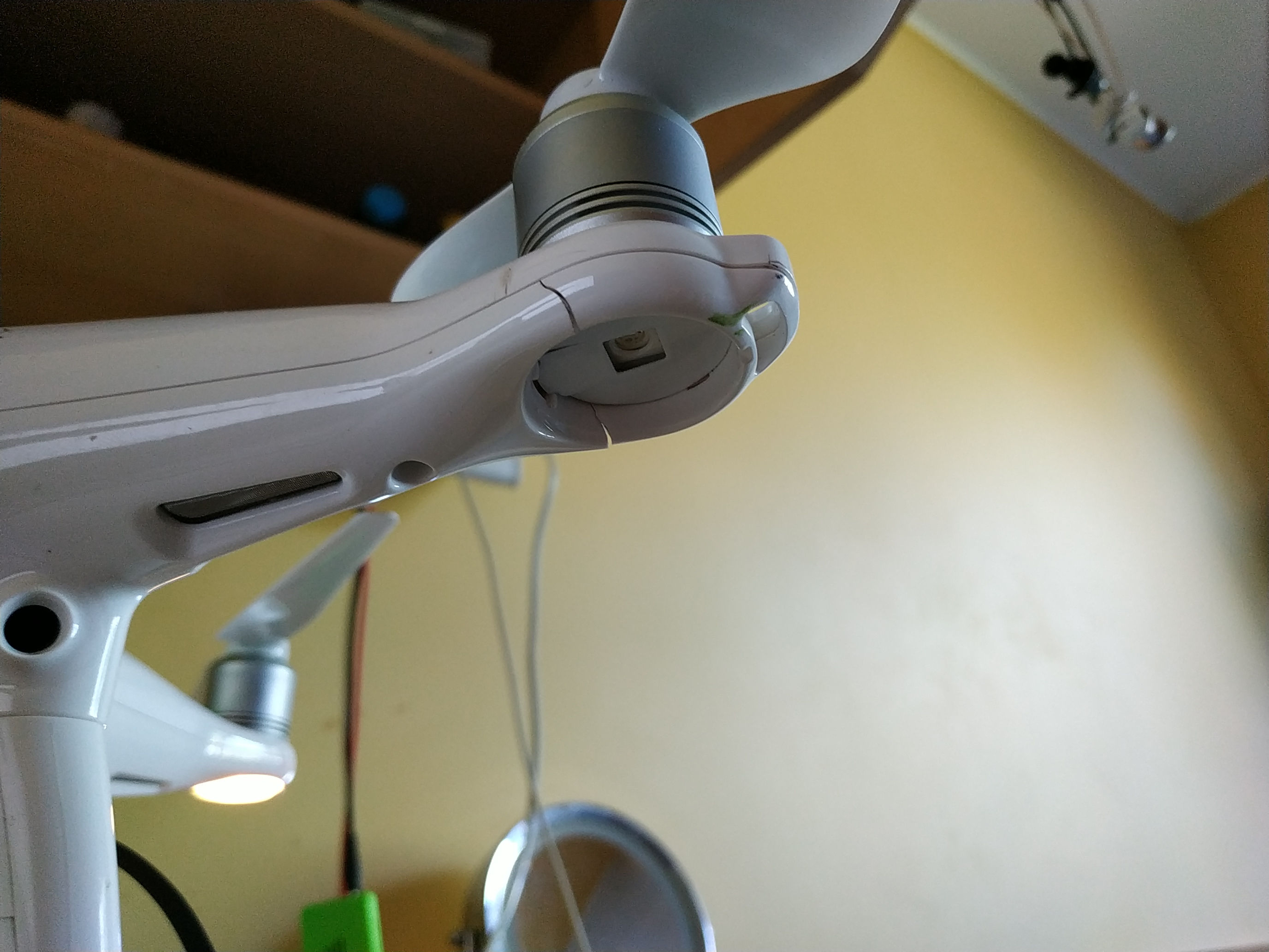

Maybe its because it was crashed... maybe. I dont know how was the crash. If it was big or not, but one motor plastics has big cracks. I plan to glue it with epoxy. Everything else looks ok... Also gimbal sometimes acting not very nice. It does not finish calibration, starts twitching in one side... I will make video later. Maybe some wire connections got loose. Im going to take it apart, maybe look at YAW motor for sensor if its not damaged.
