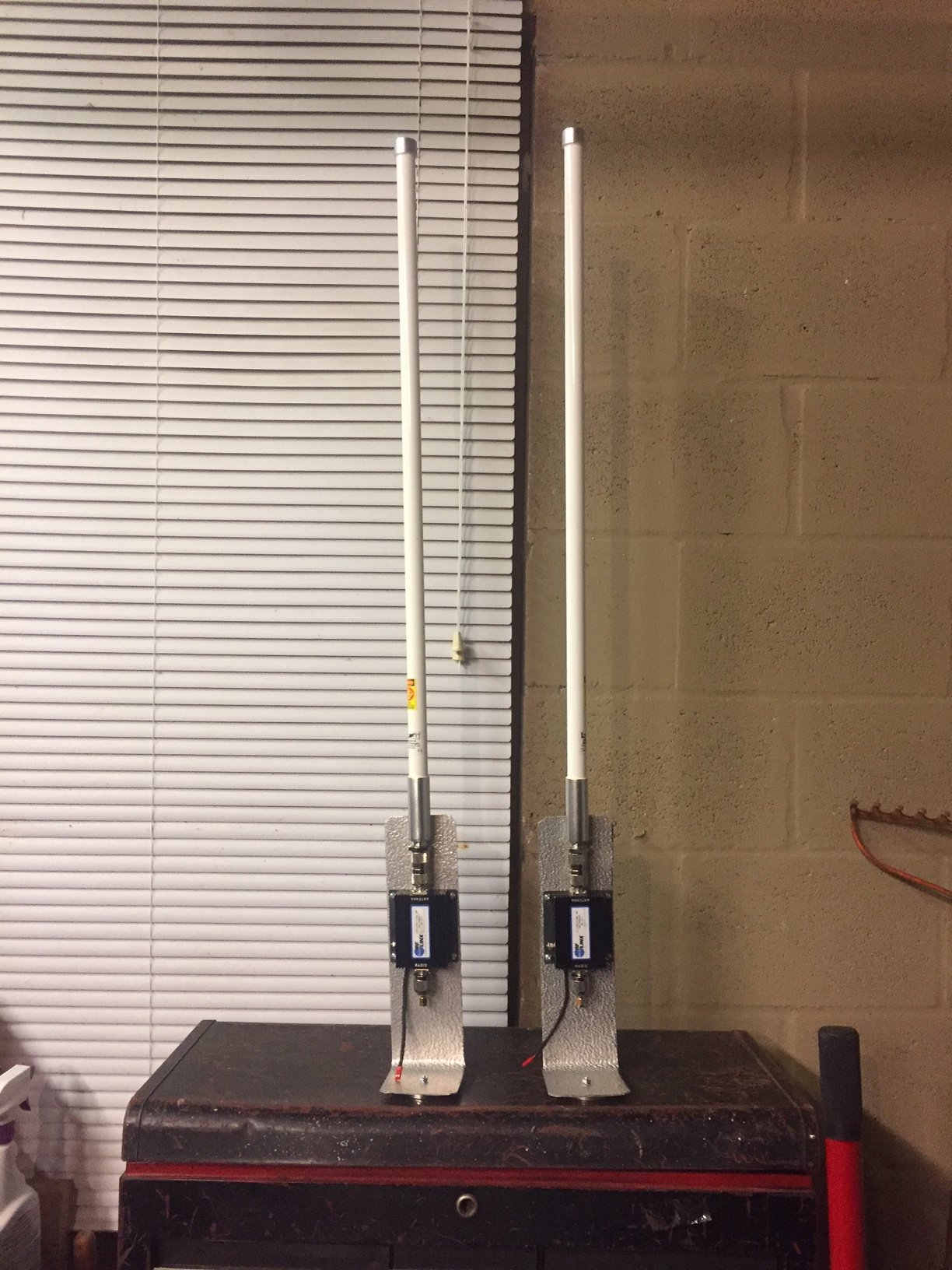

These L coms were bigger and heavier than I anticipated. Ordered 100lb holding 3" round magnets needed to support aluminum bracket, amp and antennae. N male / N male connector for antennae to amp, RPSMA to N male to connect amp to cable routed into truck. External power hack completed for amps. Power supply will be 110v to 12vdc 6amp with noise filter plugged into car inverter and routed to amps, plugged into pigtail with JR connector. Easy disconnect and relocate for all components, LMR 400 cables will stay with vehicle. View attachment 75162

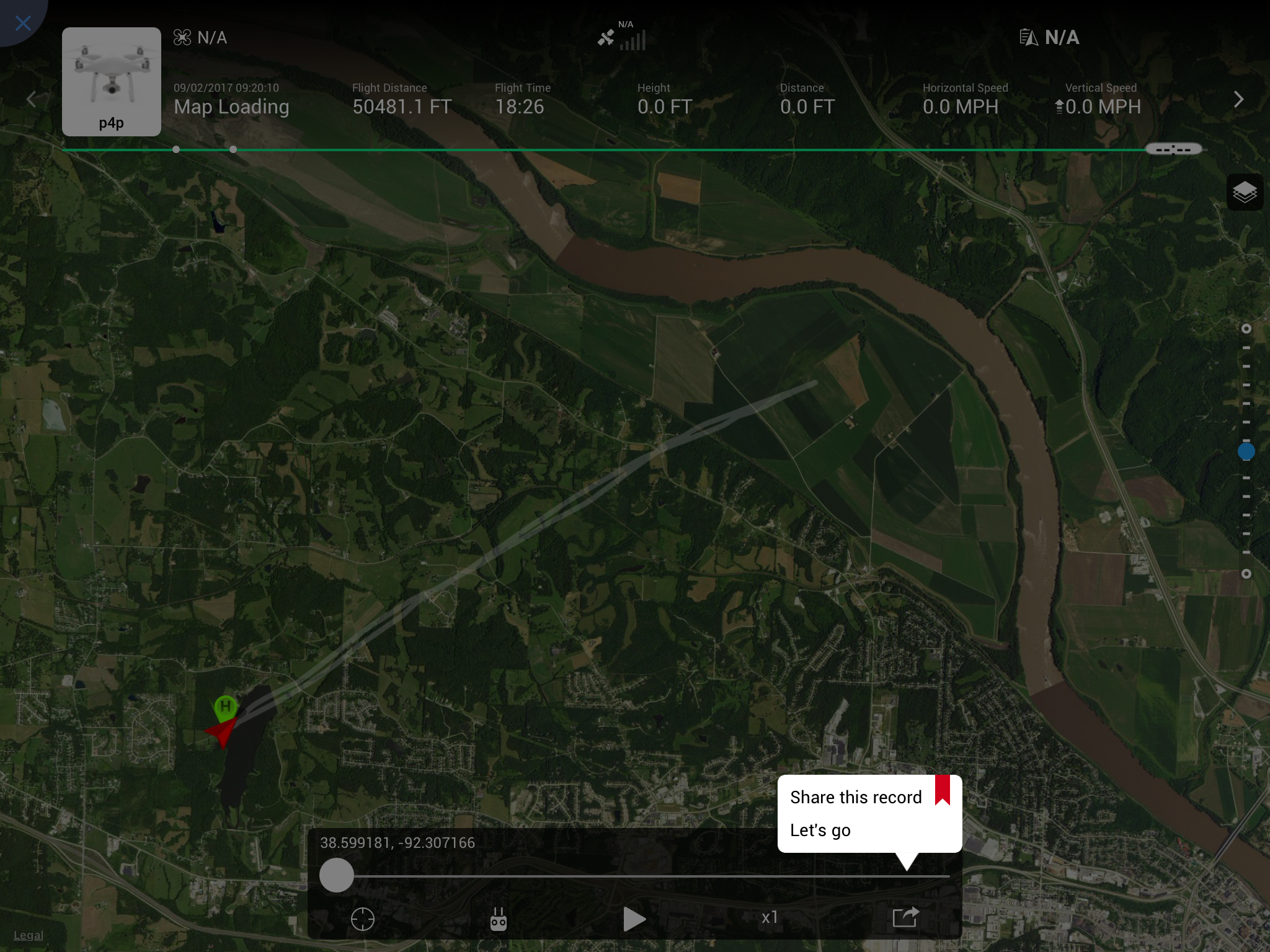

Little testing with the l-coms and p4p set to channel 21 on 2.4ghz. Landed at 7 percent. Managed to stay under 250ft till about 20,000ft. Do you guys still plan to upgrade the stock 195 out of the magnetic base? Heck even my inspire 2 can hardly make a run like that. Obviously it can but not by much more.View attachment 75771

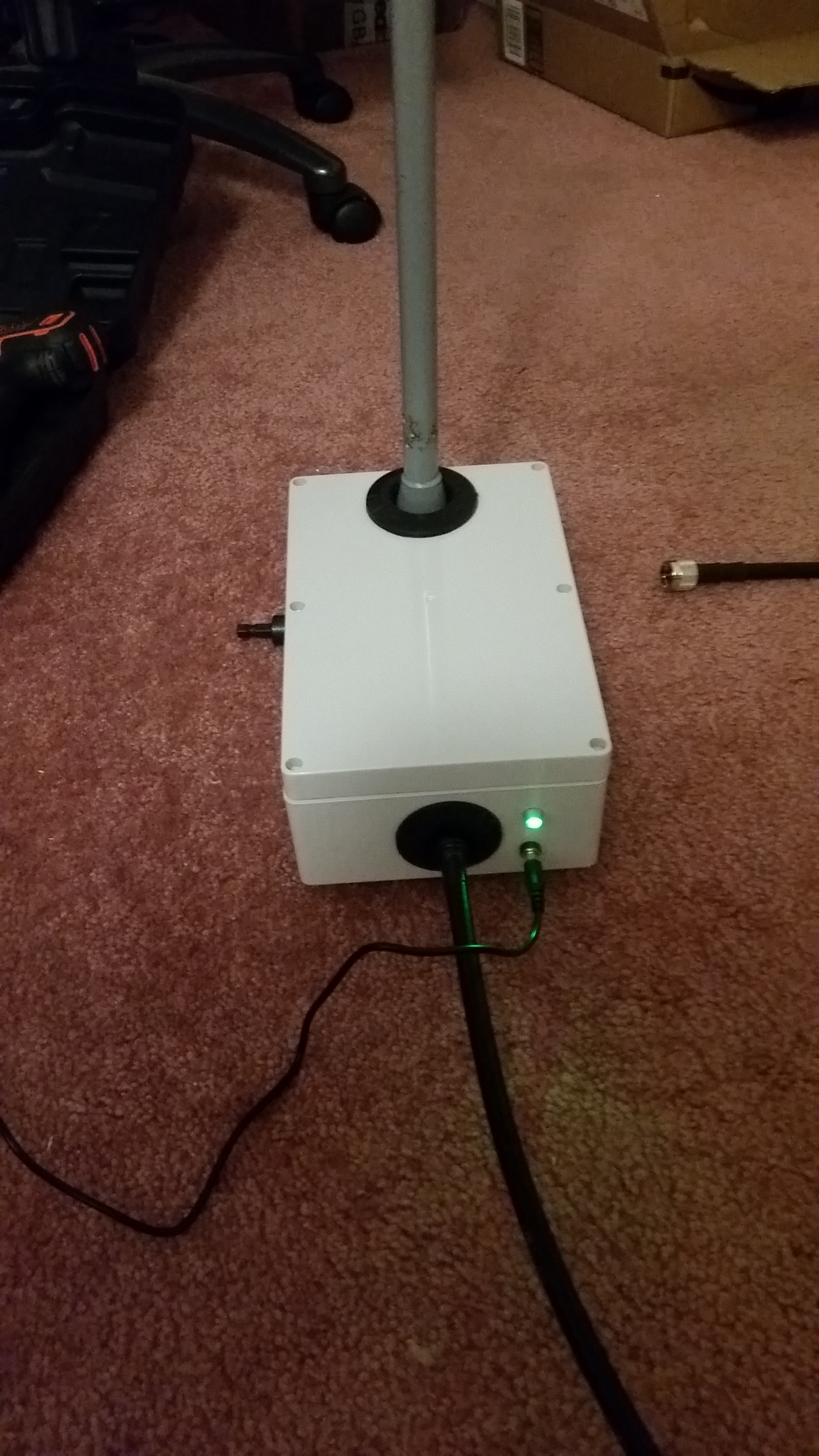

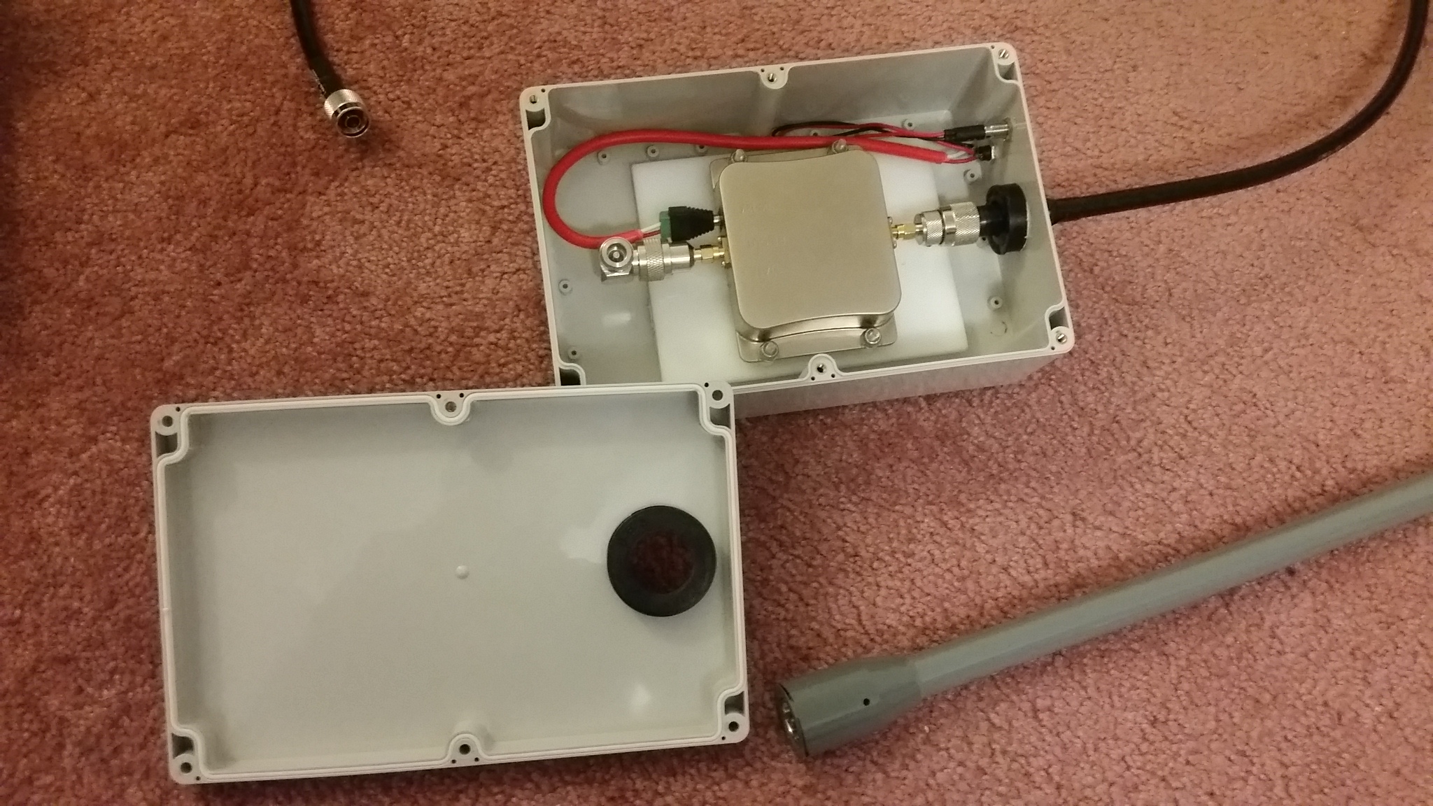

I gave up on modding coax in the bases. I just ordered a project enclosure and attached the magnets to them. Using 3-M hook/loop fastener tape I can switch out any amp in the box. The coax used is the mighty LMR-400. (Still waiting on decent weather to test).

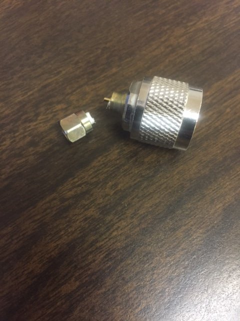

Well a bad "n male to rpsma male adapter" got me this weekend with the inspire 1 test. Only got out to 7000' in optimal conditions before signal lost. Checking the connector I found the problem. Same distance with the P3A.......Beware the quality of connections........View attachment 76236
Same thing happened to me. I bought Uniseals to reinforce areas around the adapters.

Adding the rubber grommet/seals to the enclosure supports the L-com antenna with rigidness to keep them safe from snapping the N to SMA adapters. The smaller seal does the same for the input cable. You would need to wrap black electrical tape to the cable until it's diameter meets the I.D. of the seal.
Nice work !! Looks awesome and like you posted, will support your adapters..
Great work! However, I'm happy to have saved a whole lotta extra work by using N-male antennas on N-female amps and N-female injectors.
