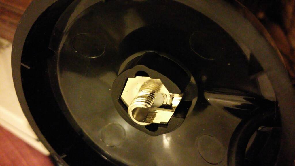

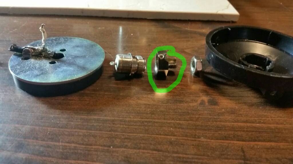

I being unhappy with my L-Com's factory coax (R-195) decided to "Modify" the base mount connector. I will install N connections so I can lash LMR-400 from amp to antenna. If you've ever wondered what's inside a L-Com mag mount take a look. Currently I already have bulkhead N union, but would need to add a 90 degree N adapter to mate/mount to base. The proper way would be to get 90 degree bulkhead N male to male union. (Can't find one)

Thanks for sharing. I have been wondering how to safely take off the connector without damaging/drilling it off to bits. How did you get yours out? I tried pushing it out from inside ...no luck.

Center lead soldered to N connecter. Braid/clamped to magnet plate

I didn't disassemble with the thought of putting it back together as stock. It looks like: remove bottom nut. Desolder center lead. Un-crimp cable retainer tabs. Loosen hex set screw (see pic). Un screw top N connector piece from bottom N connector bulkhead base.

I didn't disassemble with the thought of putting it back together as stock. It looks like: remove bottom nut. Desolder center lead. Un-crimp cable retainer tabs. Loosen hex set screw (see pic). Un screw top N connector piece from bottom N connector bulkhead base.....
Totally missed the hex screw!!. Thank you.
