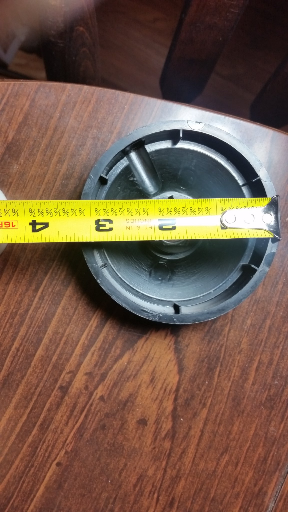

So, it appears L-Com has different setups for the mag mounts. Mine has no hex nut...:)
All I had to do was unscrew the female N connector (from the top).
Sent from my SM-N910T using Tapatalk
I believe instead of tearing apart the original base, a new build with a PVC reducer and caps will be the route I go.
